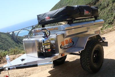

I can see where you drew some inspiration from on the design...
IIRC the inspiration came from @spressomon wants/needs and a hybrid wide body RockBox/M101 trailer. He sent me a few links on the RockBox, pics and what he didn't want after having one of the taller top heavy trailers like the Burley and a few others out there flip on him while on a pretty mild trail. He went wide and low. 47" leaf springs vs. 26" jack hammer trailer springs make the ride on and off road incredibly smooth and allow for greater flex as well.
Moving forward there will be some visual and storage design enhancements with the production trailer.
