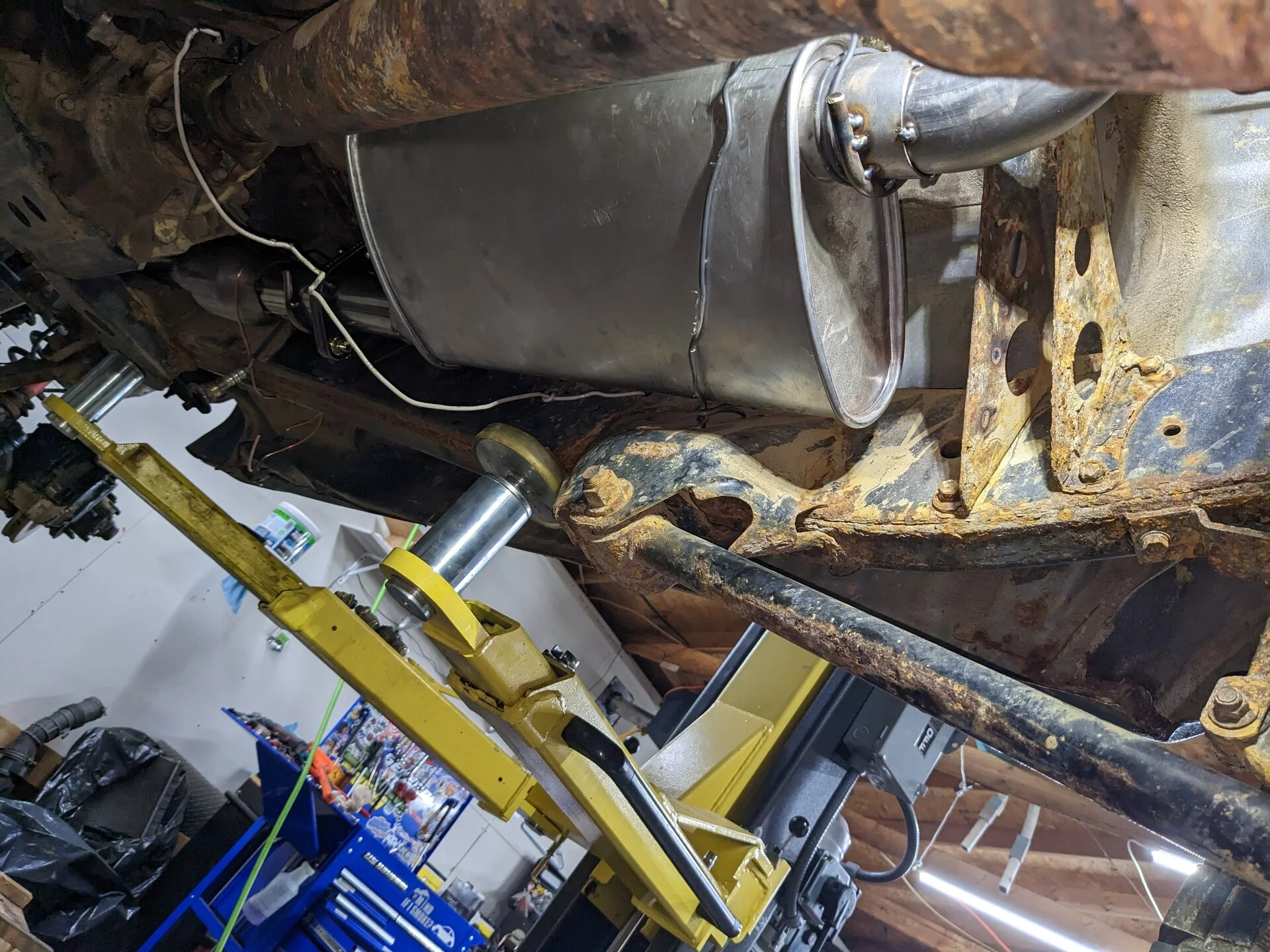

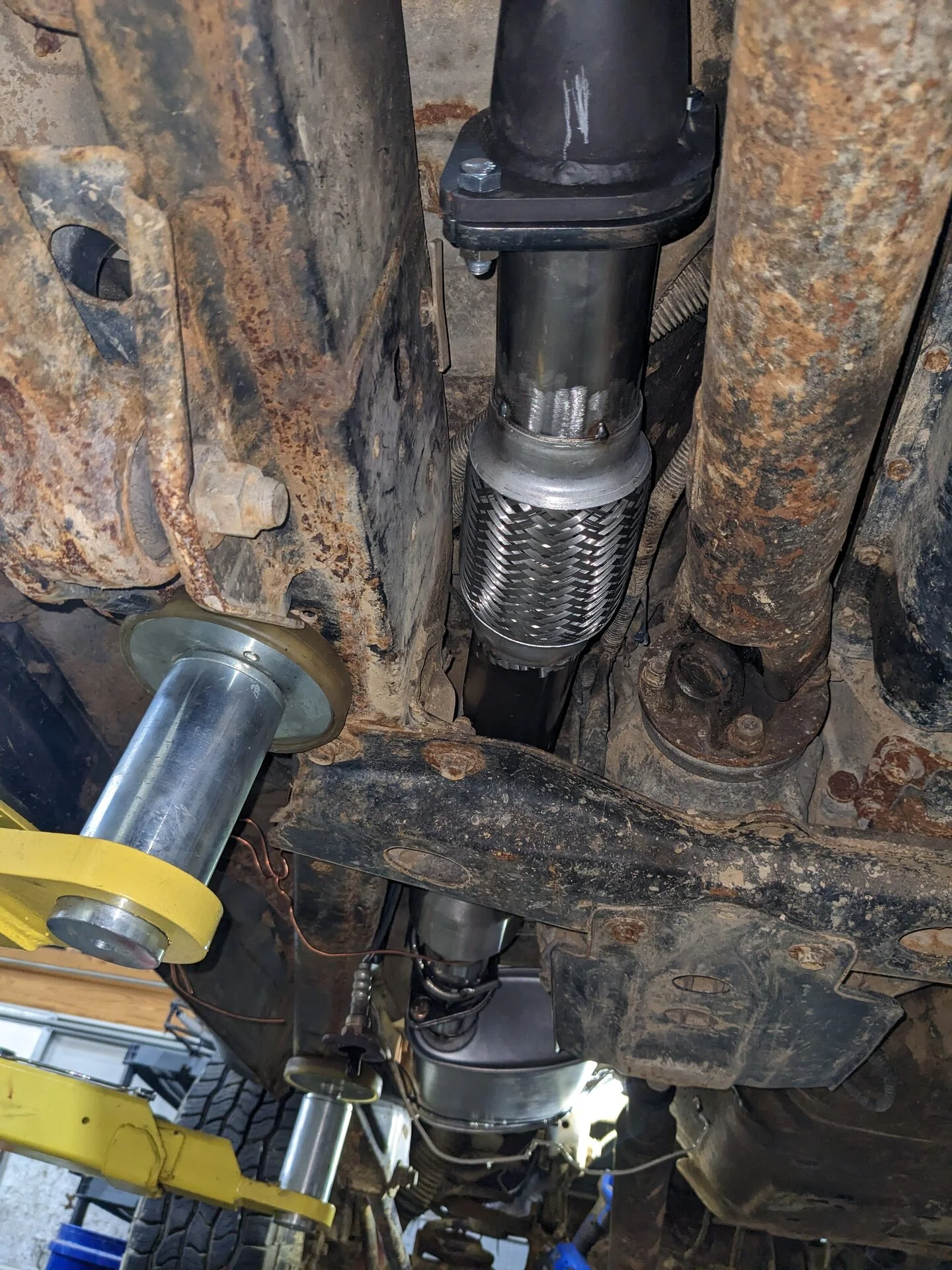

I always hated how the factory exhaust placed the cats outside the frame and looped under. For such a beast of an offroad machine it always felt like a dumb oversight that I wanted to change. After smashing my cat on my last wheeling trip, I decided I needed to reroute the exhaust this time around (and install sliders).

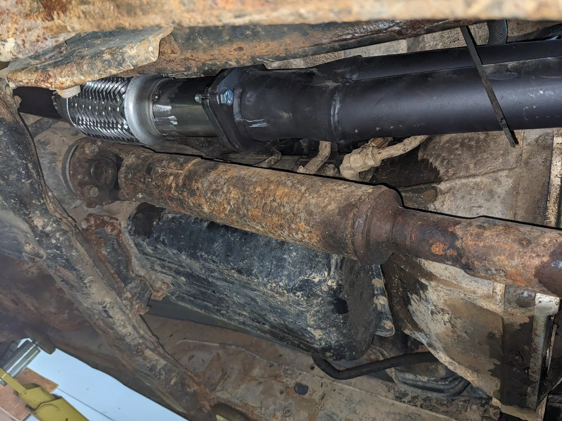

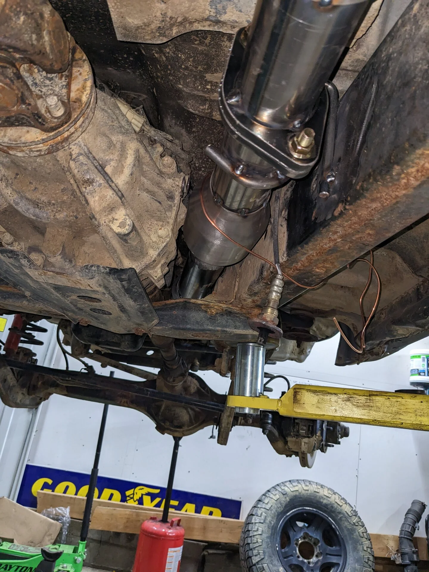

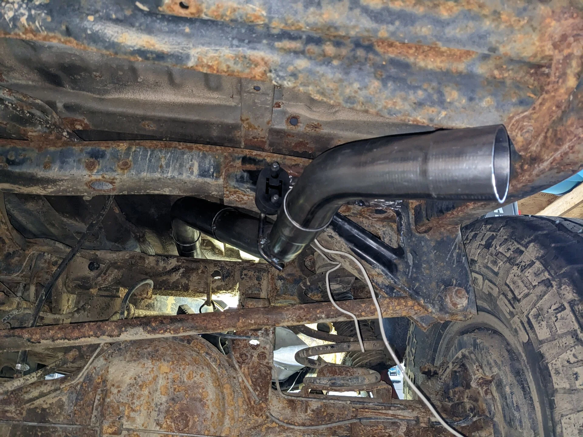

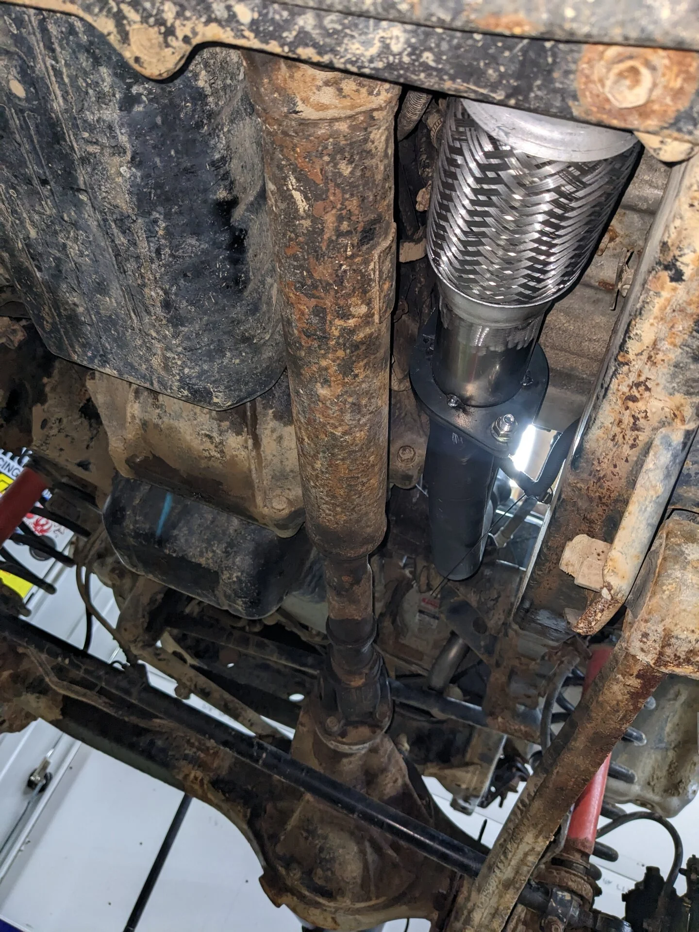

I found a set of APS headers on eBay (from Australia) meant for a 105 series that routed exhaust inside the frame. I bought a Flowmaster high flow catalytic converter, a Summit Racing turbo muffler, a short flex pipe, and a kit of mandrel bent 2.5" tubing and set to work fabricating a custom exhaust. This was my first ever attempt at custom exhaust work beyond making a test pipe to delete my second converter. It was a tight squeeze around the transfer case, and I'll probably end up having to delete the rear heater, but it fits and is much safer
I have everything tacked together and hangers placed. Now its time to pull it all out, finish weld, and paint the exhaust before final installation. I'm hoping for a low mellow sound that has some roar at WOT, but hoping it is relatively quiet at idle and cruise.
And yes, I plan to address all the surface rust. I tend to be lazy about cleaning mud off after wheeling and kick myself when I end up with surface rust to clean up.
I suspect Mr Ts engineers ran it out side the frame for a reason like to keep heat away from the transmission & transfer case ;)
Also looks like you have some wires that are dangerously close.
The 93-94 models go over the frame not sure why they changed that !
I still have to finish rerouting wires and will heat protect them. I agree heat was probably part of the consideration, but that was also using catalytic converter tech from 25 years ago too. The 105 uses the same running gear but routes inside the frame, so I don't think the heat was as big of a problem as packaging 2 massive suitcase cats.
I do plan on doing a few things to mitigate heat issues as well. I was hoping to have room for a heat shield around the cat but will have to make due with something else since I won't have room. I'll change T-Case fluid and trans fluid once a year just as an extra precaution

I thought about something like that but I was going to need new exhaust regardless because of how many points had been damaged. Picking up a fairly significant increase in flow too with fewer bends, larger tubing, and freer flowing cat and muffler.
