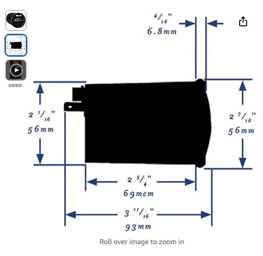

Does anyone have measurements of the internals of this? I'm interested in putting in my own LCD screen, and adding sensors for altitude, pitch/roll and a few other things, and would like to house all of those electronics in this console.
Yeah, it would be easier to buy a complete unit like the Amazon one, but I have plans for a custom UI that will be 80 themed :D
You are looking at a triangle of space. There is about 4.5" at the base and it is about 2.5" tall, and is about 8.5" wide Thanks!
What size 8 switch Auxbeam is being used? Looks like there are two different ones?
The model that I am using is the AR-800, I'm sure it will work with any model that is the same shape.

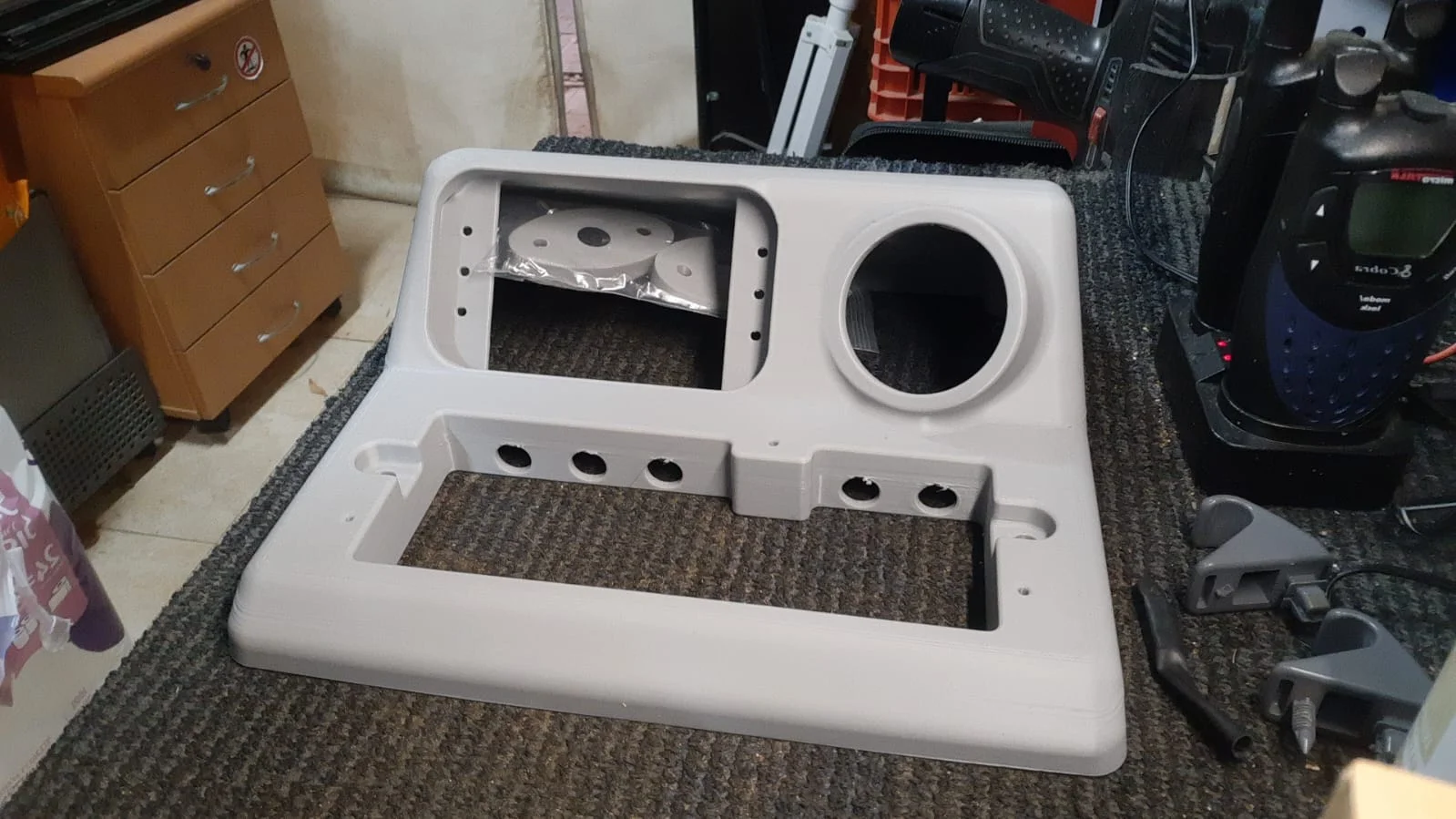

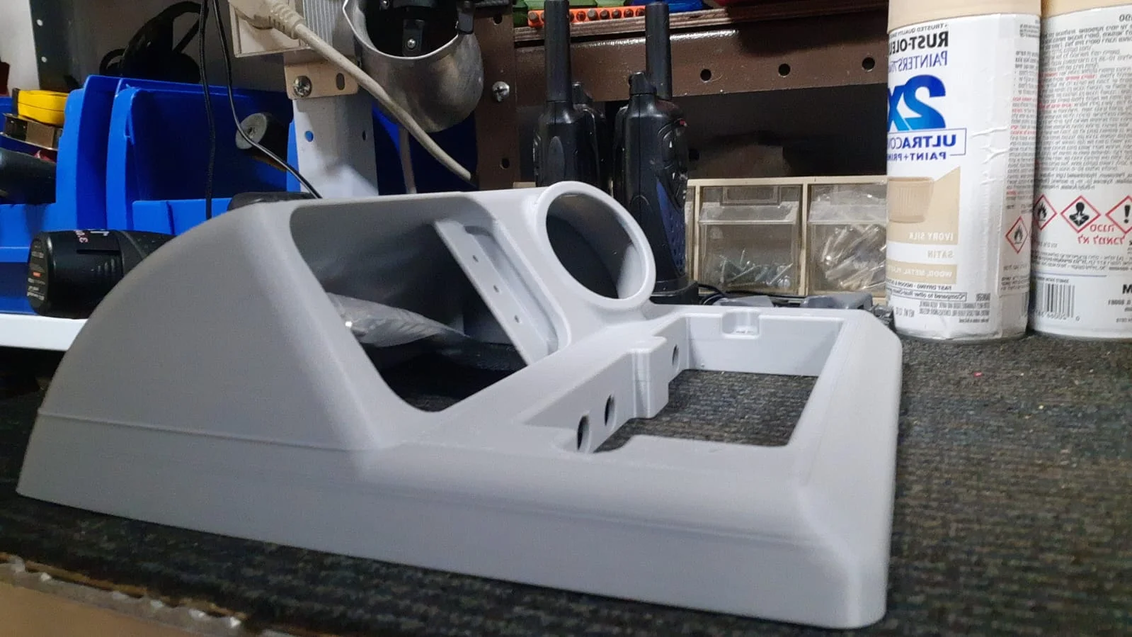

Once again @Ballsie creates a beautiful console.
Thanks, mate.
