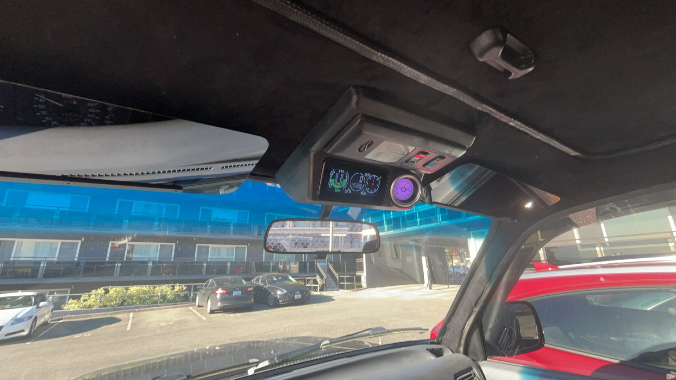

If I was to run the Amazon inclinometer, couldn't I just tap into the power that's already up there in the stock map light area? I don't want a gauge or any additional things up there. Just the one pictured here.
It looks like it just has a 12v lead.

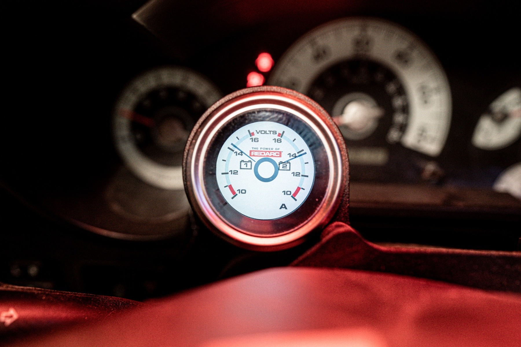

Thanks man, the round gauge is this one here:
I tried finding a spot to tap in overhead but with no luck so I ran the + down the A pillar and tapped into the cig lighter + wire under the dash so the screen comes on when I turn the car on. I did butt splice the - wire to the - coming out of the old sun visor mirror light though as I got new visors that don’t use any power. I also used an inline fuse with a 3A fuse in it on the + wire of the inclinometer because the inclinometer comes with a cigarette lighter power source that has a 3A fuse inside of it, I figured better safe than sorry
This looks great. What is the round gauge?
Did you just tap into the existing 12v power in the existing lamp housing to run the amazon unit or did you need to run wires up there?
Awesome and thank you for the info!
Yes, You can tap into the switched power in the sunroof harness. You don't want to tap into the lights because they are not switched.

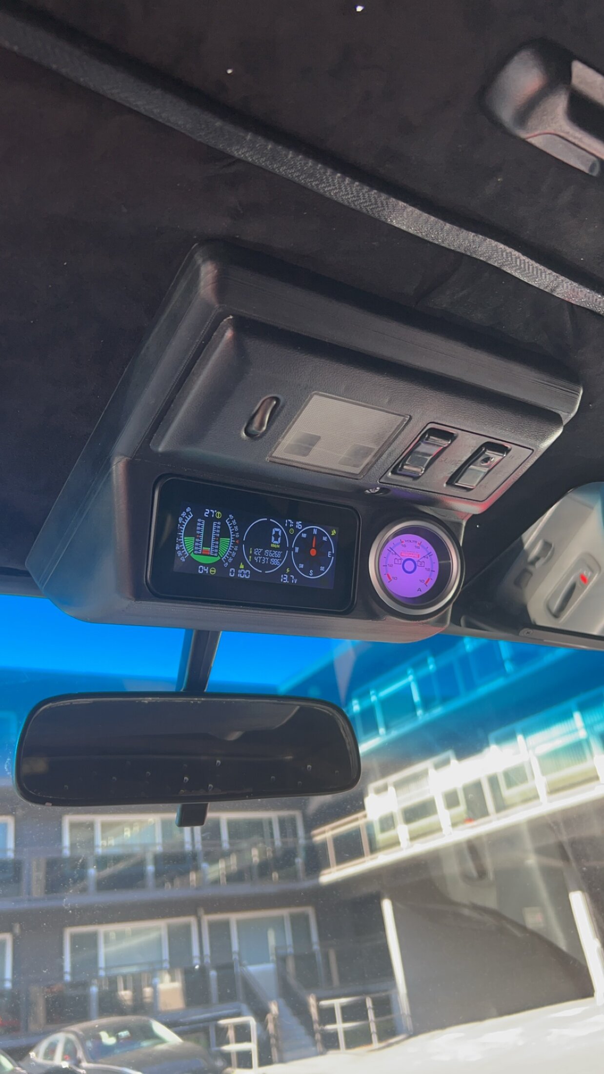

This one has a hole for a 2” gauge along with a little display I found on Amazon. It has a clinometer, GPS speedo (KPH/MPH), GPS altimeter (feet/meters), GPS coordinates, voltage, compass, and clock. It retails for about $50 on Amazon. I have used it for a few months and it seems to work well.
Amazon product ASIN B08ZHDKQ6GView attachment 3251386

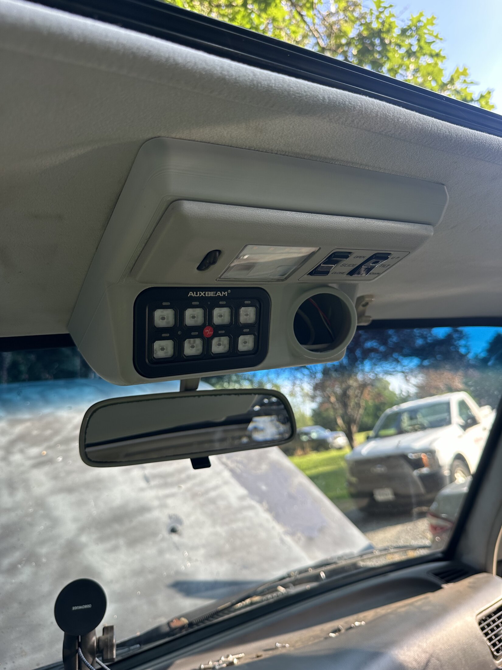

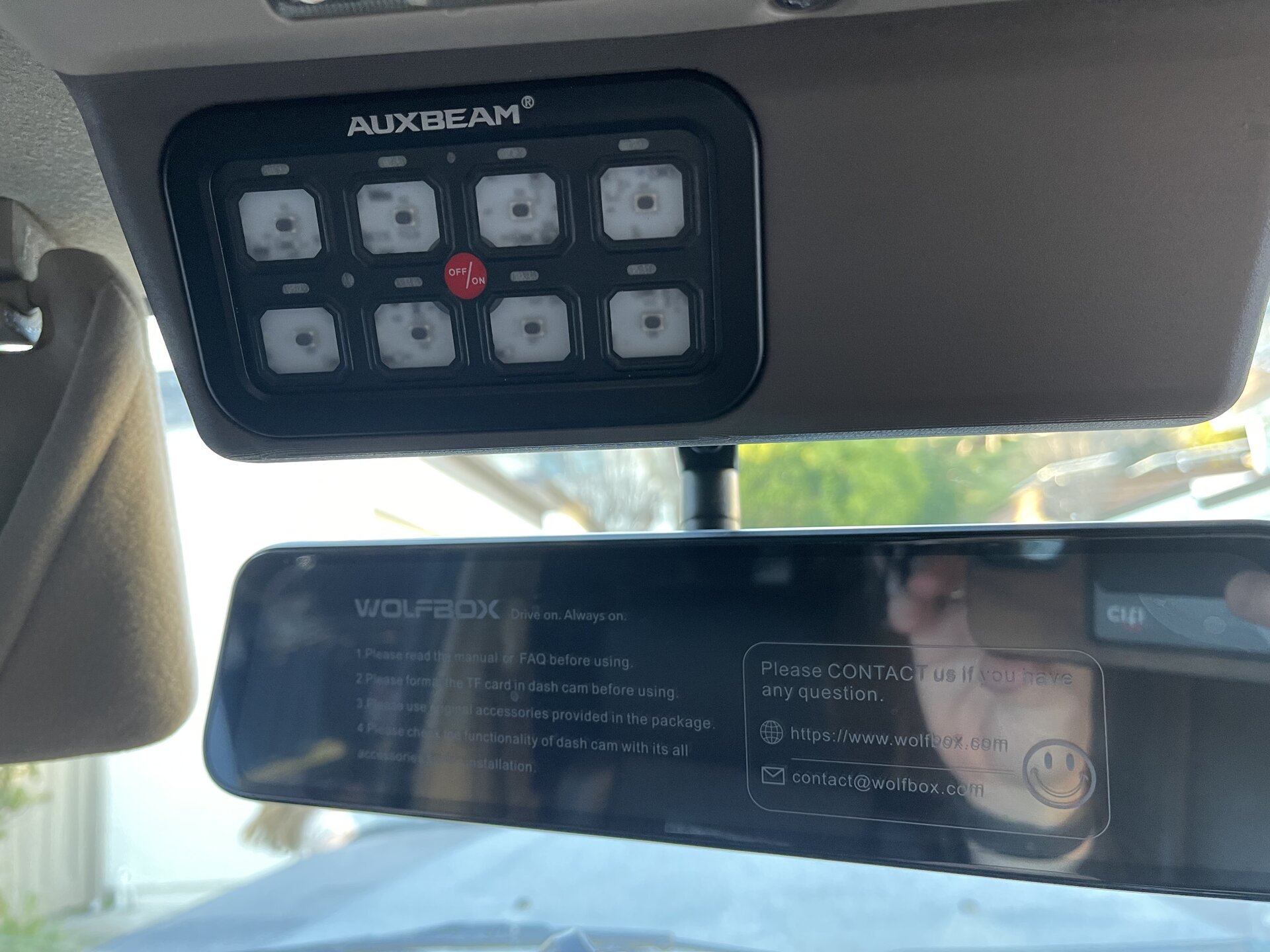

This one is for a 2” gauge and an 8 port Auxbeam switch panel.

Finally got around to installing the overhead console and it is awesome looking. Wanted to post a couple install pointers for 94 and older cruisers with the cloth headliner since most the pics are from 95+.
When attaching with the factory two screws there was a gap along the windshield. Bought 2 - M6x100 screws and installed them first at the windshield. Shorter screws can be used but does have to be a M6x45 or longer. Those two forward screws pulled the console nice and tight to the headliner and I didn’t feel the need to add the factory two screws back in. Factory screws holes didn’t quite line up either after tightening front holes, but enlarging them would have worked just fine.
Working on trimming the stock visors but they are turning out well too. Overall I’m very pleased with how it’s turning out besides the finger prints on my headliner 🙂
Console with just factory screws.
Console with just windshield side screws.
Full install with fingerprints minus 2” gauge.
