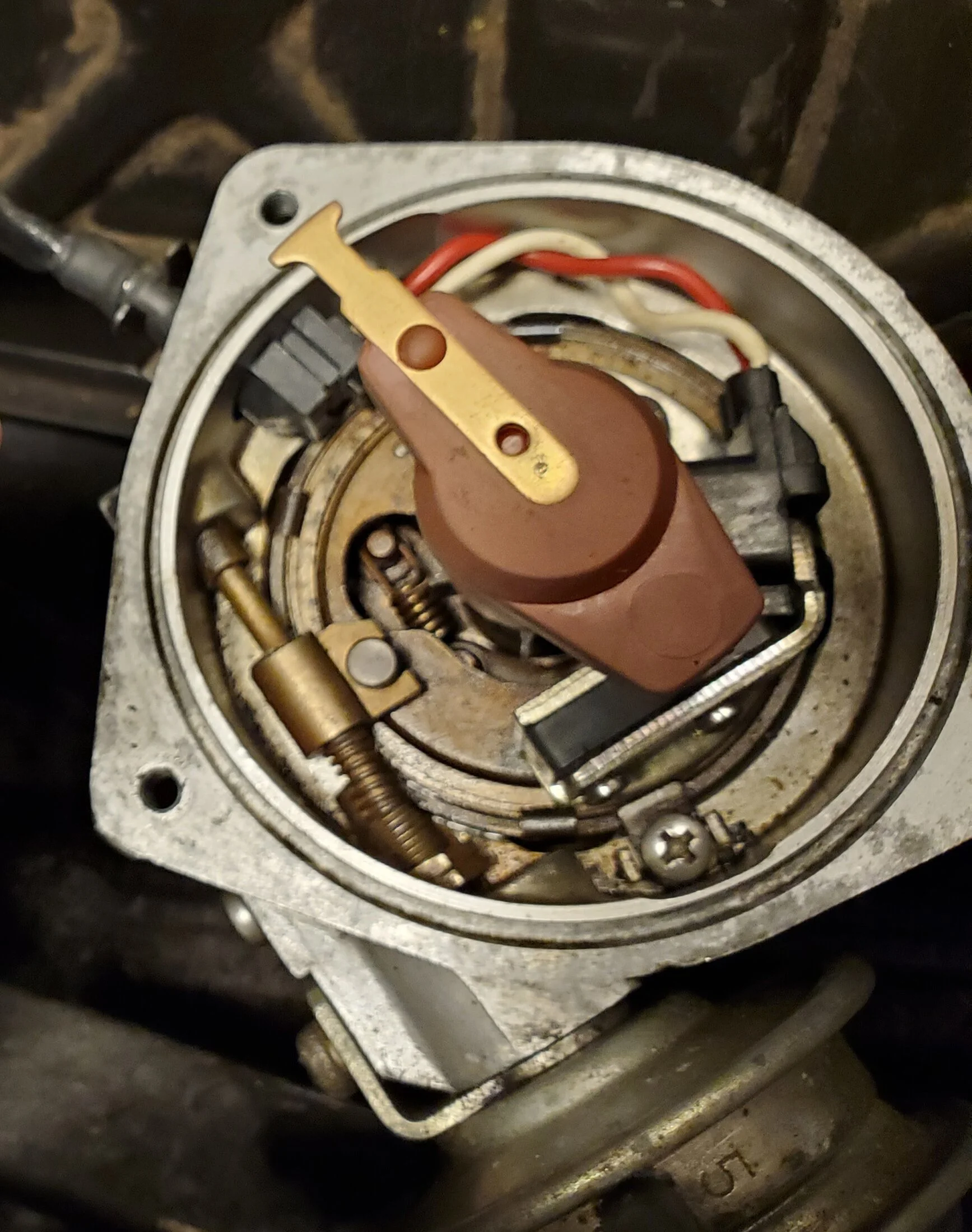

I repaired (carbon trace) and cleaned up the oem distributor to get all cylinders firing again. And went back to my factory static timing mark, advancing the distributor about 10 degrees from my dynamic timing setting.

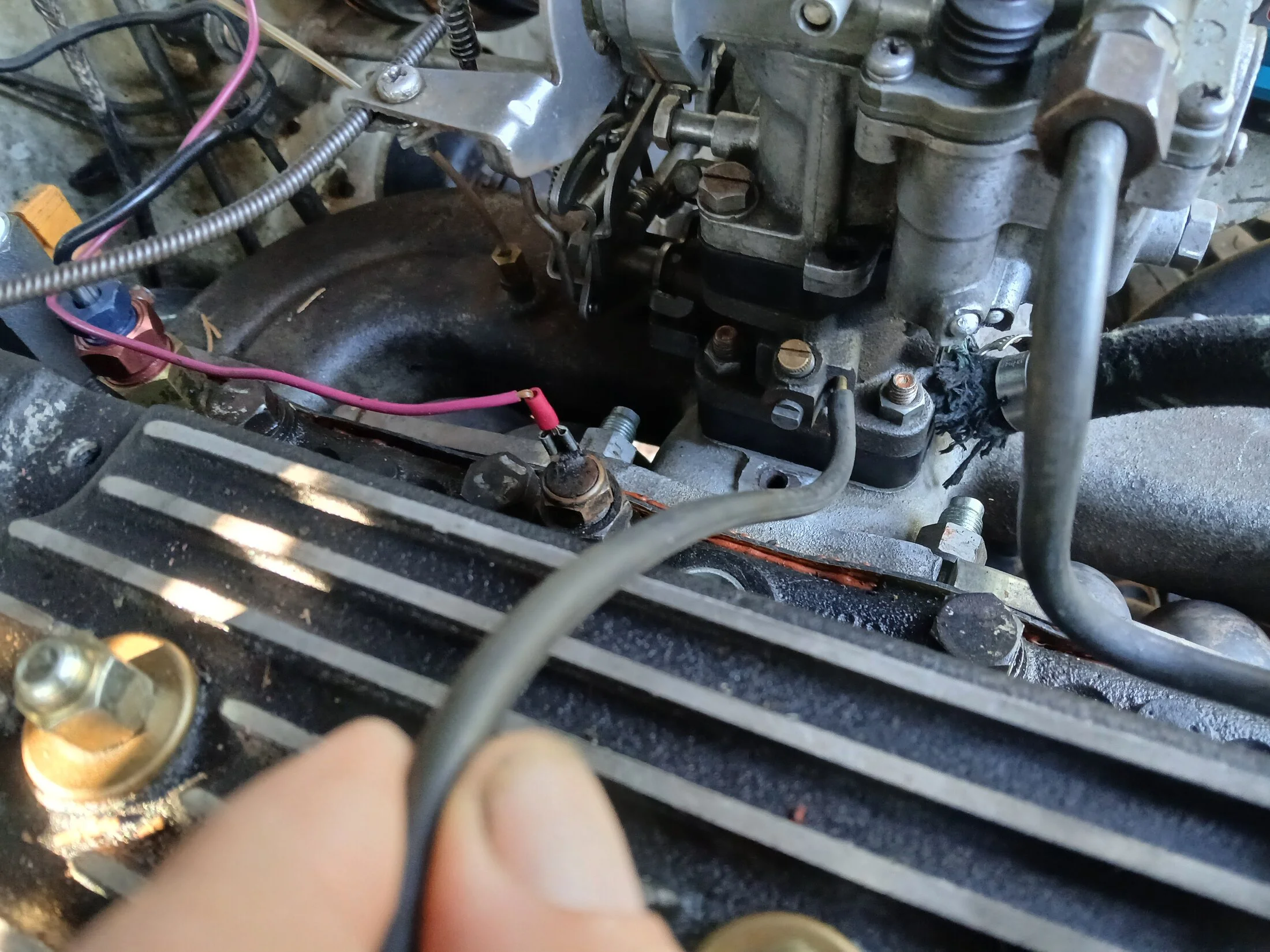

(1) When connecting my OEM distributor vacuum line, none of the above is possible. When I add the ported vacuum line from my City Racer Fuji carb to my oem distributor's large diaphragm, it runs very rough with some backfiring. It's almost as if the vacuum line is retarding the timing?

It would seem those two odd symptoms would point to something wrong with the distributor. It was frozen (centrifugal and vacuum advance) when I acquired it, but it was working very smoothly, with both advance types functional after I finished cleaning it up. Fyi, I use the larger diaphragm for my ported vacuum.

(1) I do not understand that at all. Are you getting ported vacuum from the same spot I am? (base of carb, valve cover side, next to the mixture screw) that port makes no vacuum at idle for me.

Yes, I use ported vacuum at that location on my Fuji carb.
Yes, when I say static timing I mean basic timing with engine off with #1 at TDC, lining up flywheel timing mark with rotor and pickup.
I need to check vacuum at that carb port at idle to see what it reads. All I know is when I use that port the timing must change making the engine backfire and run even more rough. Strange, as you would think, if anything, using that port would advance the timing as you suggest.

Does your vacuum advance module on the distributor hold vacuum?
The vacuum diaphragm seems intact. When I suck on the vacuum hose attached to the large, inboard diaphragm it holds vacuum and moves the advance plate in the distributor. I'll have to rebook at that to see if it's moving in the advance direction.
In terms of symptoms, as mentioned previously, without the vacuum hose attached to to the carb port it is now able to rev without backfiring. With it attached it runs much more roughly, won't rev and backfires. I'll have to do more investigating to determine which direction the timing is moving with vacuum applied (advance or retard).

In terms of symptoms, as mentioned previously, without the vacuum hose attached to to the carb port it is now able to rev without backfiring. With it attached it runs much more roughly, won't rev and backfires. I'll have to do more investigating to determine which direction to the timing is moving with ivacuum applied (advance or retard)

The vacuum advance does advance when vacuum is applied (around 5 degrees full deflection), and the diaphragm holds vacuum. The centrifugal advance also seems to advance as it should (around 10 degrees full deflection).
