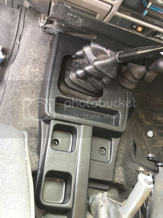

I have an HZJ77, when I bought it, I thought it was missing the center console, but from what i am reading, some did not come with one. Anyway I found this one on ebay, the overall shape fits nice, and the mounting bolt holes line up. The only thing off is the opening for the manual shifter, its off by about 1.5", but the tcase opening lines up perfectly. If you were to re-make it, wouldnt be hard to fix the opening alignment. My cruiser is JDM, I believe this console is for non JDM 70 series, which may be the reason it does not quite fit. Hope this helps.
That's a pic of the console. Thanks. Now I need to know if the RHD and LHD versions are the same or reversed. Anyone in Socal with one of those consoles?
My cruiser is RHD, the console I got from ebay, the one pictured is also for RHD(supposedly), the fit is near perfect, the 4 screw holes line up, it fits well around all the other components, the only problem is the opening for the shifter, that i could hide it by getting another boot to go over the rubber one. I would rather have the console opening be correct then using another boot. My other change would be to make the cup holders a bit deeper as these are shallow and do not secure cups well. If you were to use this one for your model we could definitely improve upon it to make a nice console for the 70 series crowd.
I would think the LHD is identical as long as the shifters positions does not change, which I cannot imagine they do, since the same engines/transmissions/tcases are used, mine is 1HZ/H55. My other thought was this console maybe meant for 70 cruisers with a different engine/trans combo, not sure what other variations are available for the 70 series besides mine.

That ebay console was molded from a prado 70 series (ie lj78). The console part # is based on the transmission, with appropriate trim level. That console is discont that's why it's be reproduced in malaysia. It'd be nicer if they just left the main shifter solid and let you cut your hole based on transmission. on the other hand you can cut everything off above the horizontal storage so you just have the cup hoders and storage slot.
HTH
1990 HZJ77

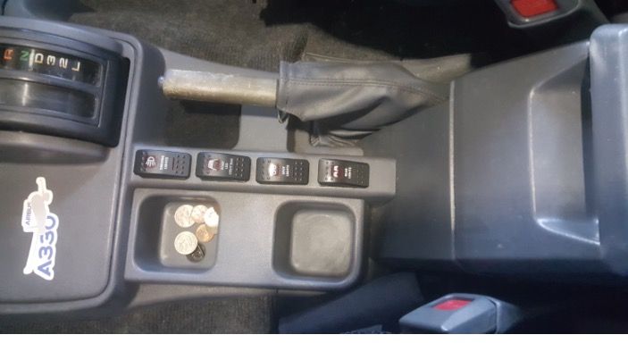

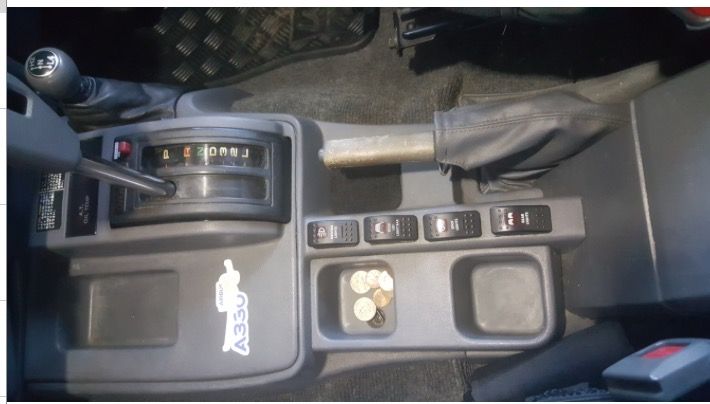

Thanks for that pic. So what is the depth of the two holes are the left? Are they the same depth?
Wesintl: Thanks for the insight, makes sense. Yea not many options out there for these, the malaysia ebay one was my best bet, at $80 it was worth a shot, actually fits good except for the opening. I like the finished look so I don't think ill be trimming it, but I think i will close up the opening and cut in the correct one, just need to figure out the cleanest way of doing it since it is plastic, be easier if it was metal.
The recessed area (left of shifter) is deep enough to hold most smart phones as long as you don't do a 5 G turn however the cup holders are basically useless until someone markets a square beer can.
