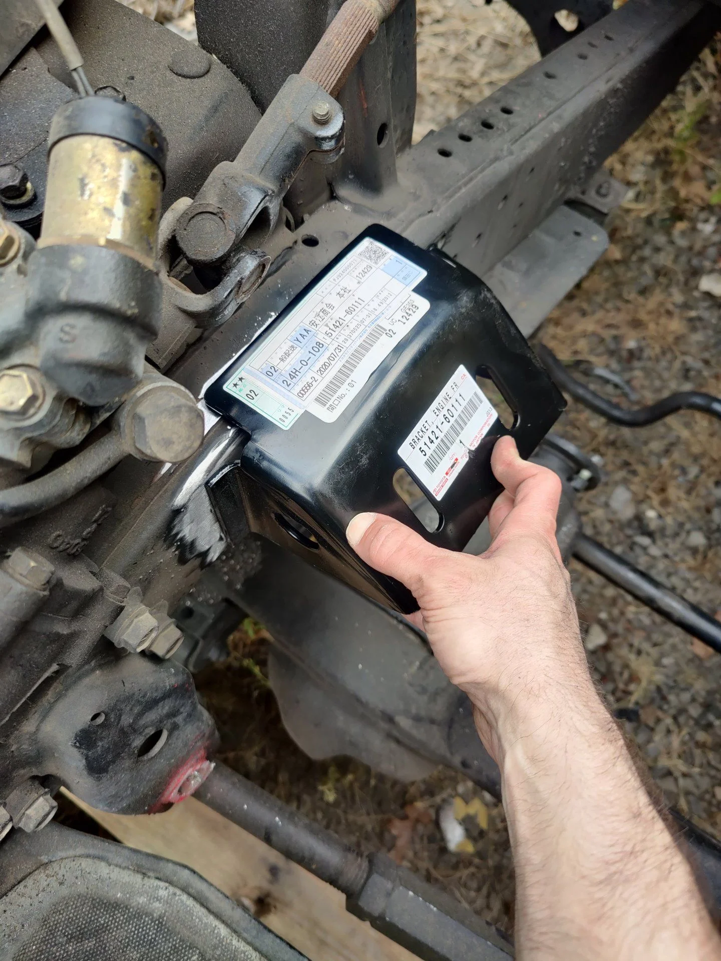

Frame mount came in! Here's a photo of it for parts number reference for future swaps. Hopefully it helps someone someday! If this weekend lets up a bit I'll yank the Cummins back out and try and get this mount at least tack welded on.

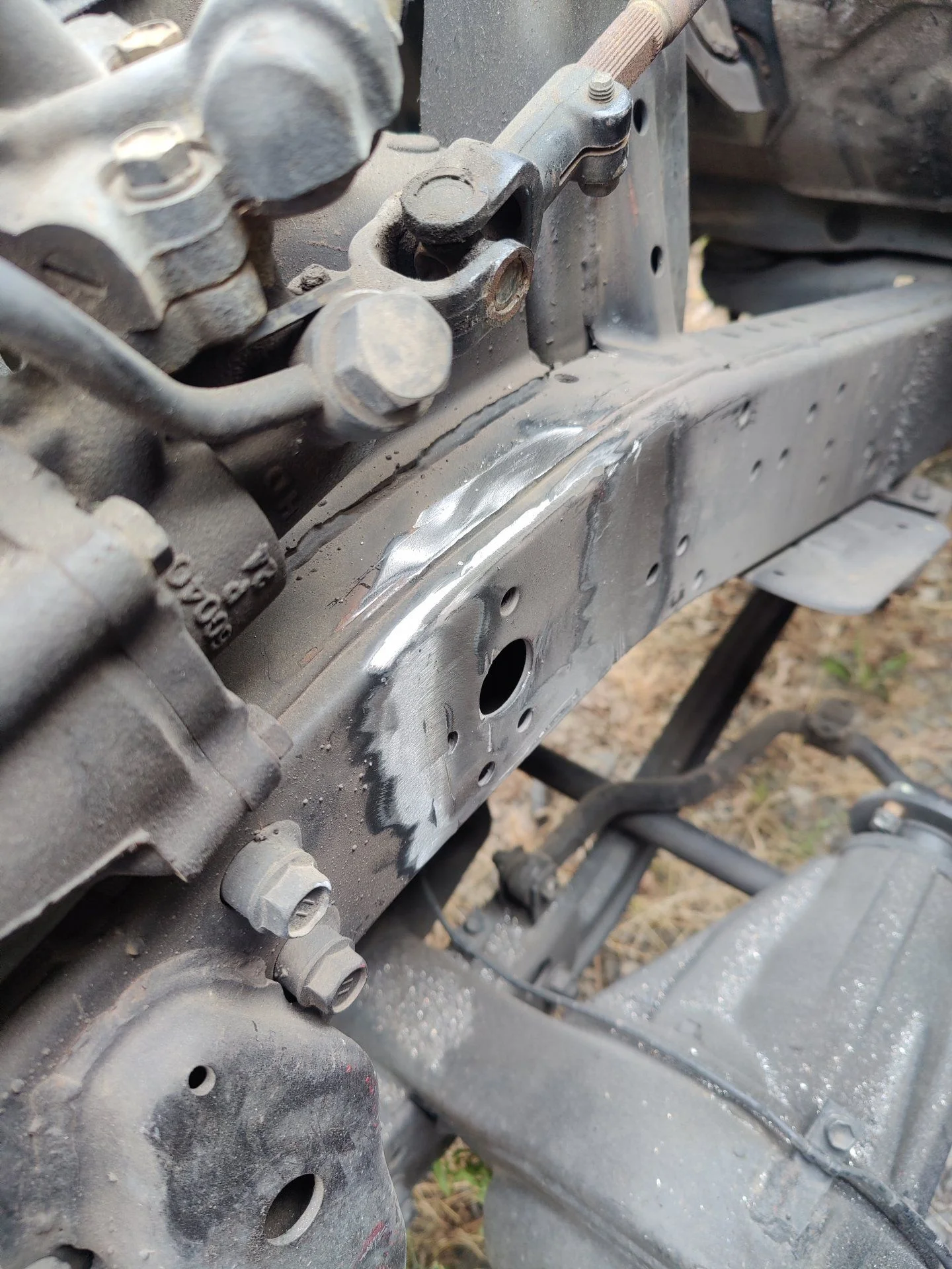

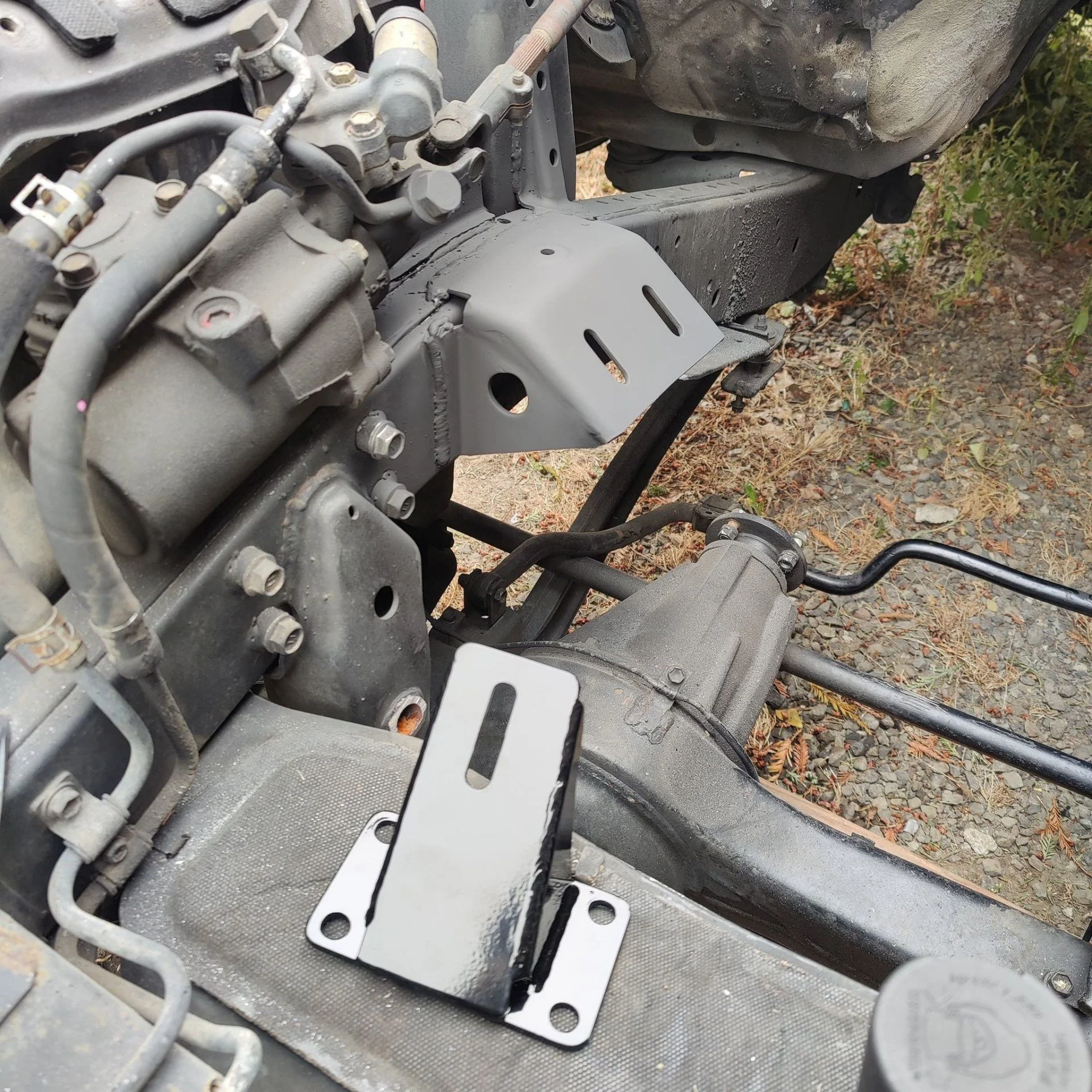

Progress! I have my new mount, have removed the old one, and am now trying to find some detailed photos if positioning of the new mount. It kind of wants to stay in a certain spot which is where I think it should be, but before I weld it I want to verify it.
Does anyone have a 80 series frame they can take some up close photos and maybe a few measurements for me?
Good news! I was able to get proper measurements from some pretty awesome people, and got the mount welded in. To top it all off, about 5 minutes after it was finished, the post master (of all people, weird) delivered my mail and handed me a package from Australia. The replacement engine side mount I hacked up came in! woo!
