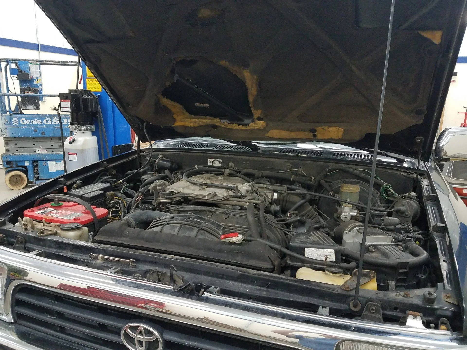

I'm an engineer at Cummins on the Repower Program, and started my own personal Cummins R2.8 swap last night - it's going into a 2nd gen (1993) 4Runner to be my daily driver. I haven't gotten into anything too exciting just yet, just got the 3.0L pulled out to start cleaning up the engine bay. Transmission will come out tonight. My plan is to use a new AX15 from Advance Adapters along with the R2.8 to 4.0L Flywheel/housing adapter from Axis. Engine side mounts are also from Axis, and transfer case is up in the air - Atlas to bolt directly to the back of the AX15, or stick with Stock Toyota and source an adapter...
For now, I just need to figure out how to make the engine fit....
