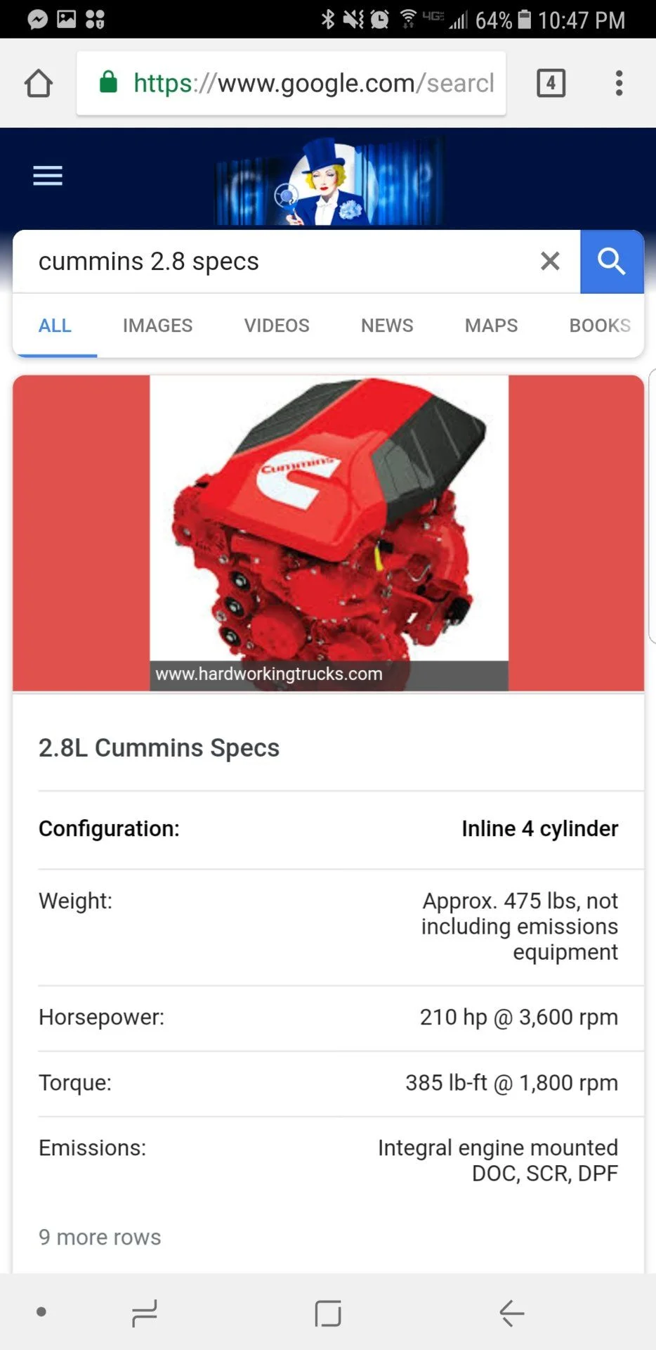

What's the total cost per additional hp/tq of this swap over say for example a 3fe? The 3fe has 155hp and 220lbft of torque. 2.8r has 167hp and 267lbft of torque. So that's a increase of 12hp and 47lbft of torque. If the 2.8r is 9000 dollars, that's 191.48$ for each additional lbft of torque, and 750.00 per additional horsepower. I'm guessing double the numbers for labor and other misc parts? Just trying to weigh the numbers.

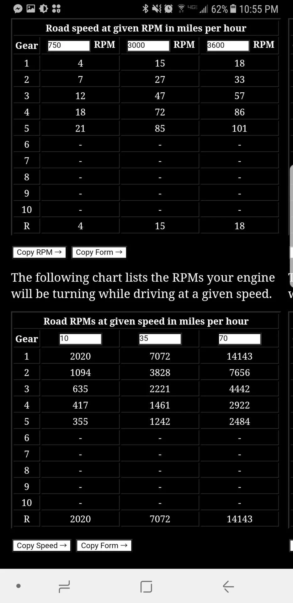

With h55 and 4.11s, it would have to rev a lot. But being a 2.8 one would think it should? Still I'm sure we would all like to see it in action.
If these are the same specs, it should get up n go alright.
Plugged in the h55f, 33 tires, 4.1 axle and a 3600 rpm redline into grimmjeeper. This engine should absolutely be capable of 100mph, maybe more if they are allowed to rev any more.
