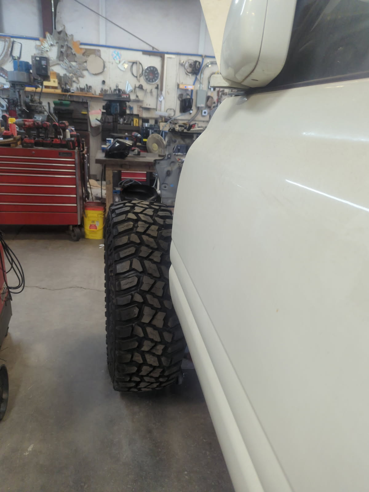

June Update,
A few changes were made during the setup of the front end and suspension. In order to squeeze out a little more up travel, we needed to push the engine back a little bit.
Unfortunately, in order to push the engine back a little bit, ... it would require going past the firewall,.. which would require... alot more modifications, and more time.
However, on the positive side,... This will help out with weight distribution, Fan and shroud placement, drivetrain angles, and, most importantly, allow for some additional uptravel that is needed to utilize 40" tires.

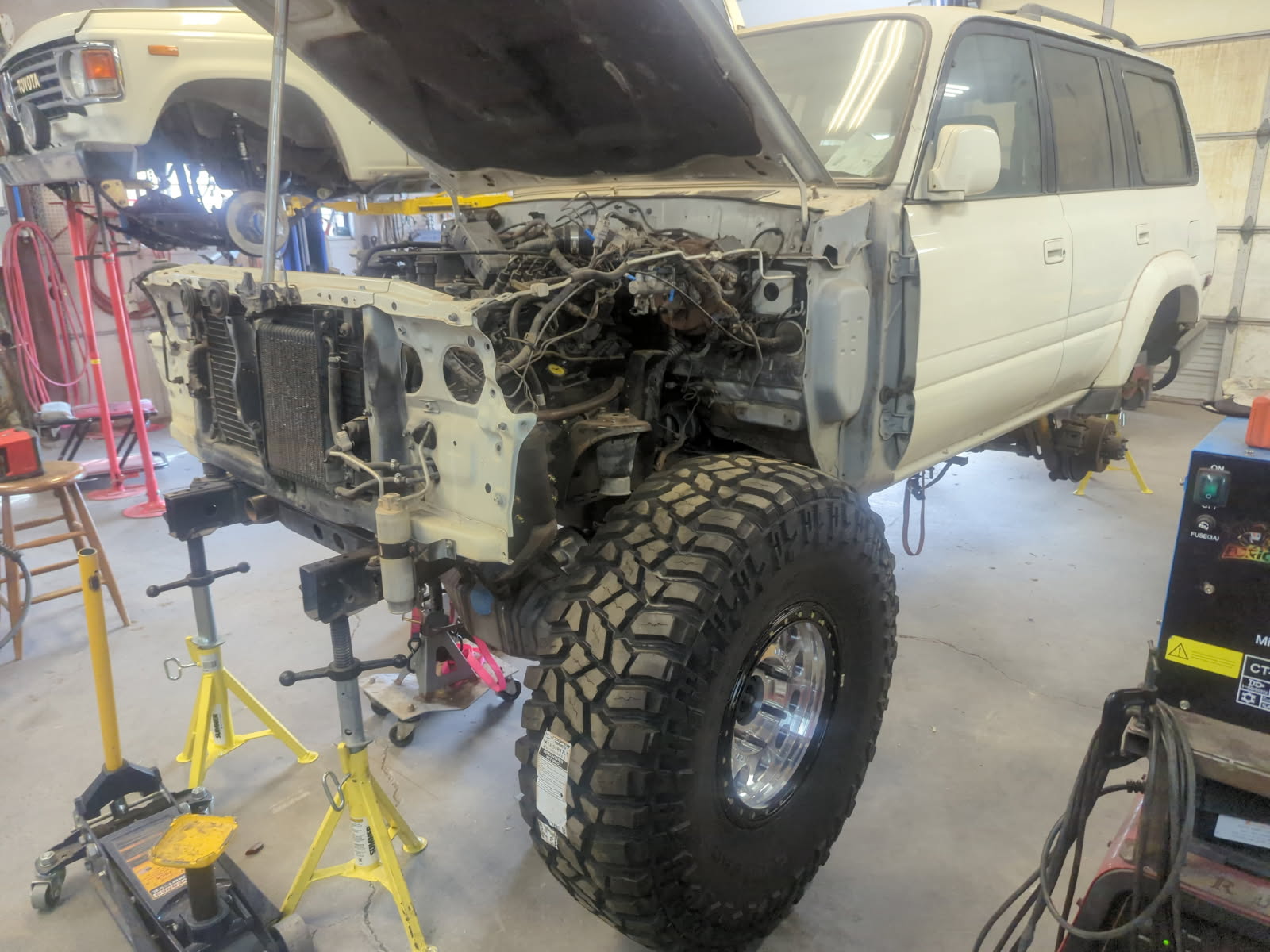

Greetings;
Its been a while since the last update. Its been busy and hectic since last year, but that's just how life goes. ProjectFJ80 has been moving along at a slow burn, but is now estimated to be complete by sometime next year, as long as there are not too many bumps in the road.
The axles are estimated to be complete and shipped by March, which will then move the project over to suspension.
The roll cage is coming along, as with the frame strengthening and link placements.
I bet that’s tough building links with no axles?
Freakishly gorgeous welds. And that reinforcement? You might weigh more than me by the time you’re done.
holy canoli that is some nice work and a ton of labor hours. You better really use this thing when it's done
Yes, gotten about as far as its gonna get until they come in. In the meantime, plenty of more work to be done on the roll cage.
The rabbit hole went real deep, real fast, as soon as the Toyota transferase was found out not to fit properly, on the passenger side... so, It went from... just get it running to.. . this...
Yes... a whole :poop: ton of hours... :cry: so much :poop:
