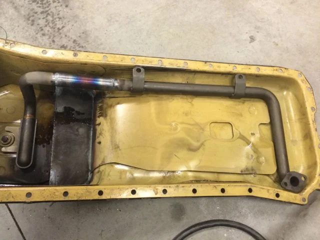

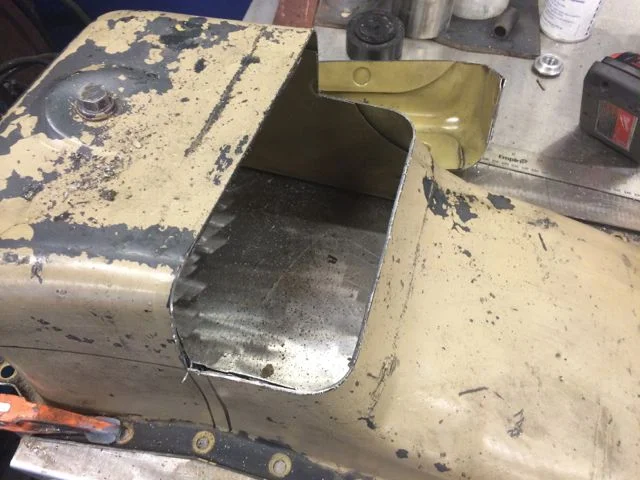

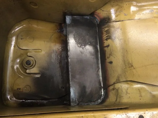

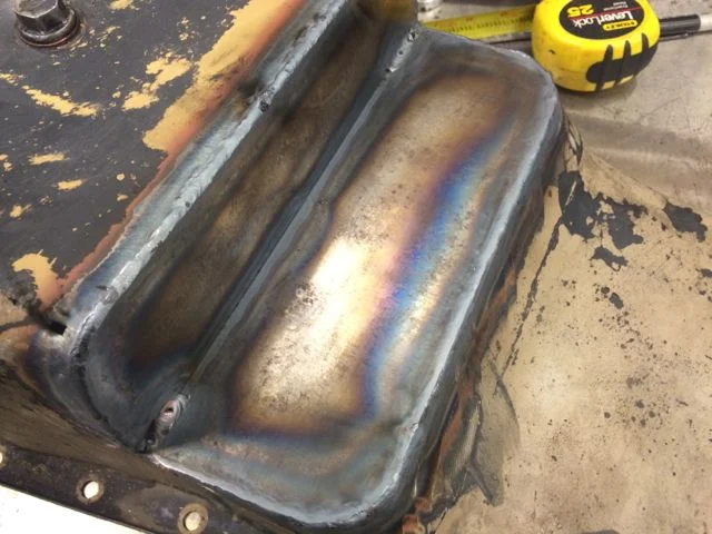

In preparation, spent about 2 hours on the pan today. A quick notch and oil pick-up relo. I TIG'ed the pan, but the welds still look a bit hellish. The pan has an interior panel that was happy to introduce oil into my welds as I went. Since we're not trying to win shows with this, just ran with it...
The 6BT pan will need to look something like this if on otherwise stock steering in the 80...

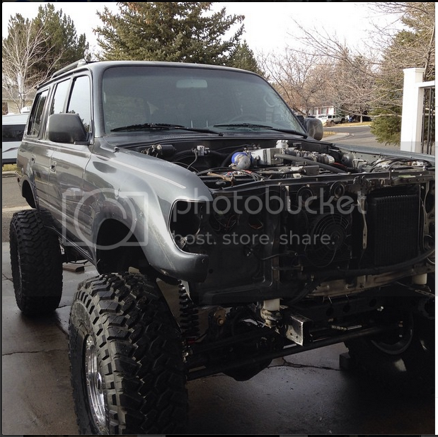

Turns out the one side of the truck is covered in bondo, and they didn't know what they were doing... And there's mismatched doors, you can see the color change in the above picture. The roof racks on these 80s suck btw. I took a sawzall to the mounting studs to get it off and there was rust and cracked bondo under one of the feet. Went ham on it with a roloc, need to get something kinda color match. Yuck.
