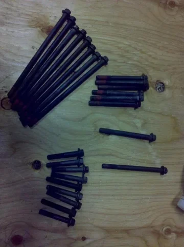

I might just have the bolts you need, if you want to swap those out.
The long ones are ~6.25", then 4", 3.5", 3", and 2". I might have some more of the 3.5" and 4" ones in the buckets I have, just didn't dig that deep. All 8mm x 1.25, off of dodge 5.9 teardowns. Let me know. And send me a PM next time, since I have the bolts from several engines lying around that I probably won't use now. :p
