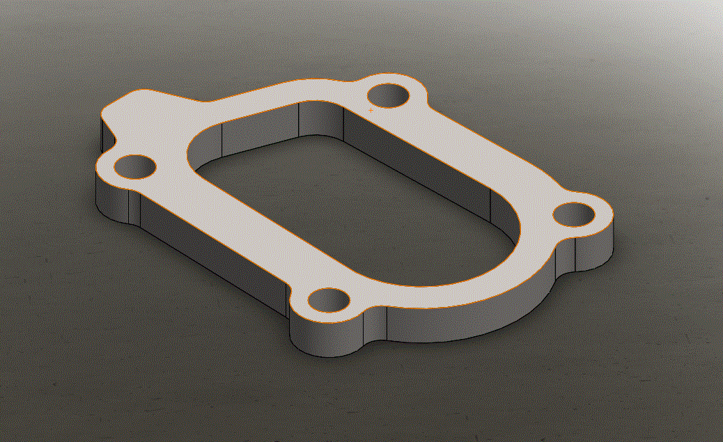

something like this?
I am sure you could call them, and they would machine it they way you need, they seem like small mom & pop.
I’ll do that. I like how it’s not just a wide open flange, that’ll make it easier to build a down pipe..

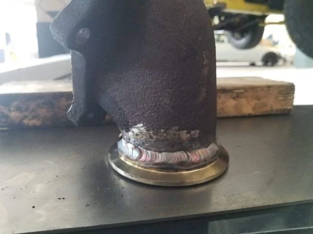

You could do something like this too. Mine seems to be holding up fine, the $150 one is nice but I couldn't justify the cost.

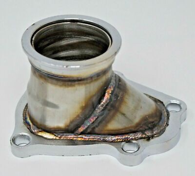

Thoughts on this?
Looks nice. One disadvantage is the length. It reduces the room you have available to get the first bend down past the firewall.
You may need to use short leg bends or a tight radius mandrel bend.
Thoughts on this?
I ordered one of these months ago and finally got around to fitting it. I built a complete exhaust that runs between the transfer case and frame at the same time. Had to cut it and add a tight 90* because it hits a heater pipe. Great cheap option after some modification.
