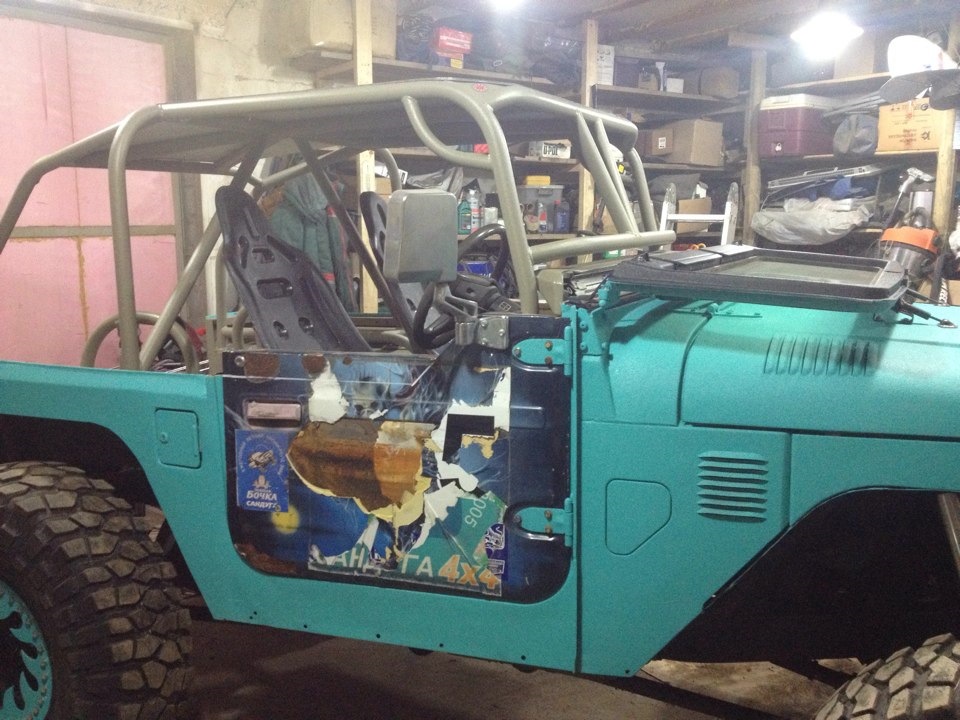

Roll cage is ready
Doors with old crawler will soon go for repairs, they spoil the whole look :)

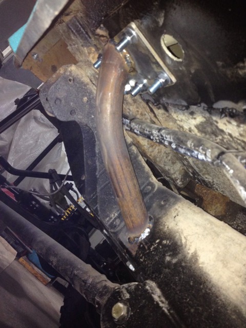

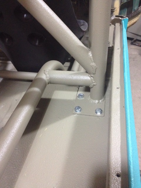

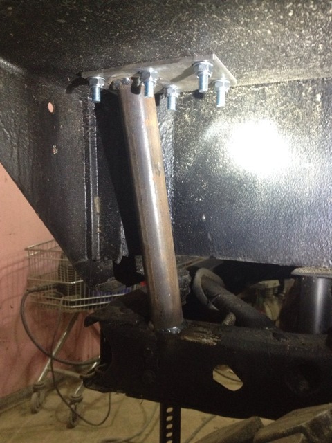

Wow thats a beefy looking cage. A lot of people use some sort of rubber insulator rather than welding straight to the frame on fj40s. Usually just leaf spring bushings. fj40 frames flex a lot, with the cage welded to the frame directly its possible the body will crack without some give-just a heads up.
Thank you! My expectation is that the frame will not be twisted as before, it will add greater strength roll cage, even if it would burst the metal where it will not happen soon and I was not much worried.

Tying into the frame with a cage like that will provide support to the frame and let the suspension do it's job. Nice work!

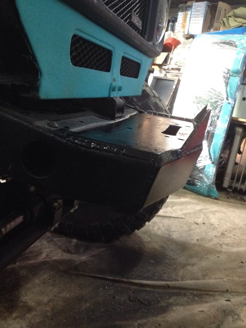

Thank you, I also plan to use a small winch back, but they are 12 volts and my onboard network 24. For the front axle, I made a winch plate with two fairlead
Front will work fine in that fashion. That is exactly how I have mine, but it's rarely used to suck the front down. Sometimes, but not often. I never use the rear suck down winch. It was a wasted effort.
Thank you! I decided not to rush back to the winch and your opinion proves that we should not rush.
