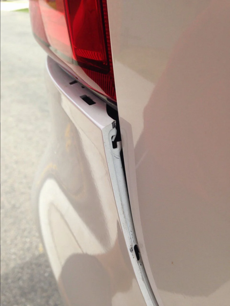

Forgot to mention that, while driving sober, I attempted a 50 point turn in the above pictured valley and backed into a dune. :steer:

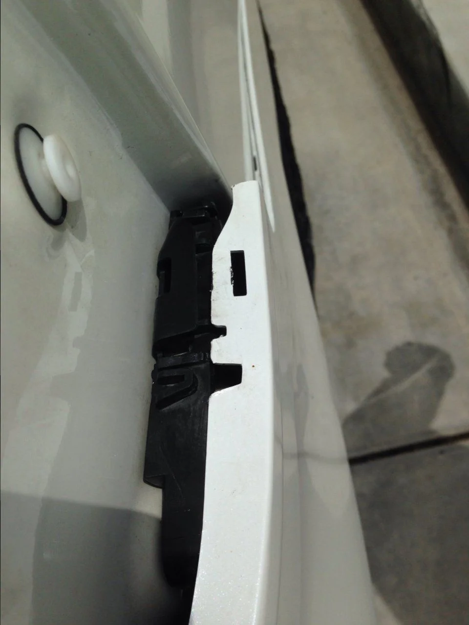

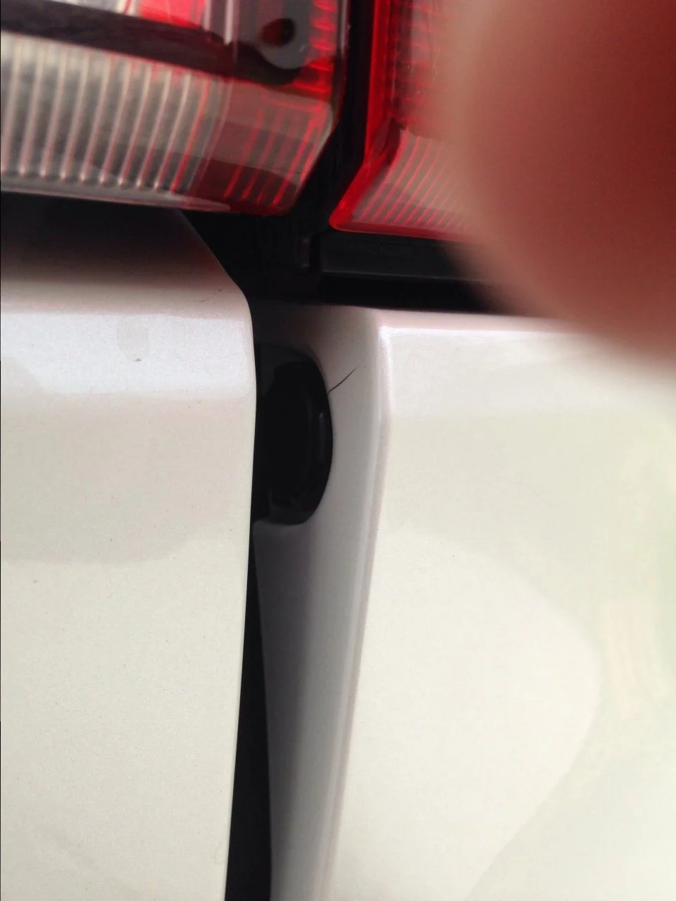

As you can see, the little tabs that secure the bumper cover snapped. Body shop says the whole thing has to be replaced, painted, $$$$

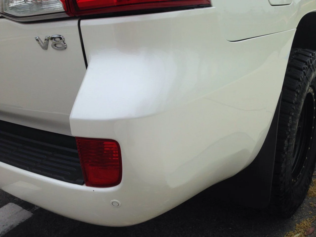

What I don't understand is why they didn't just pop out. As you can see from the picture below, there was hardly any other damage - just a rub really.
If you are not to bothered about minor paint sratch/scuffs etc you shoul consider having the plastic repaired. Its completely doable. For the crack you can buy plastic repair kits- in white! . If you chose not to have a go at repairing the broken tabs there's always the old dob of silicon trick: (squeeze a healthy dob of clear silicon in beside the broken clips and tape the two panel surfaces together until the silicon sets. Always easy to break off again if you need to remove panel.

Honestly, even if you don't want to attempt the repair yourself, get a second opinion. My body shop repairs bumper fascias for me all the time. Even fills 3/4" holes...
Doesn't look like it needs any paint.
No paint needed...just wish I could snap it back in place.
Don't throw in the towel. This can almost certainly be returned to a cosmetically "acceptable" condition. It will probably need to be removed and reinstalled to get it back together right. As you've discovered, you can't generally just snap it back. Somebody that's familiar with body panels could probably have it off and back on in well under an hour. You just need to take a look at the cracked part to see if they need to legitimately be repaired or can be "patched" with little bits of aluminum or plastic and #4 screws. I assume you're further north than SD?

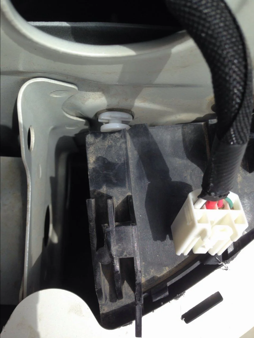

At the very minimum, you should pull the tail light. That should give you a much better perspective on the situation from what it looks like in the pic. The light is probably only held in with two screws/bolts and a couple locking pins. Usually, once you pull the two screws, the light pulls straight back to pop the retaining clips loose. Obviously, you kind of need to look/feel it out, don't just yank...
Don't give up, we can fix this ourselves for cheap. I think the first thing to do is remove the entire bumper cover and get an idea of how it attaches. After that we can figure out a game plan. There are a bunch of different options we can use the reattach this. When and where do you want to do this? I've got a full arsenal of tools how about you?
I am around today if you want to bust this thing out. After that my weekend gets pretty tight. Might have sometime Saturday afternoon after 2pm.
I can swing by right now to meet, but I'm helping out with an egg hunt at the kid's school at 1:45. Is that OK?
For anyone interested, here's what it looks like without the light housing.
