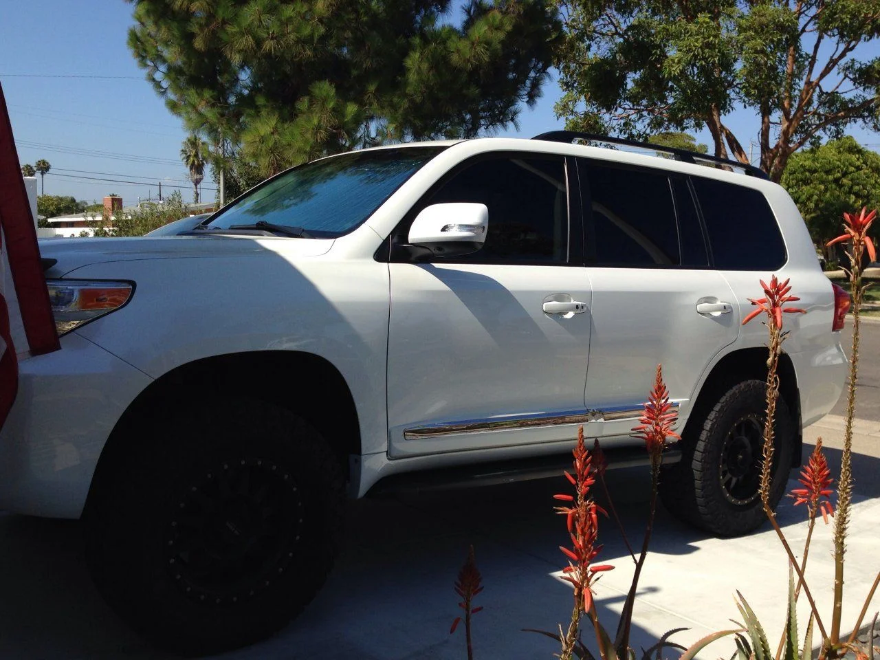

Crappy pic, but got tint: 80% front windshield and 30% everywhere else.

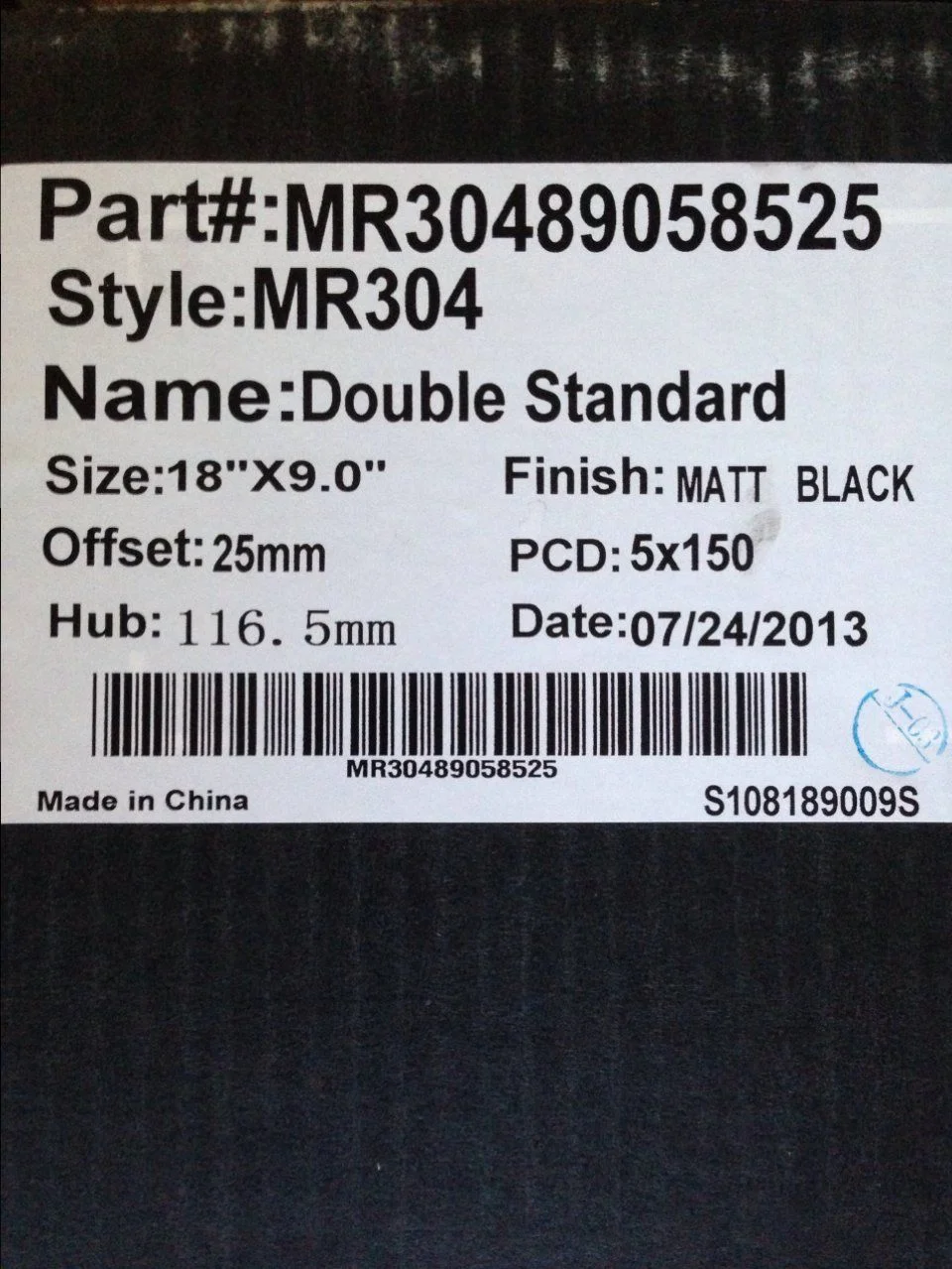

View attachment 883584 It's a 2013 with KDSS. They had to take the truck to a Toyota dealership to reset the KDSS after the install. It cost around $200. I have had zero issues.
Suspension:
Front - ICON 2.5 Coil Overs
Rear - Old Man Emu HD Coils and Shocks
Tires:
Toyo A/T 2 325/60/18
Wheels:
Method Racing 304 (pic of label above)
The spare is located under the boot, but I kept the original.
