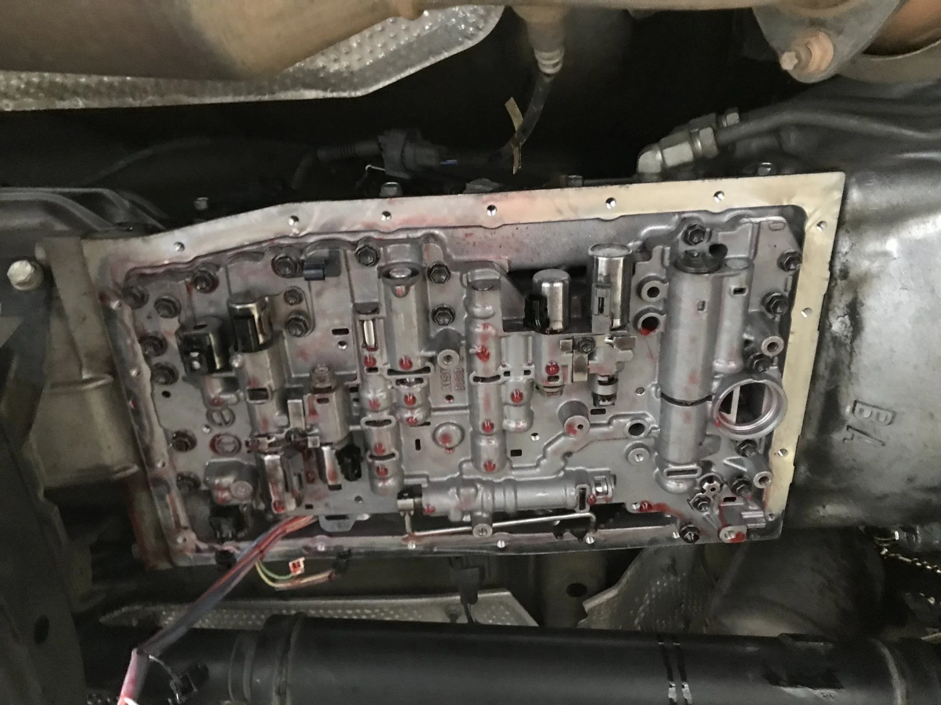

Rocket Rod built a Nomad HD VB for us a few months ago which I installed in my 1999 UZJ100 shortly thereafter.
The install was very straight forward; took a little under 3 hours since I have a full set of belly pan skid plates on this cruiser. One thing to keep in mind is that the torque converter will drain once the original VB is removed do make sure you have plenty of fluid on hand. Depending on application, you’ll need 8-12 quarts.
The results were exactly what I had hoped for: slightly firmer shifting and increased fuel economy. The shift points are slightly higher and just a bit firmer but not “snappy” like a shift kit you’d run in a hot rod.
Overall, I’m very happy with it.
We’ve also installed a number of these on other applications like FJ62, 80, 200, Tundra and GX470 and 460. And most recently a 4th gen 4-runner with an A750F ( pictured above ).
