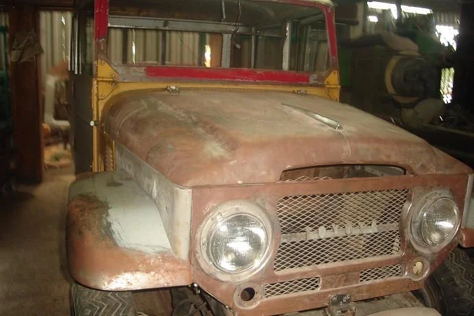

Just finishing off details..(endless)
here how she looks now, will drop some diffs on her and get her out for some decent photo´s.

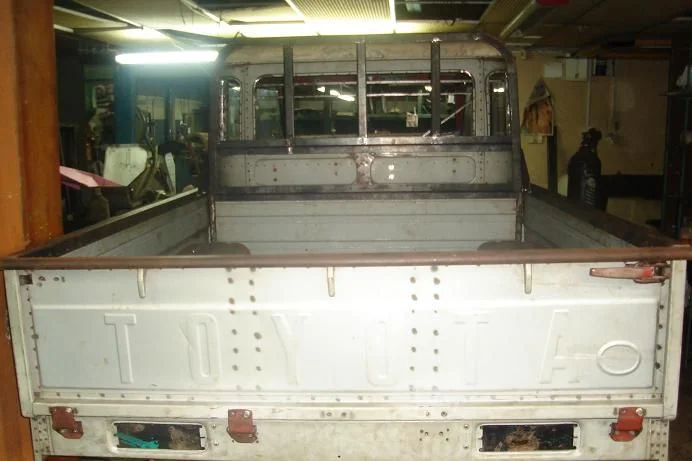

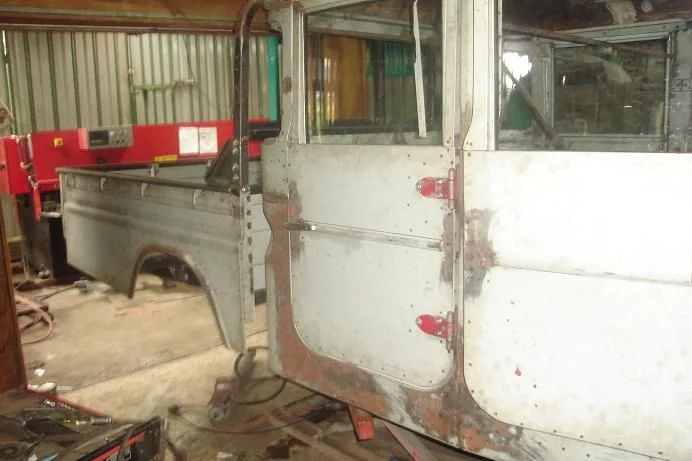

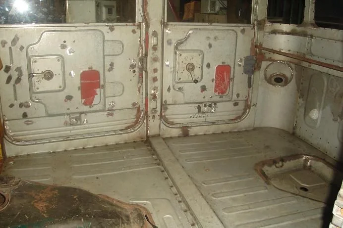

toyotona
a few more,
doors are custom made also. the bed is 65cms shorter than stock, that slice has been taken out of the front of the bed, headache rack we made, the only things stock are the window frame,bib,hood and firewall.
Paul
