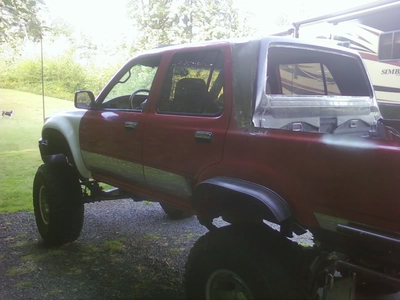

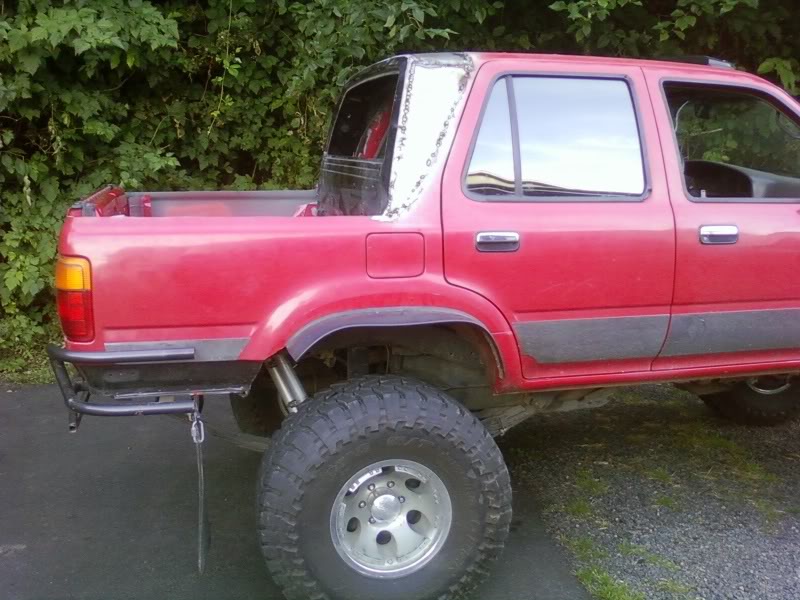

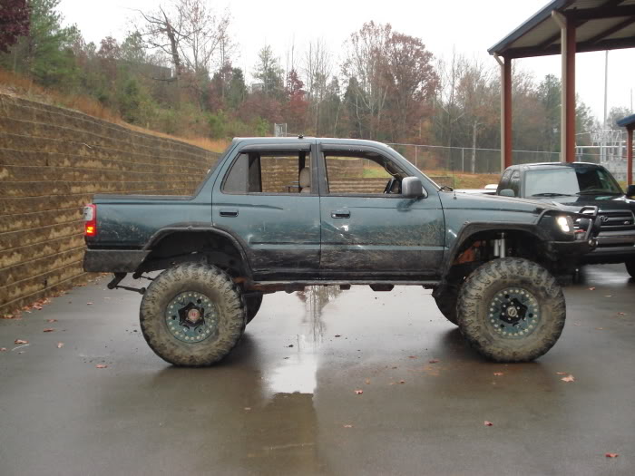

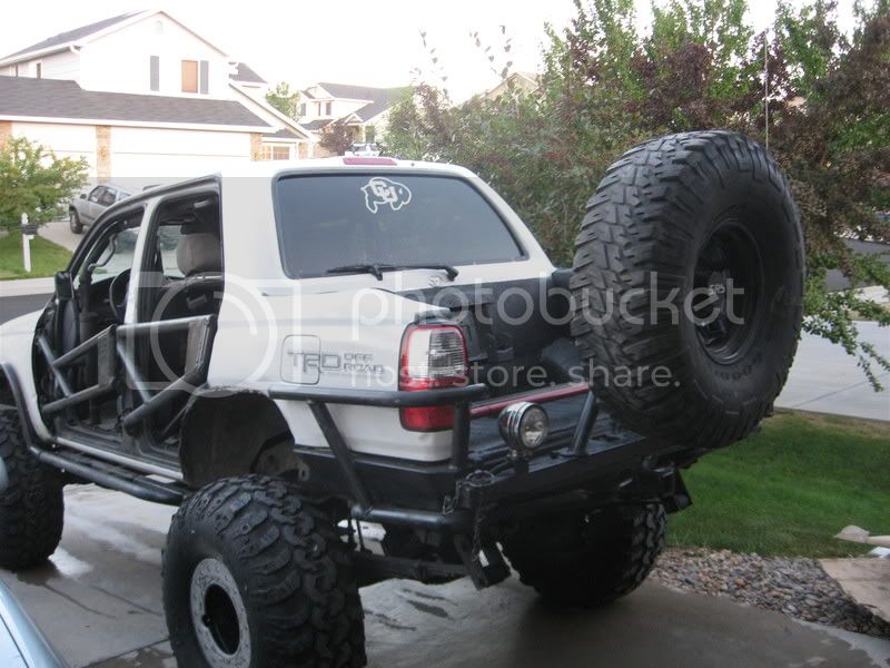

I saw a 2nd Gen 4runner that had a same model pickup rear cab section grafted right behid the rear seat. Then the rest was used for a bed. Kind of like the Avalanche or Honda Ridgeline. Turned out pretty good.
*EDITED for Pics
Im really digging this,
I havent seen one done that clean. It might change my plans :)
