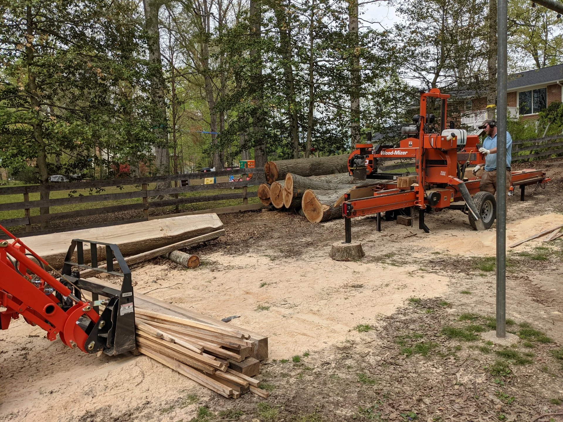

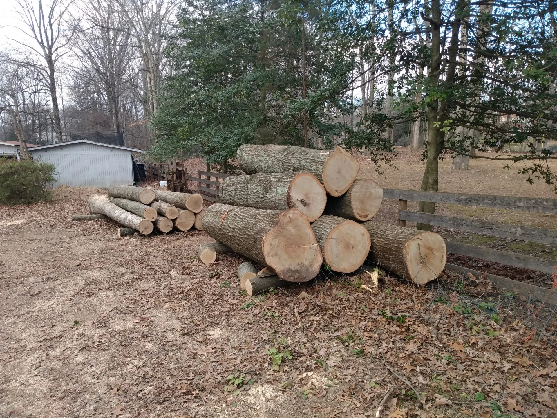

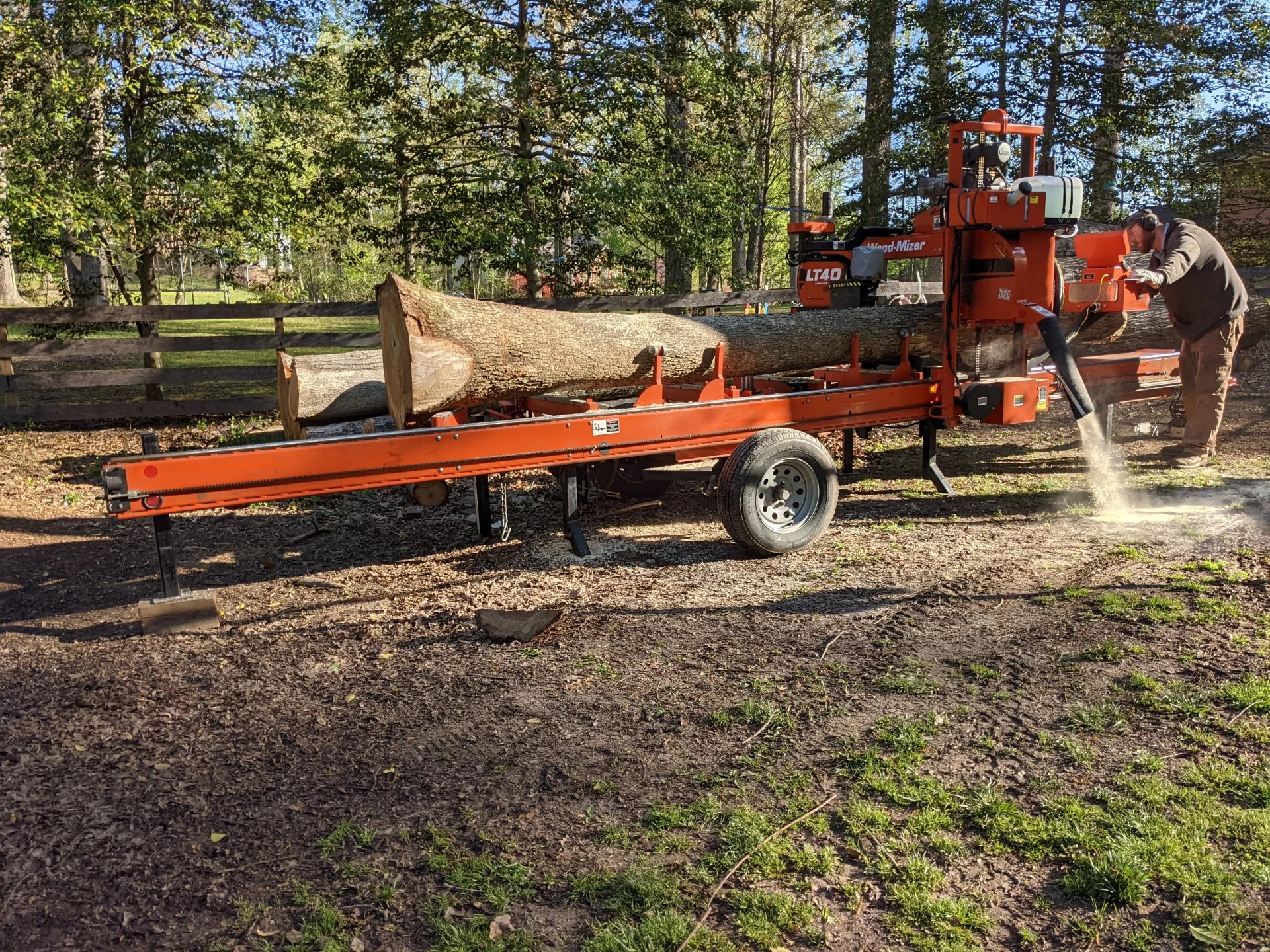

I just had some red and white oak logs milled a couple weeks ago. Found a local sawyer who comes onsite for an hourly fee plus blades used. He had an LT40 with the full hydraulics package. It was amazing how efficient he could be with the hydraulic log loader, log turner dogs, log levelers and supports. So impressive to watch this guy work. He said he just put an order in with Wood-Mizer for an LT50 with the diesel option and was told November at the earliest. It took me a month to get on his calendar and he said he's now booked through August. He just started this side gig a year ago, clearly this was an untapped market in our area. If you have any thoughts about using the mill as a side gig you may want to consider one with hydraulics. It took this guy about 12 hours over 2 days to mill this pile of logs and he used up 5 blades. Also, offloading the milled boards would have SUCKED without the tractor.

Edit: The log on the ground with with 2 sides cut had a lighting strike some time in its past and was checked and burned up and down the inside of its trunk. Pretty cool to see but sucked to have to turn an otherwise beautiful white oak log in to firewood.
What he charge? Portable sawmill guys in Oregon are $90-$100 an hour.
$75/hour +$25/blade. I think he has a mobilization fee as well but he's based only 20 minutes away from me so he waved it.

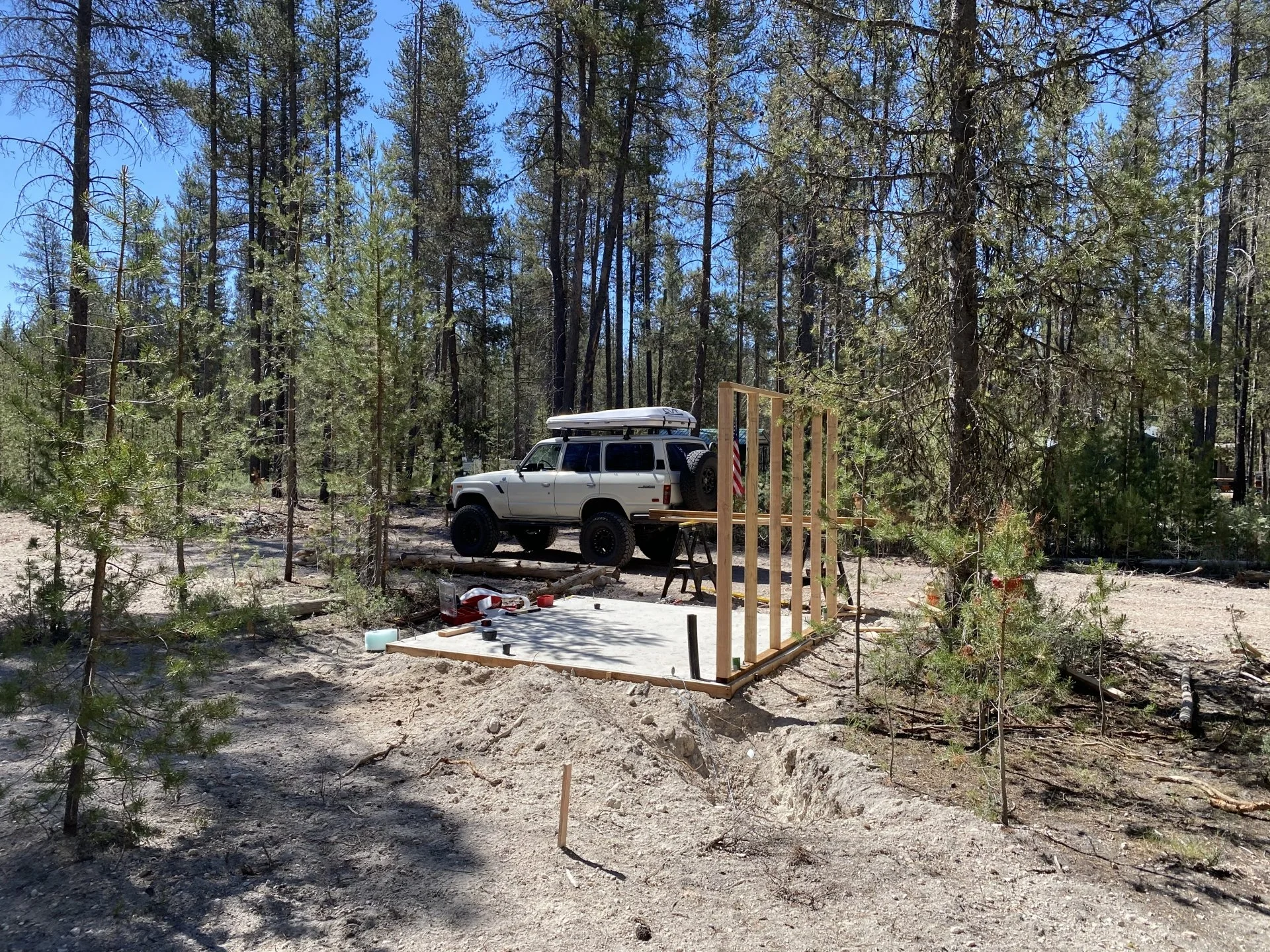

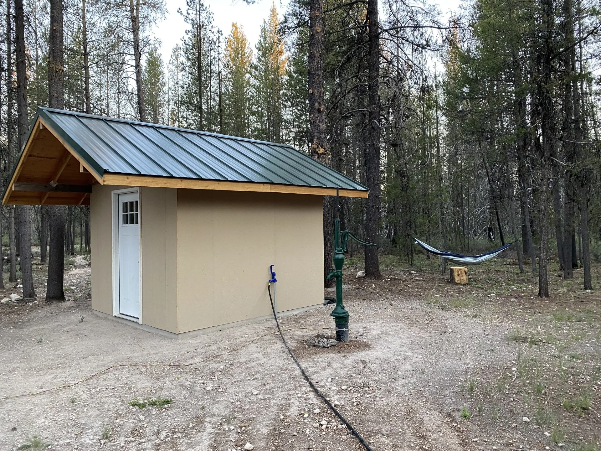

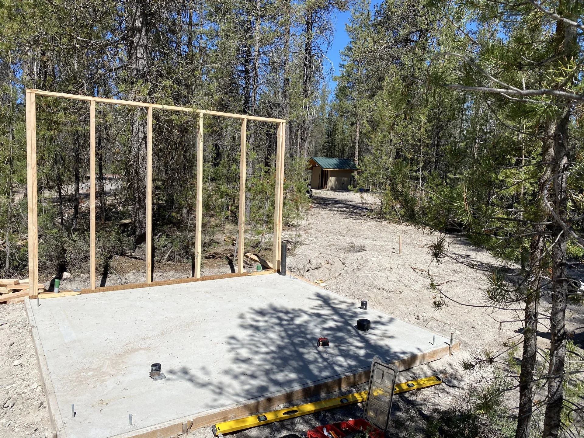

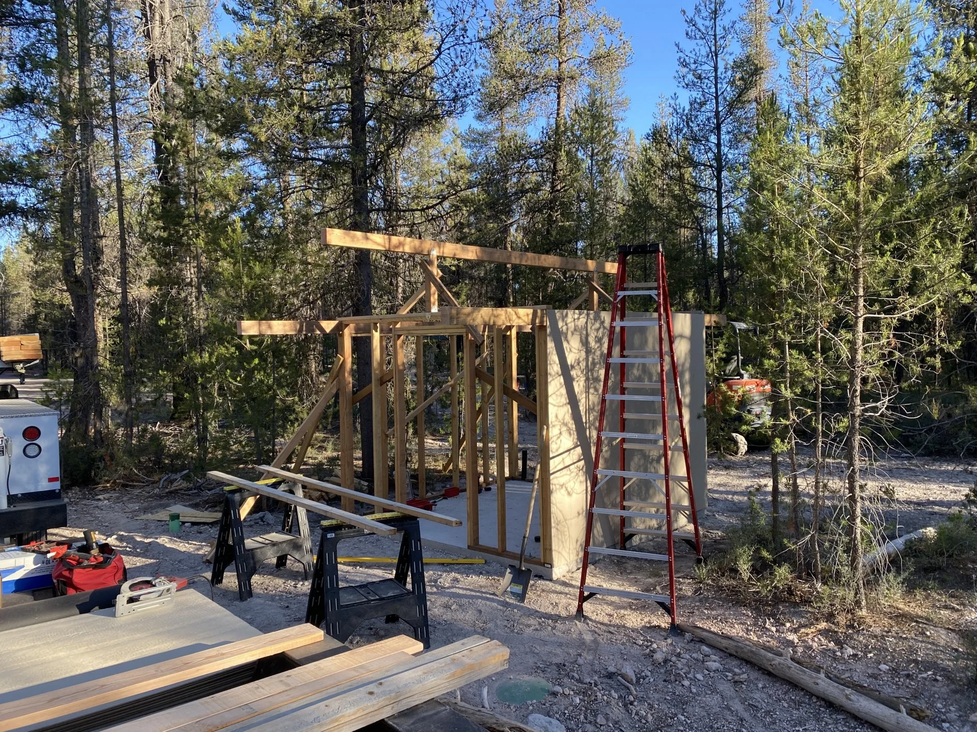

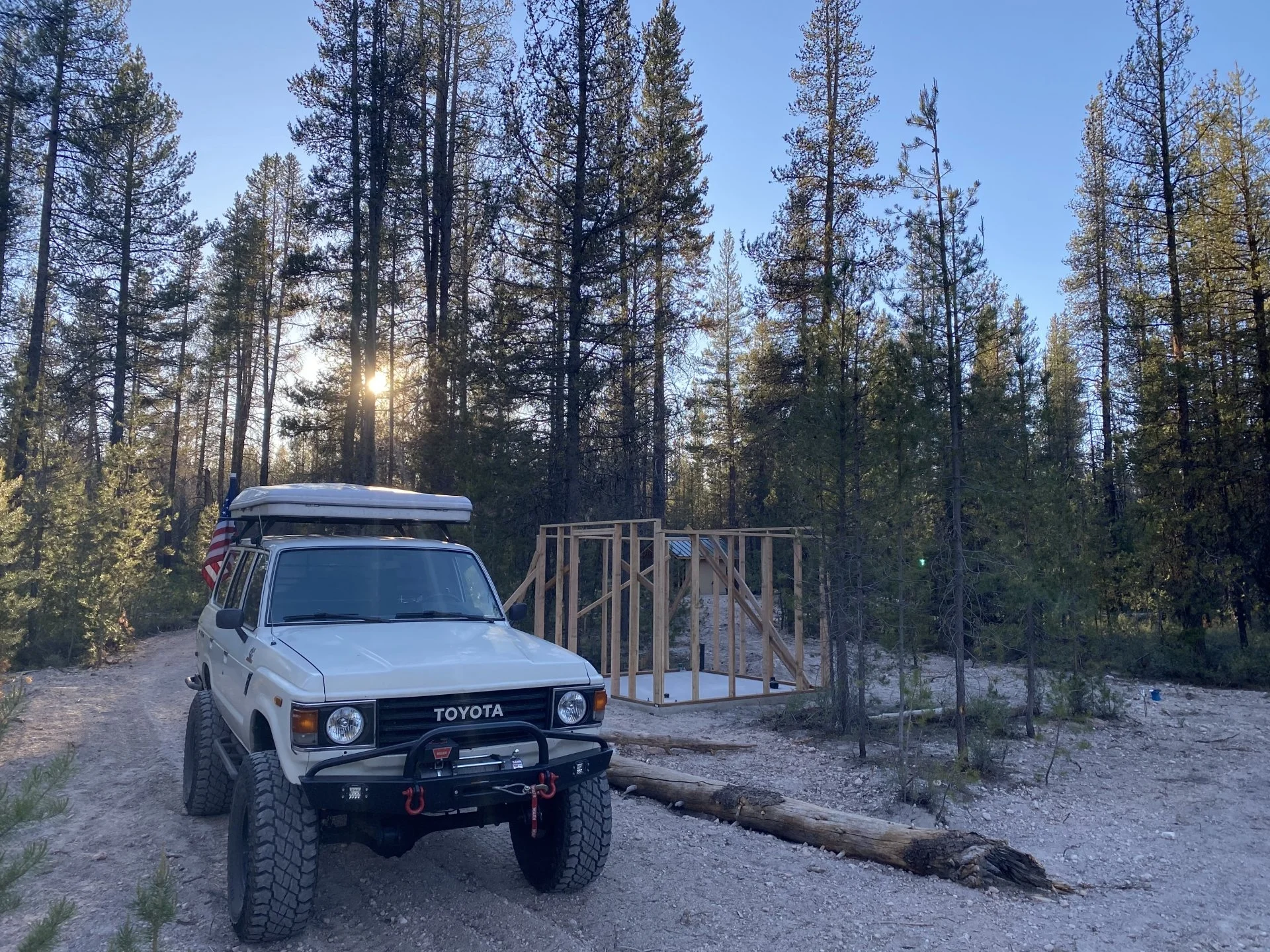

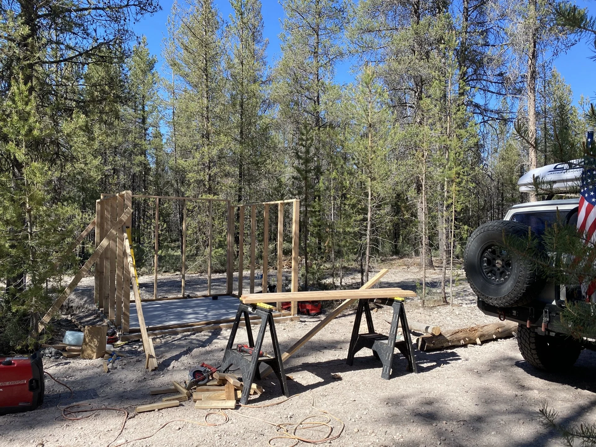

Getting ready to start the bathroom structure.
One wall was quickly up but my pumphouse structure needed some organization.
Haven’t felt rushed today like the time when I built the pumphouse structure in the cold and snow. It’s been way more relaxing and enjoyable with temps in the 70s and a nice breeze.

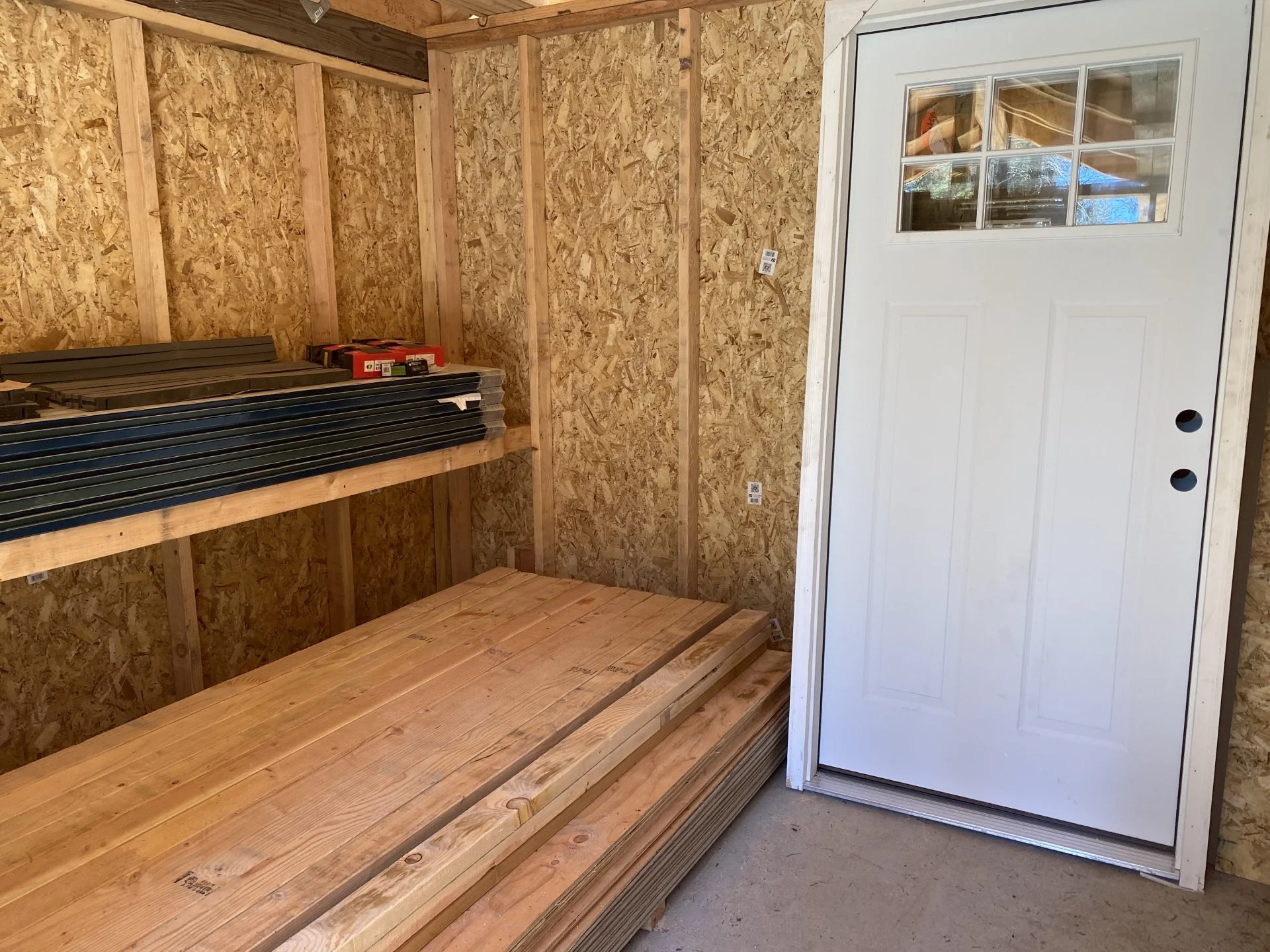

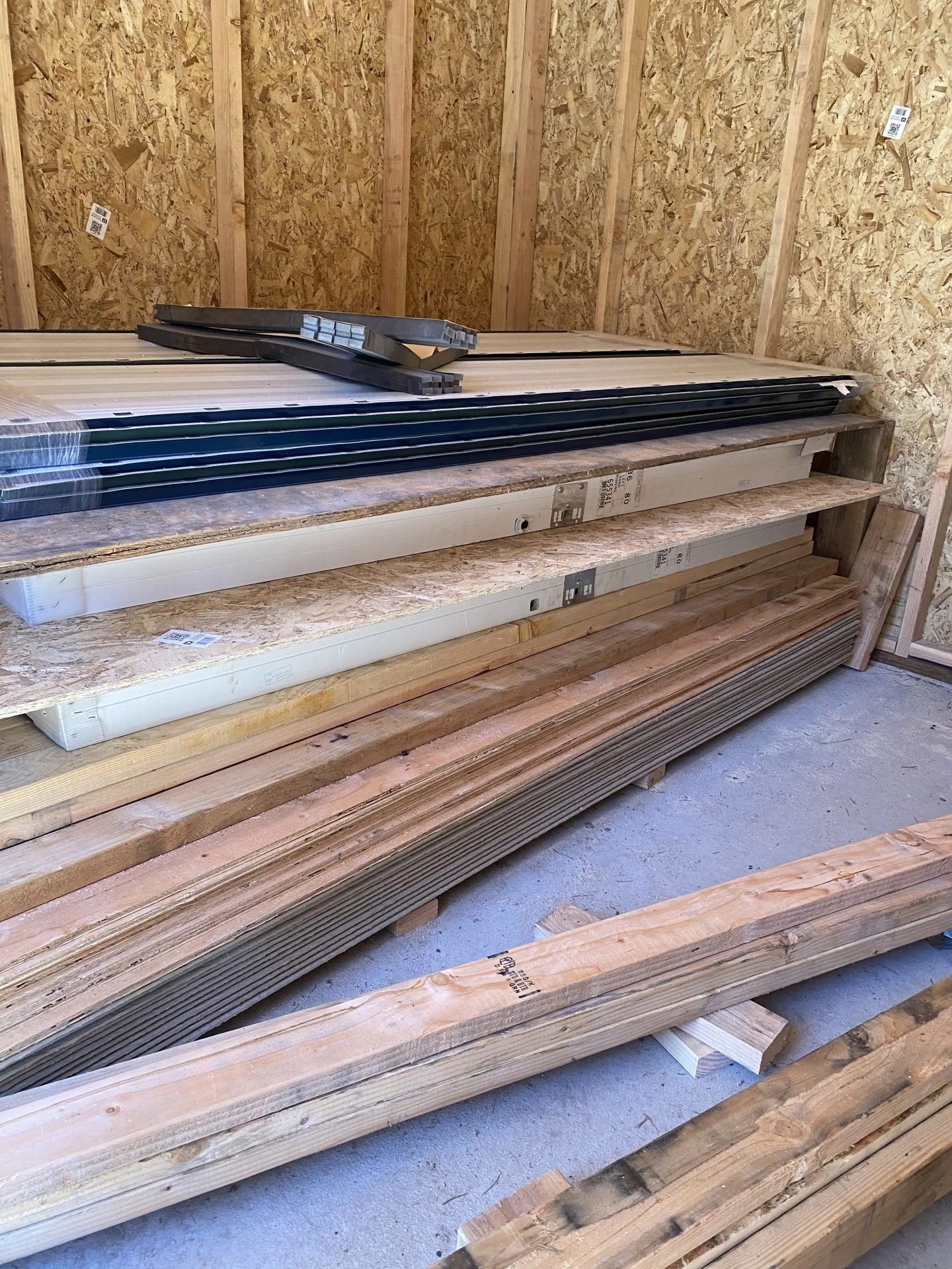

Really needed to organize the pumphouse materials as the rest of the 2x4x8 were under metal roofing panels and both doors.
Built a shelf to get the metal panels out of the way and was able to get the doors up right. The green Doug fir was still damp as the bottom door had a bit of condensation. The mild weather and wind outta help dry everything out.

Getting ready to knock the door wall in.

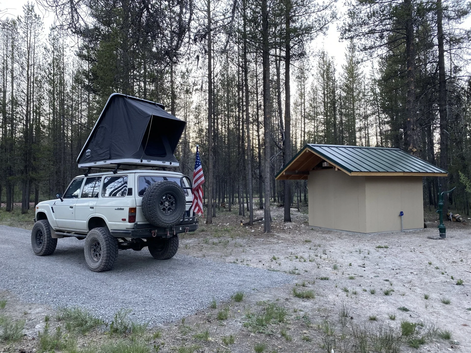

Got the door wall knocked in and it was time to camp! Headed back down end of June to finish the bathroom construction and camp with the family.
Rooftop tent up in less than a minute!

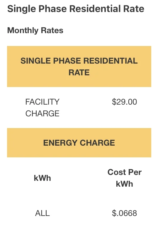

In other news getting electrical plans in order the past week with the utility provider. Since I’ve got 3” conduit already installed on my well lot from the pole to my pumphouse I’ll be moving forward on that lot. I ran a conduit from my pumphouse to the bathhouse structure last year so will be able to supply power to that lot through the conduit. Power there is really cheap.

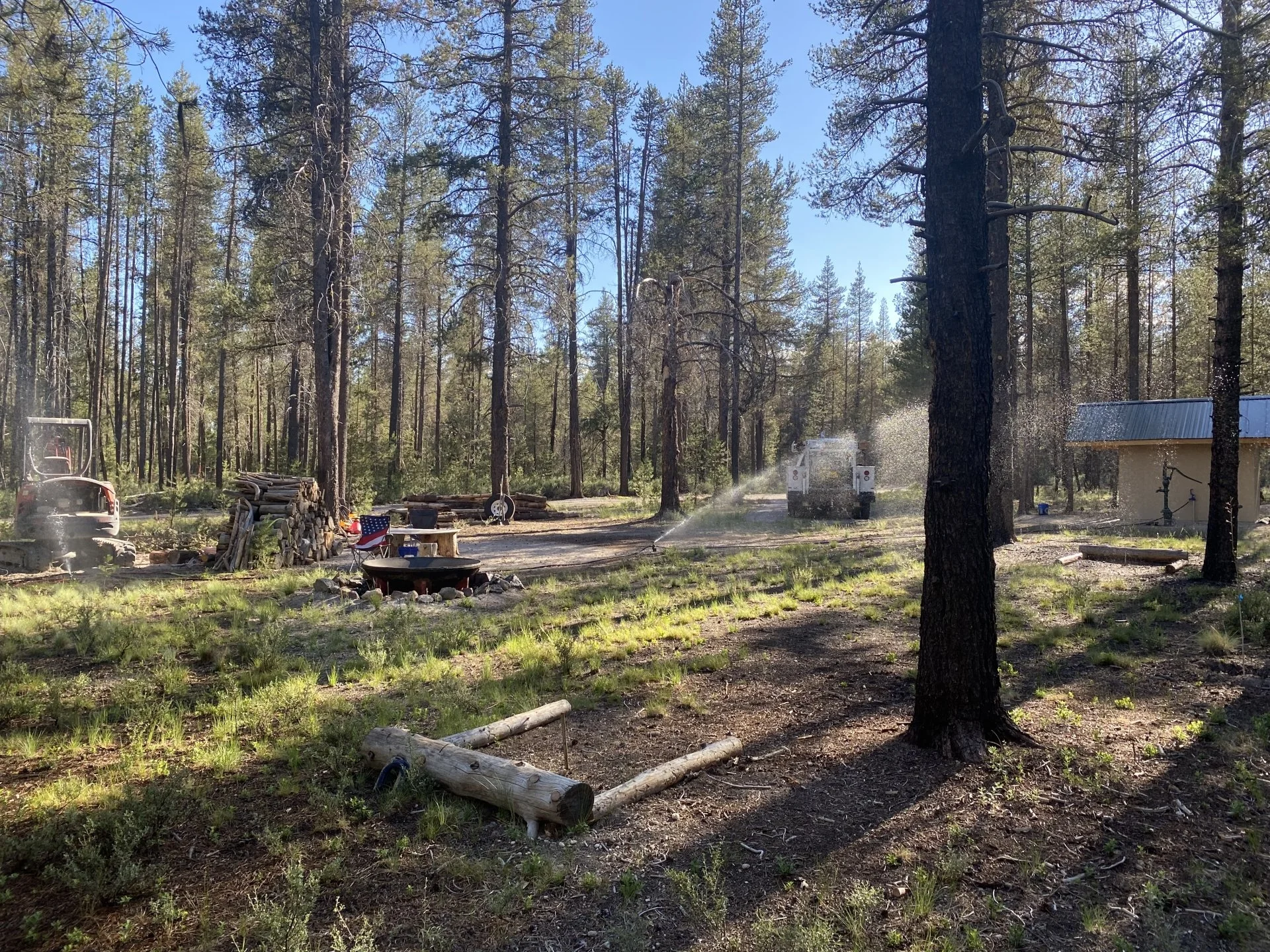

Got to the property and setup the new rock crusher drum campfire pit

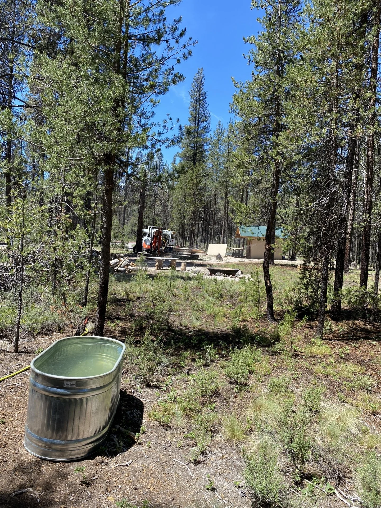

Started filling the galvanized water trough so I had a place to cool off. Also setup the sprinklers.

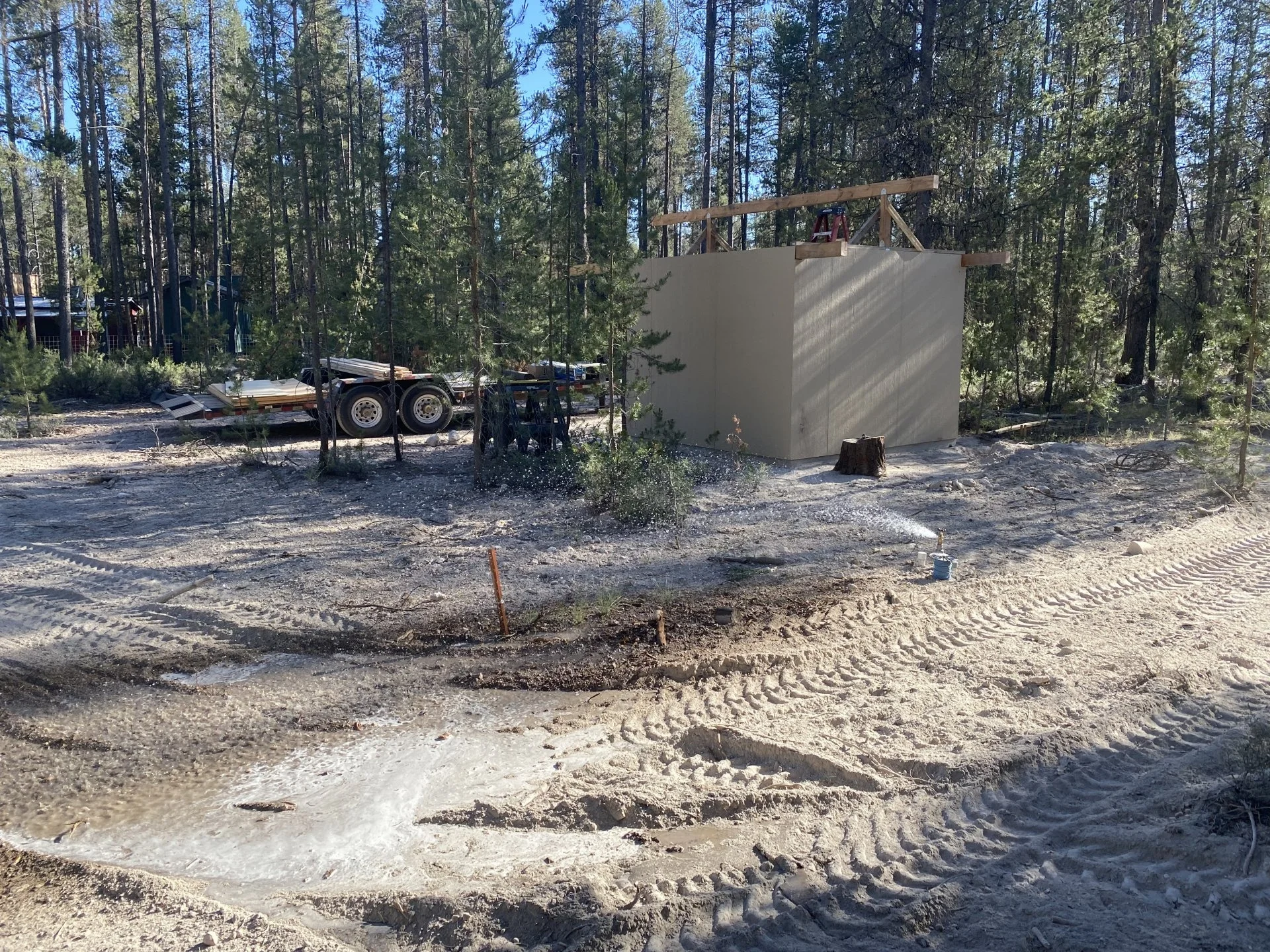

Installed the 4x6x16 beams, used the 2x4s to make sure the beams were all centered correctly.

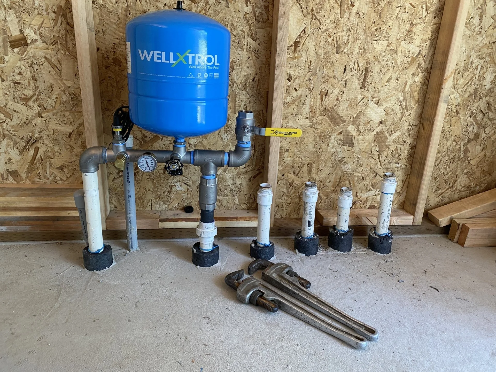

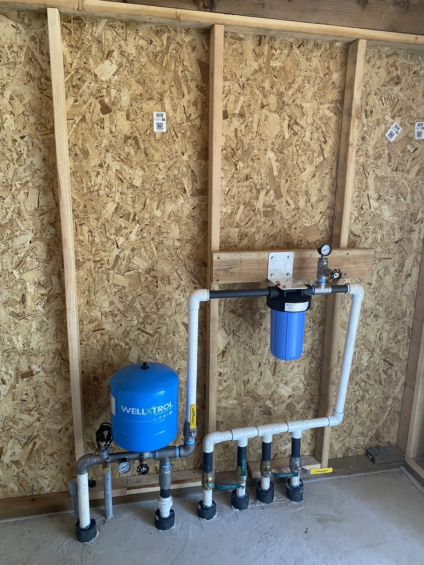

Plumbing in the well pump pressure tank manifold and the hand pump supply line. The 45psi of pressure on the gauge is pressure from charging the system with only the hand pump.

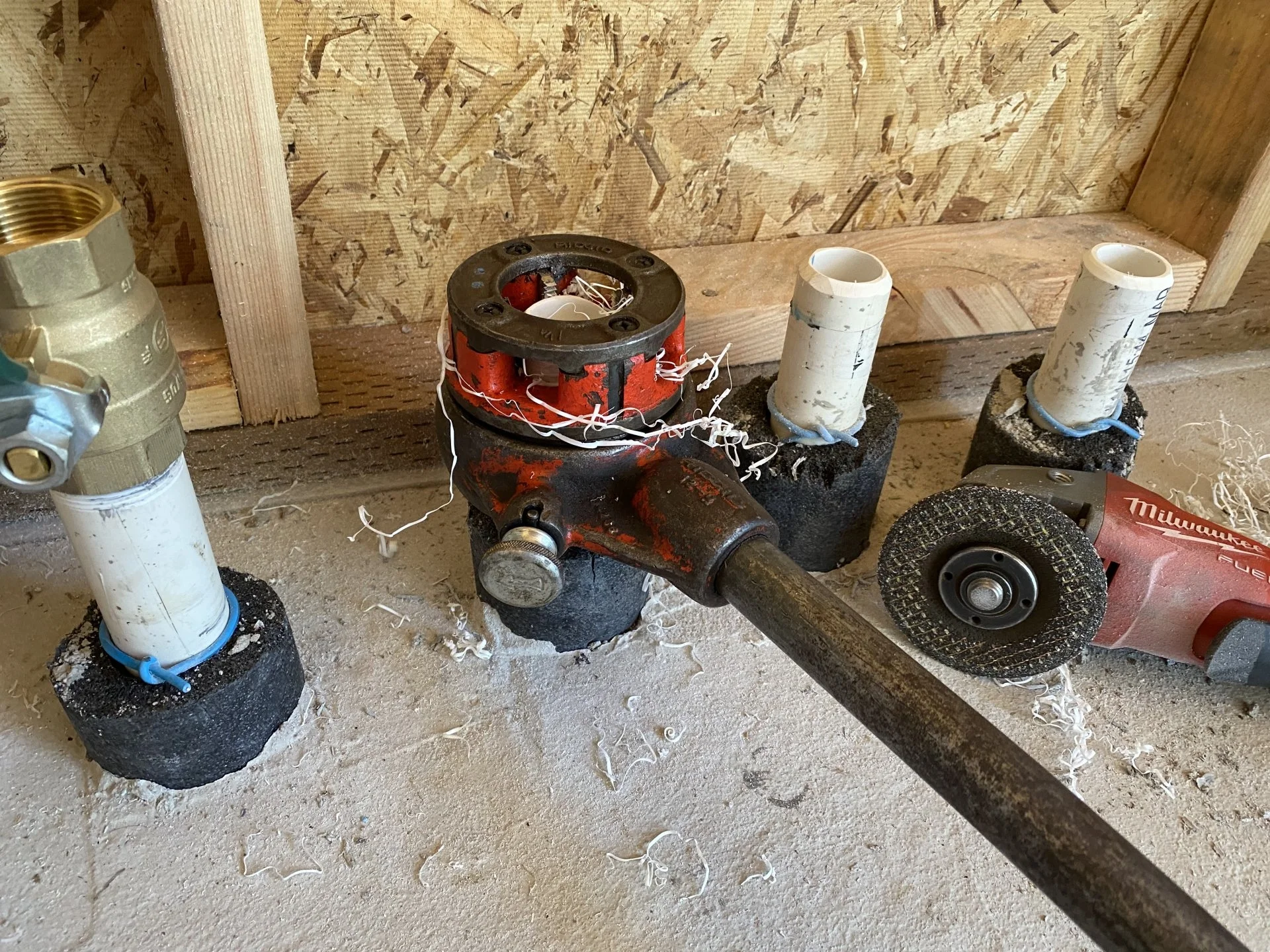

Cut and threading the 4 - 1-1/4” S80 PVC lines that go to each of the 4 lots.
After installing the valves I decided to install a cartridge filter housing. I wanted a 20” bag filter housing but forgot it at work. Turned on the well and had 75 psi with 2 sprinklers running. I am running the pump direct of the generator. I love these SQE Grundfos 2 wire pumps because they can run off 240v without a controller. Tomorrow I’ll wire in the CU-301 constant pressure controller.

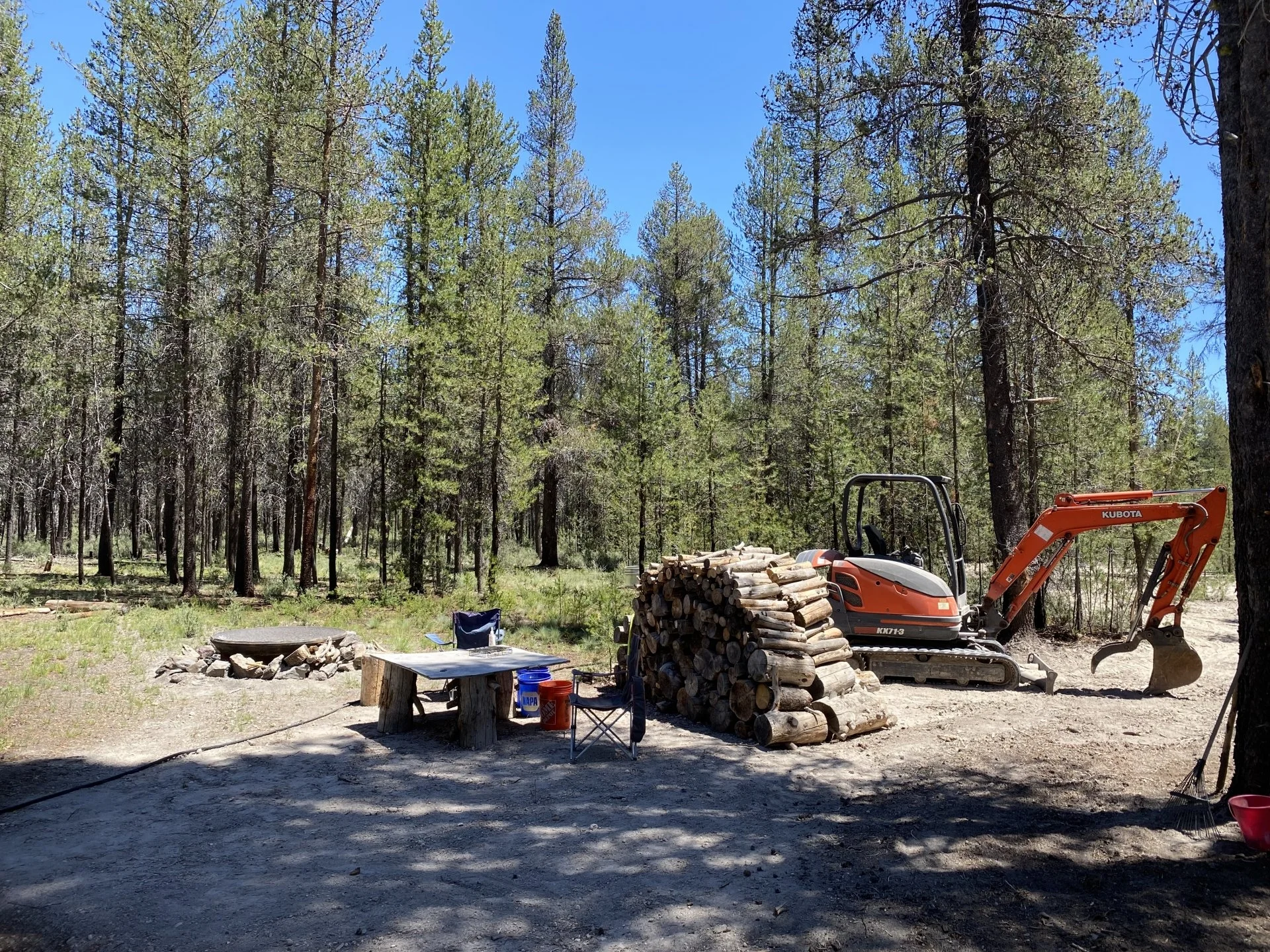

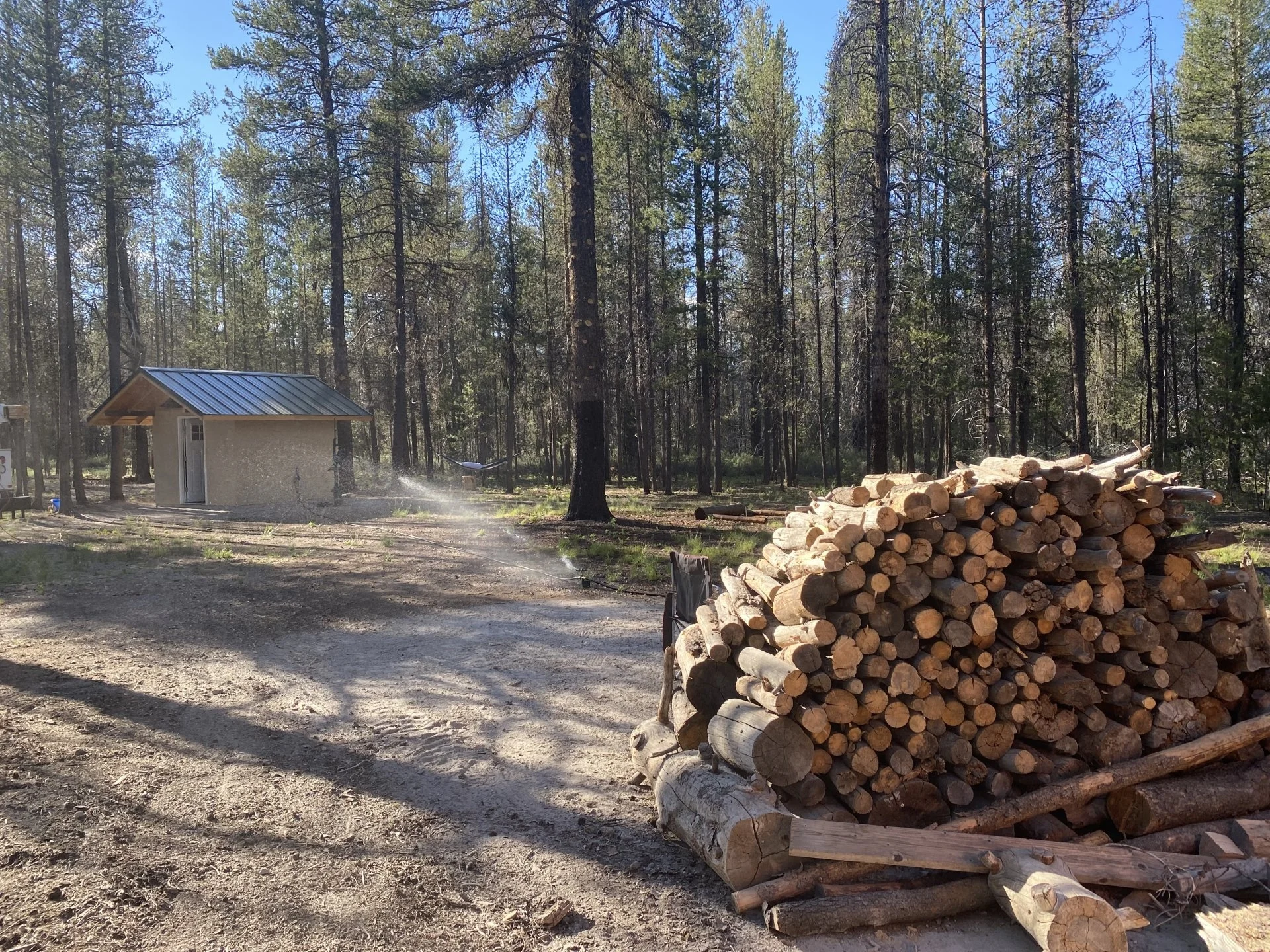

During the heat of the day I played on the mini excavator and cleaned up the piles of firewood.
Even out in the woods there’s nothing like the sound of sprinklers.

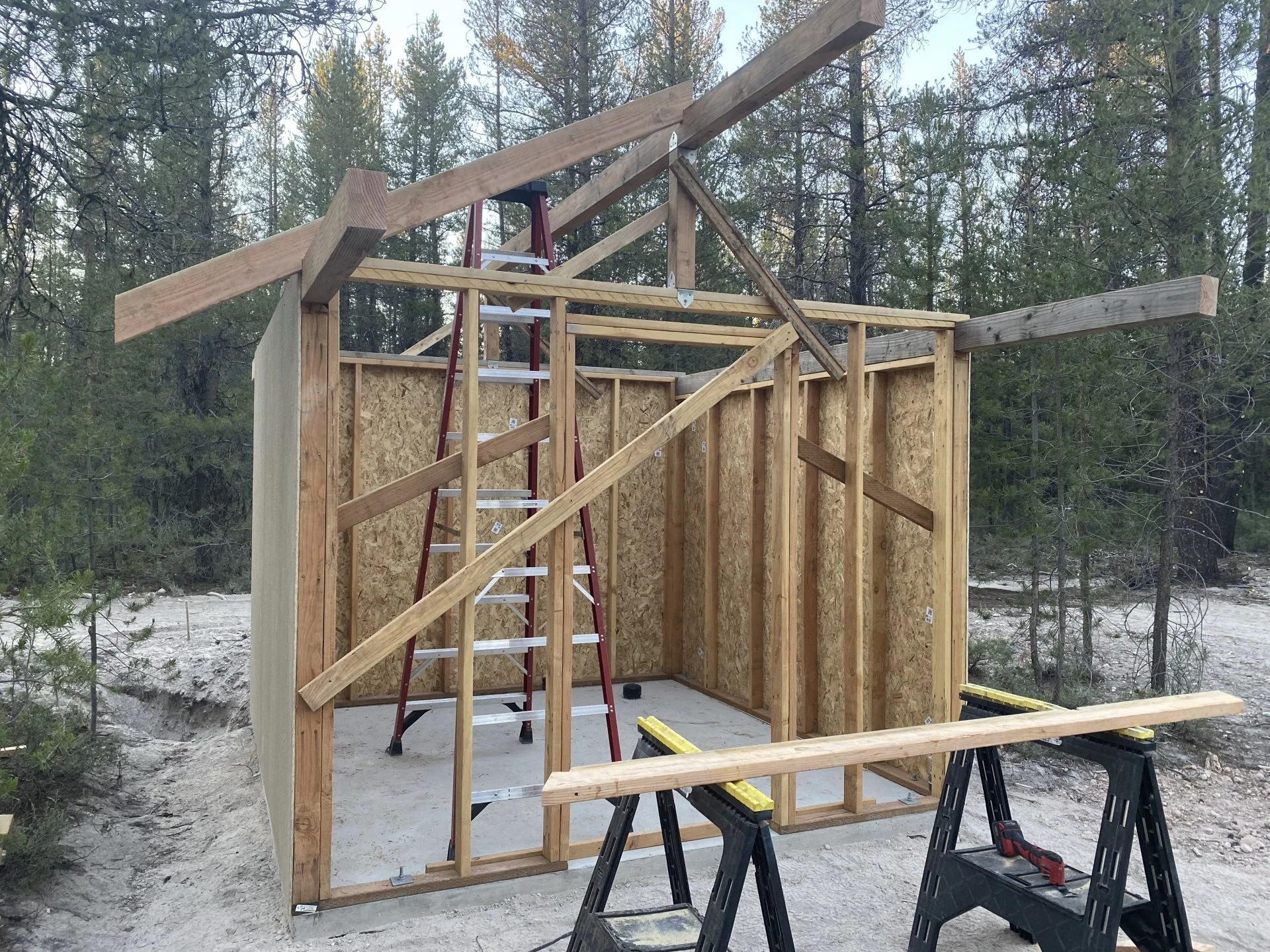

As the heat of the day passed and was shady and a bit cooler it was time to start hand cut rafters.
Mocking up my pattern rafter.
Quickly knocked in 3 before it was time for dinner

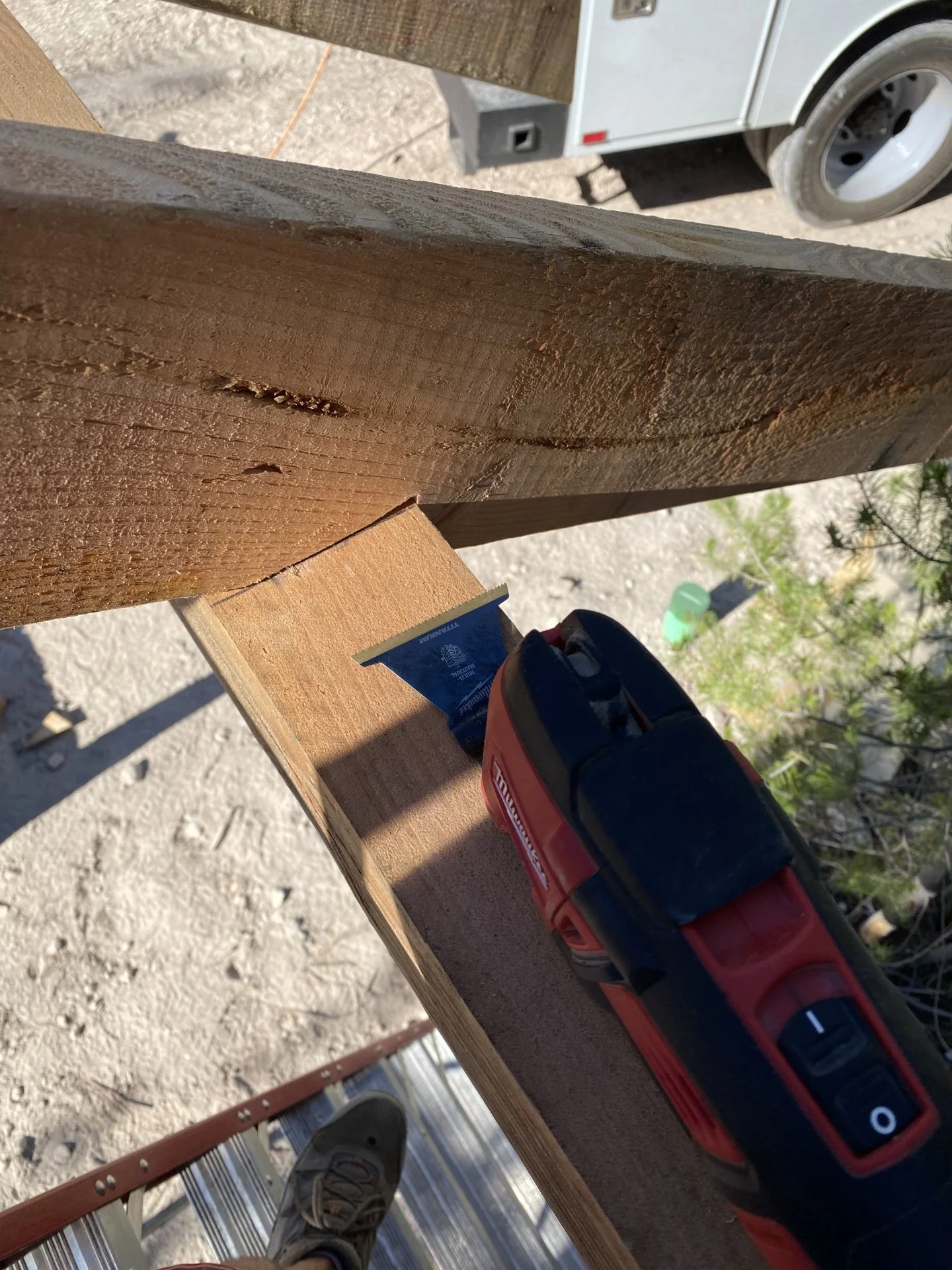

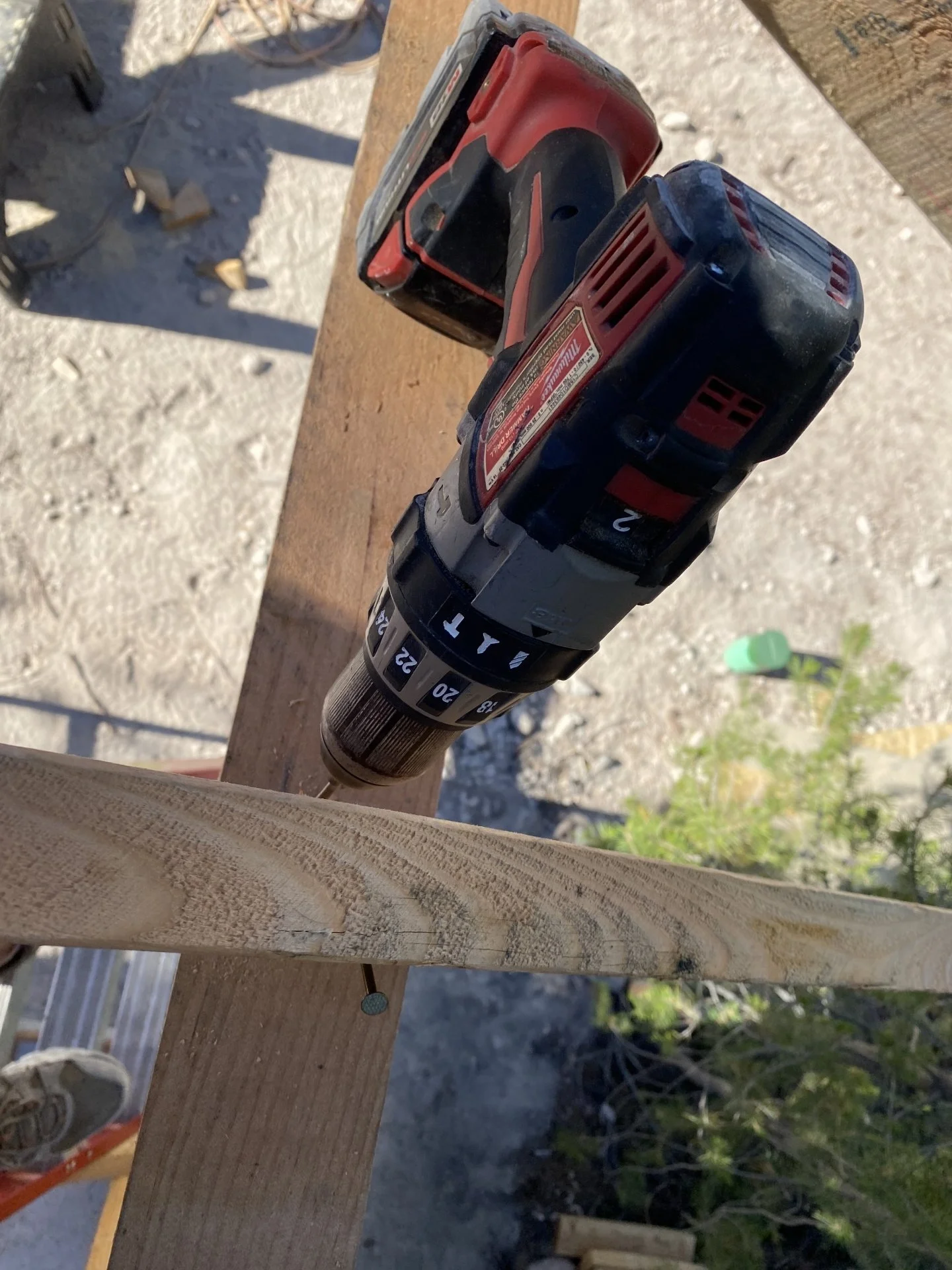

The full moon was amazing to see last night. Got up about 4am and had light breakfast before hand cutting more rafters. It’s amazing when I got the lumber in April it was wet enough that the lumber didn’t split… well it tends to split easy now. One split birds mouth notch and decided to pre drill the holes through the rafter to prevent more splitting. Worked great.
I know they say, “Diamonds 💎 are a women’s best friend”… well a fine tool is man’s best friend!
I ordered 4x6x16 Doug Fir beans but was delivered 18’ for the same price. Not bad but I only had 2 of the 6 that were straight. Working with twisted lumber especially beams sucks because there’s not a lot to do. That’s where the fine tool came in super handy on the birds mouth cuts.

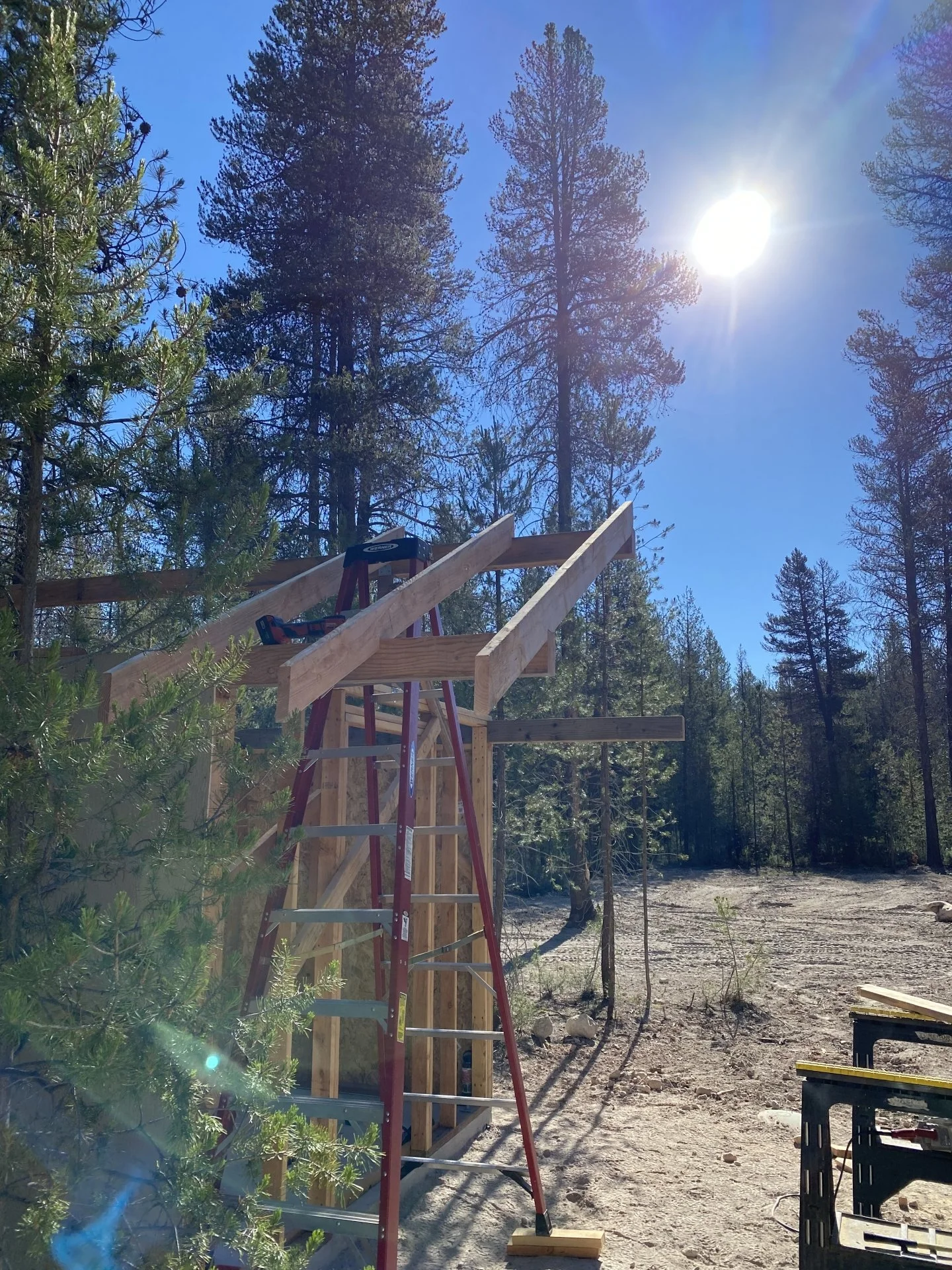

Fiddler on the roof in the hot sun already… it’s not even 8am…
But that summer sun is blazing hot 🥵

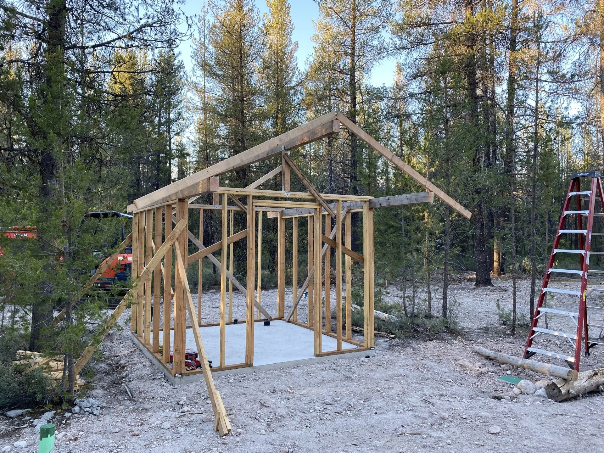

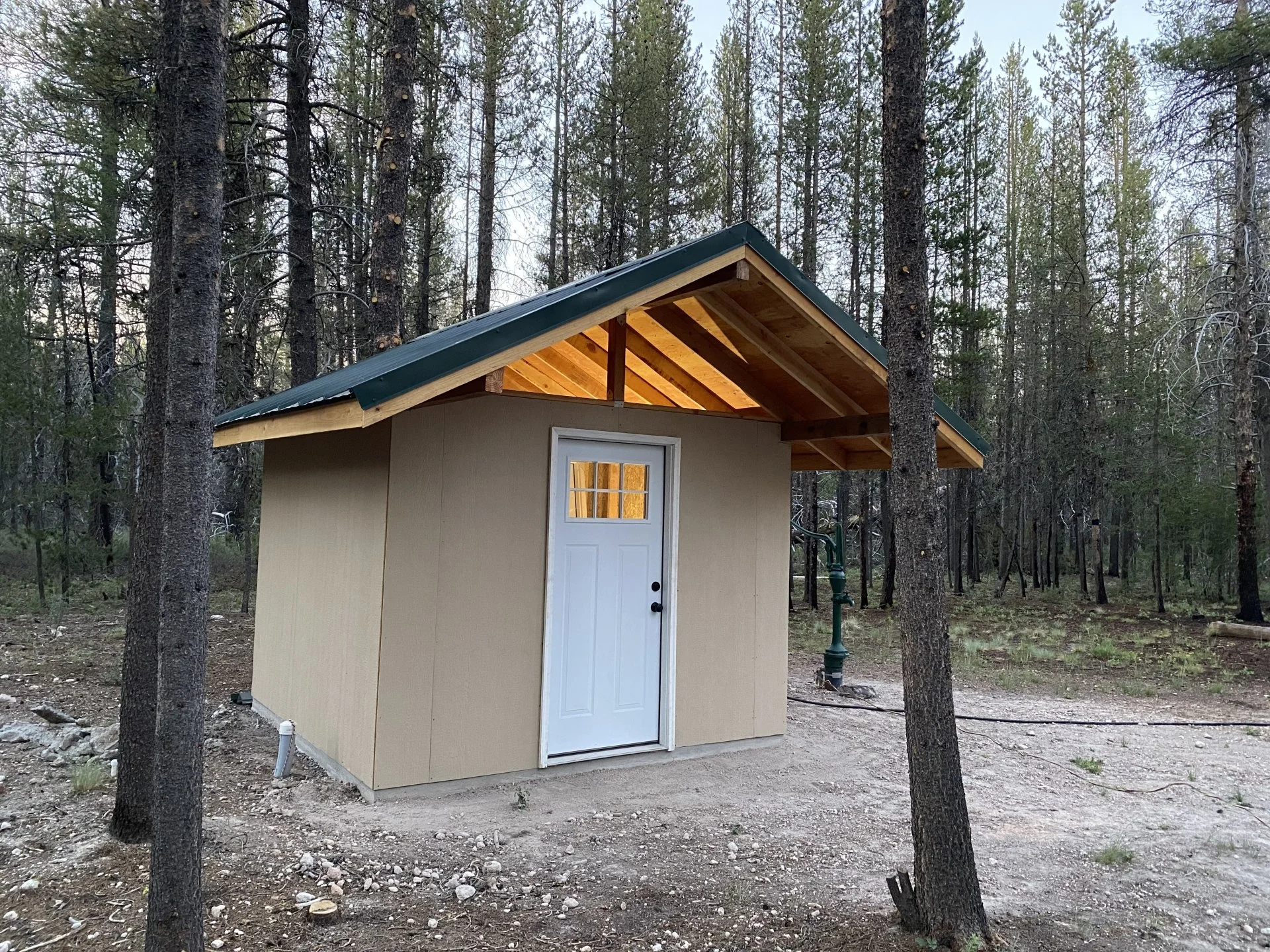

Knocked out all the west side rafters and started working on wiring in my pump controller in the pumphouse where it was much cooler.
