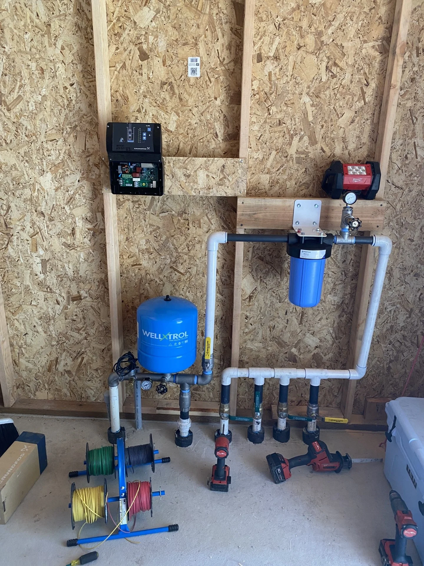

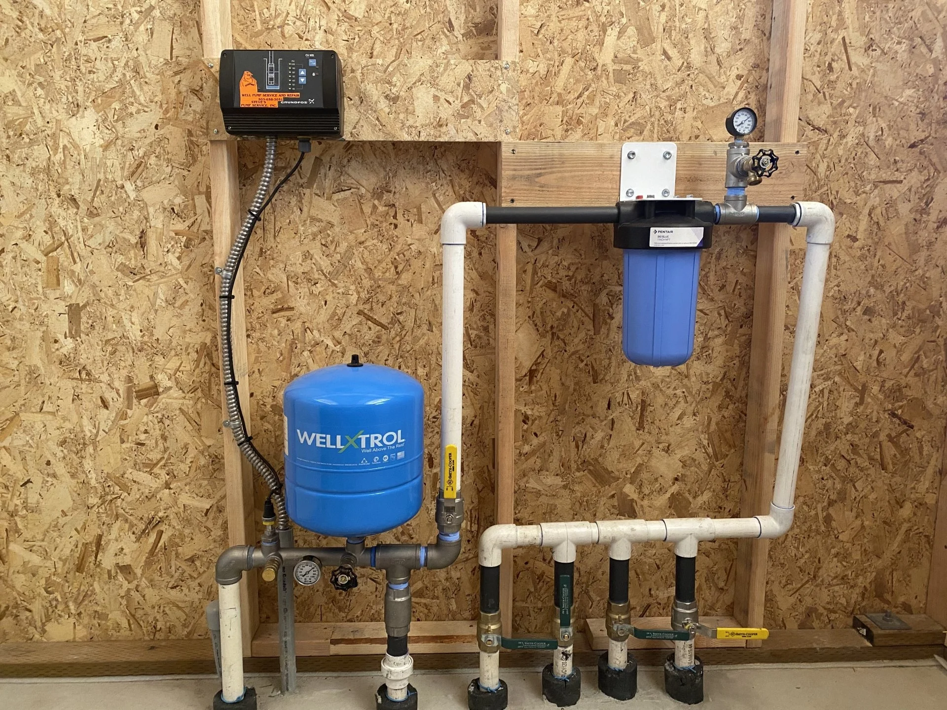

Got this CU-301 Constant Pressure Control from a pump replacement job. It was new 2009. Decided to save some money and see how it works.
Pulling wire between the well and pumphouse.
All done and set pressure to 70 psi.

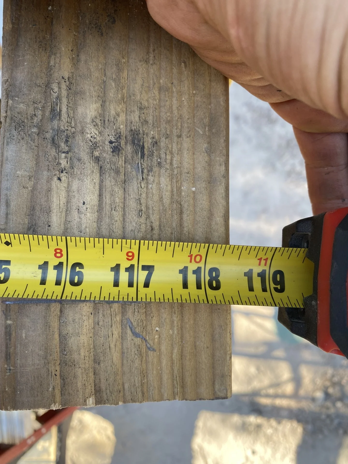

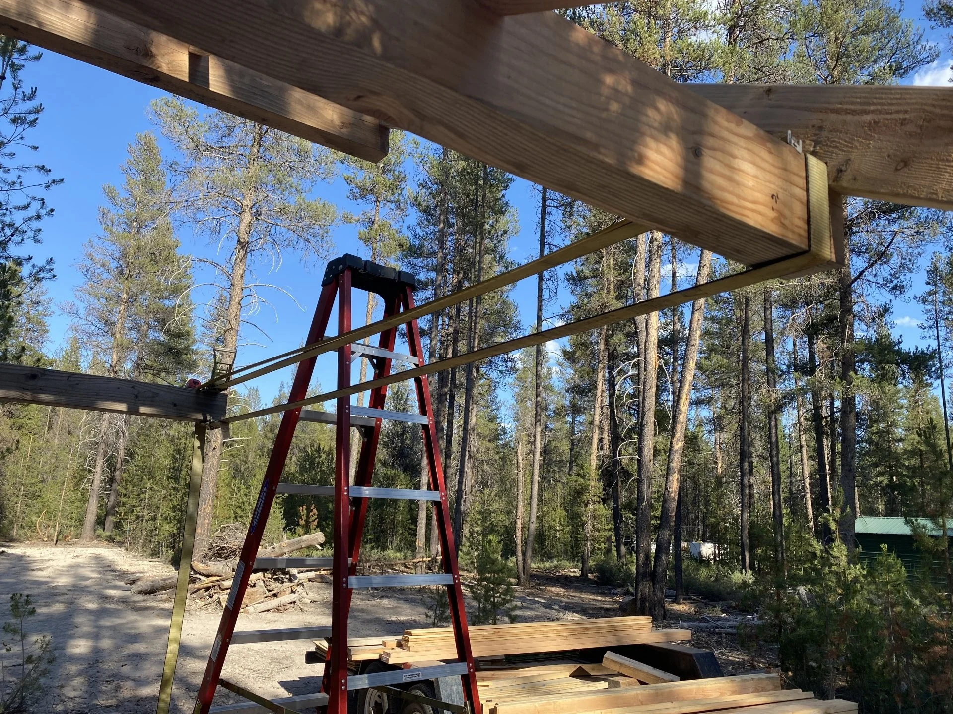

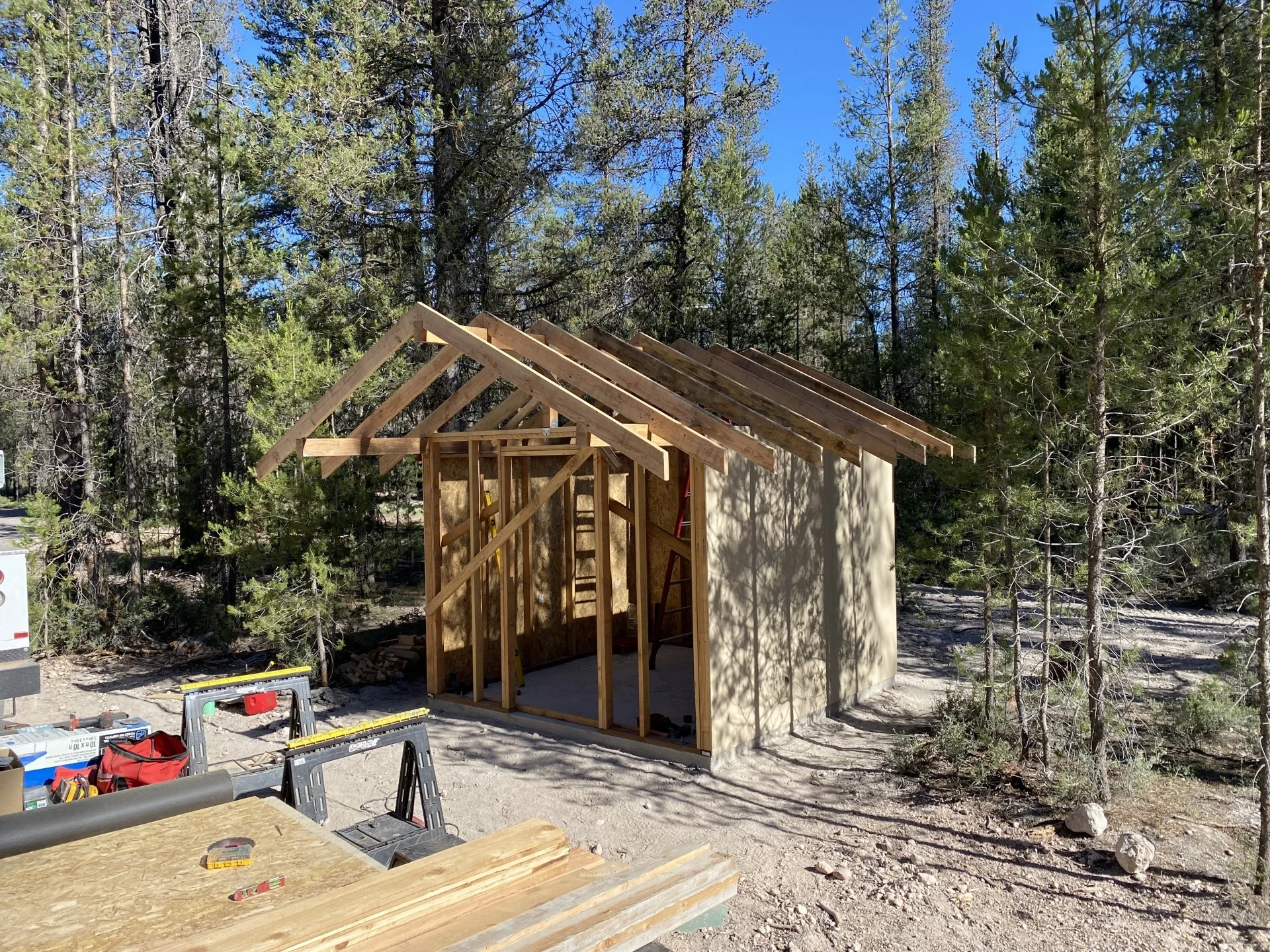

Got back as the heat of the day was gone. Started working on the east side hand cut rafters. One dilemma was the end of my 4’ overhang was kicked out a 1/2” @ 118.5”
Thankfully I had one of our long ratchet straps and was able to tighten it back to 118”.

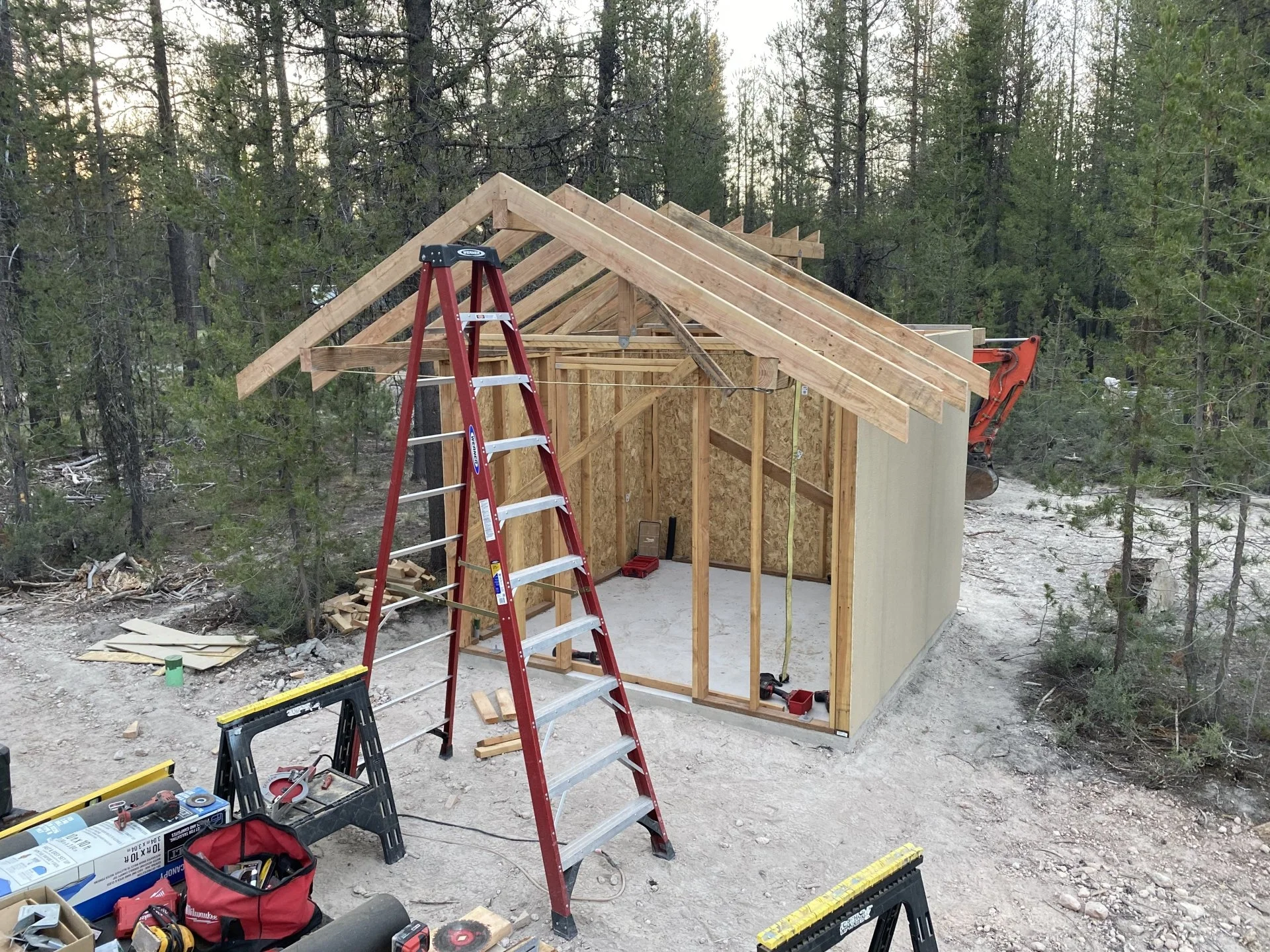

Was able to install about half of the rafters before calling it quits for the night.
I really loved working on the first structure in the cold and snow, totally opposite conditions now. Even the lumber behaves differently. Pilot drilling is a must to prevent the sinkers from blowing out the lumber. The lumber was green on the first one which made nailing so much faster. Hope to finish the rafters in the morning and maybe start sheeting before the heat is on again!🤨

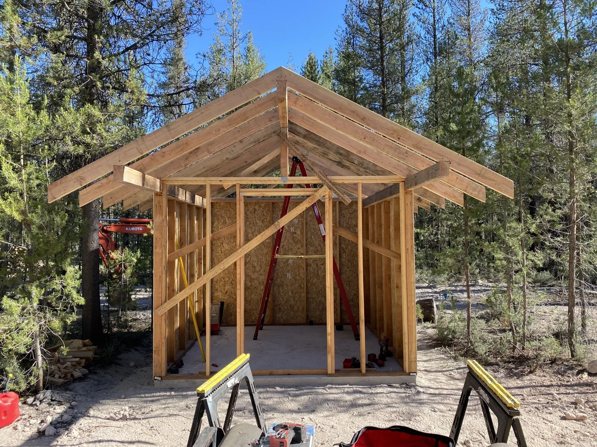

Had my rafter pattern and busted up tracing and cutting the rafters which makes quick work when the lumber is square. Could feel the heat from the sun and was glad I have some brief morning shade. The late afternoon is best but it’s still so damn hot. 🤨
Got all the rafters installed and now it’s time for blocking. I wish I had my compound miter saw😕

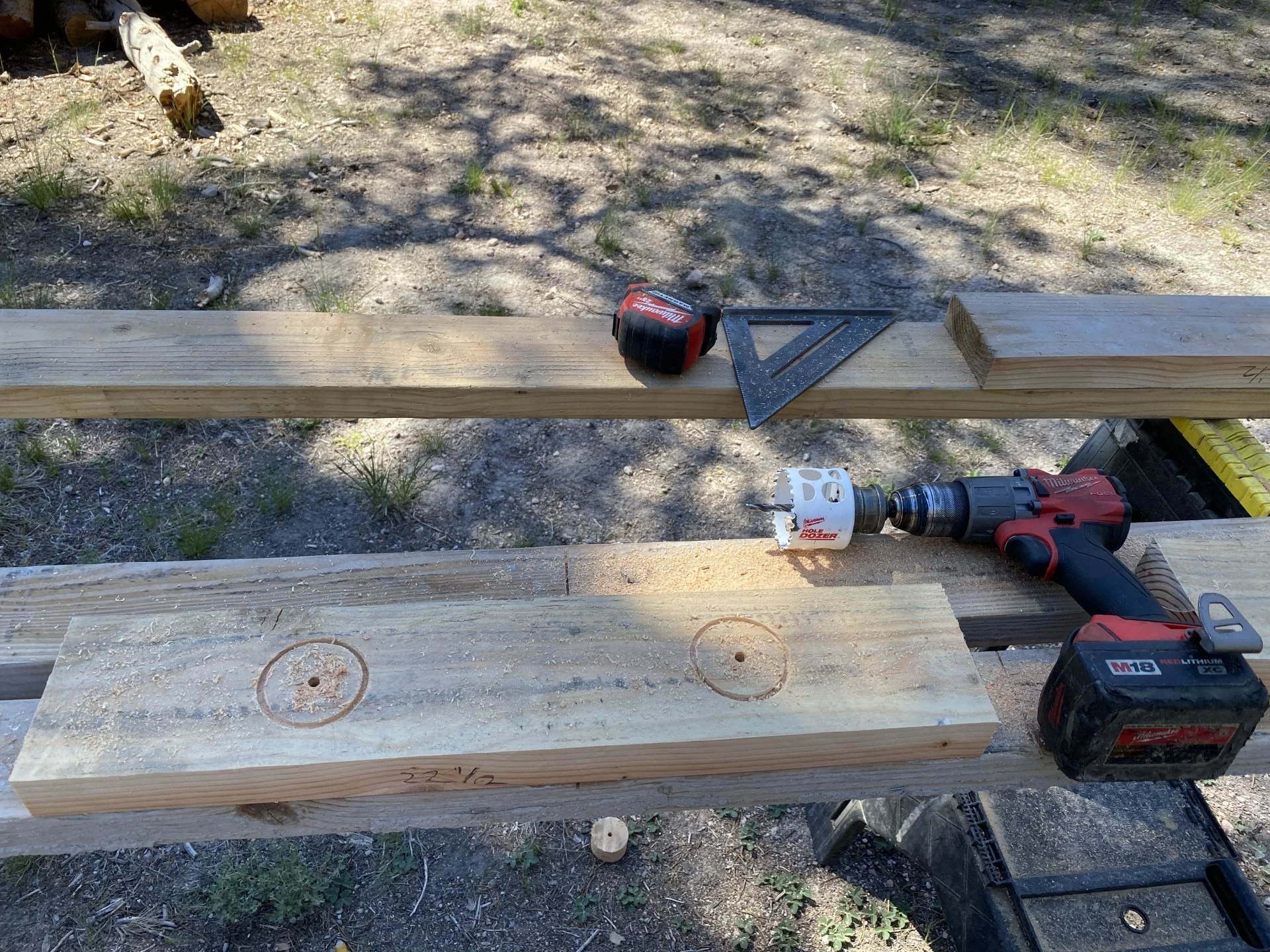

Hot already so moved work area to the shade. Blocking begins with ripping 2x6 down to 4.5” wide.
Drilling vent holes in the blocking for air flow.
