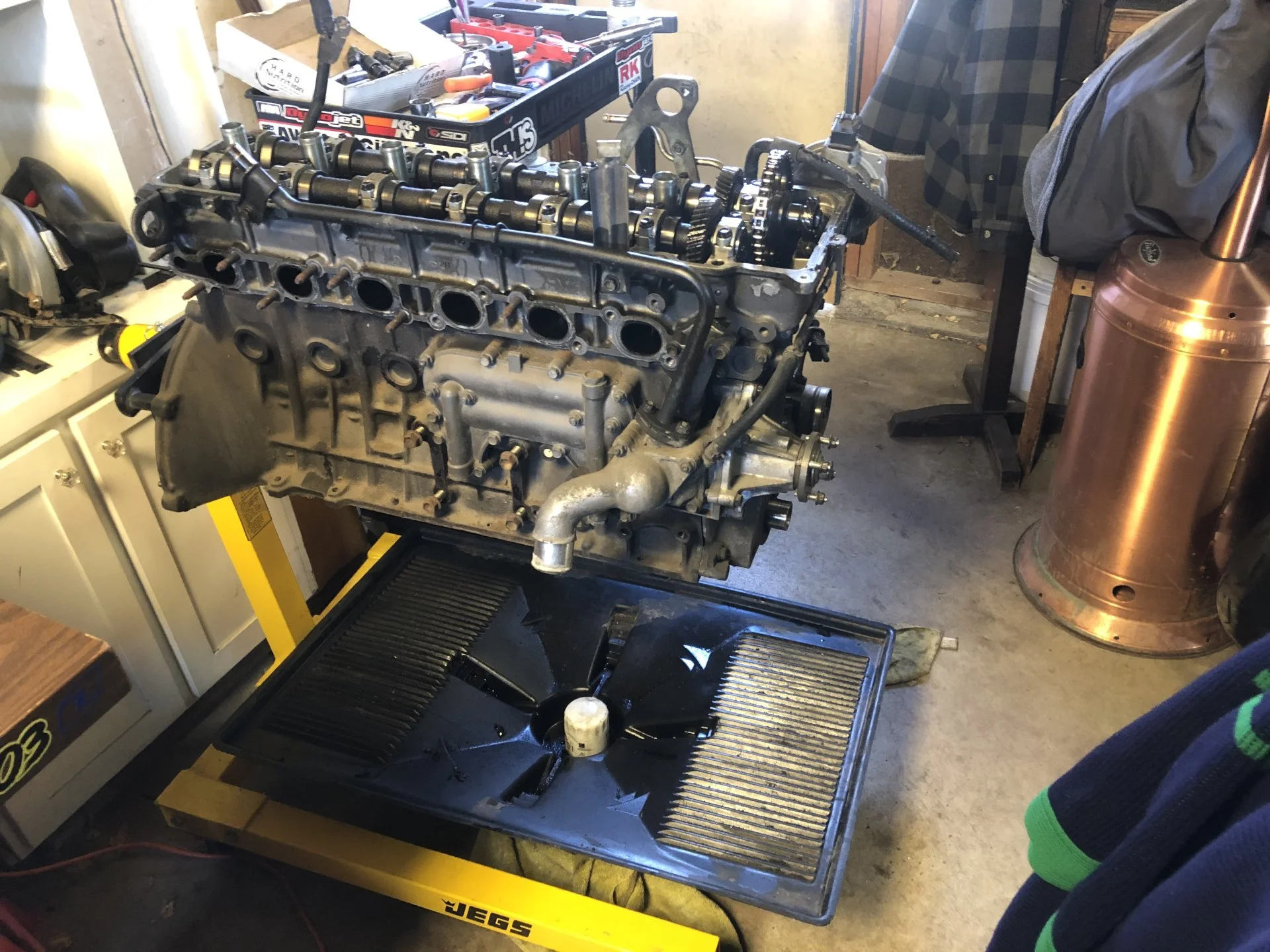

I’m getting my ass kicked still while tearing down the parts motor I have. Bar methods have resulted in stoppage as the bolts on the engine stand started to bend! Going to spray it down and heat it up for my next round at it.
Tools great nice work!
Try a torch on the edge of the bolt where the washer is. For about 60 seconds then try to crack it loose.
Heat can ruin the rubber in the harmonic balancer. If your using the tool correctly there should not be pressure on the engine stand bolts.
I had a breaker bar in the tool to under my frt bumper and a breaker bar on the bolt and I can see it breaking off the engine stand head bolts before braking this bolt loose. Stopped before it got worse and I did that. Not sure what proper use will be.
Doing it that way the down force is try to pull the motor off the stand.
Try putting a cheater bar on the beaker bar holding the pulley in place down to the base of the engine stand.

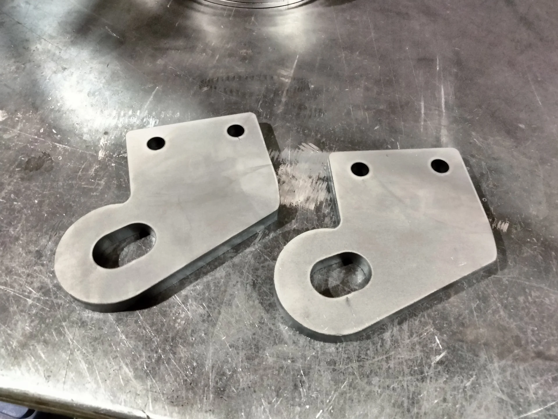

Laser cut these today boys, won't be long now. Gotta get them in the mill to radius them (tooling on it's way), then get them in the brake, then powder coated for those who ordered that option.

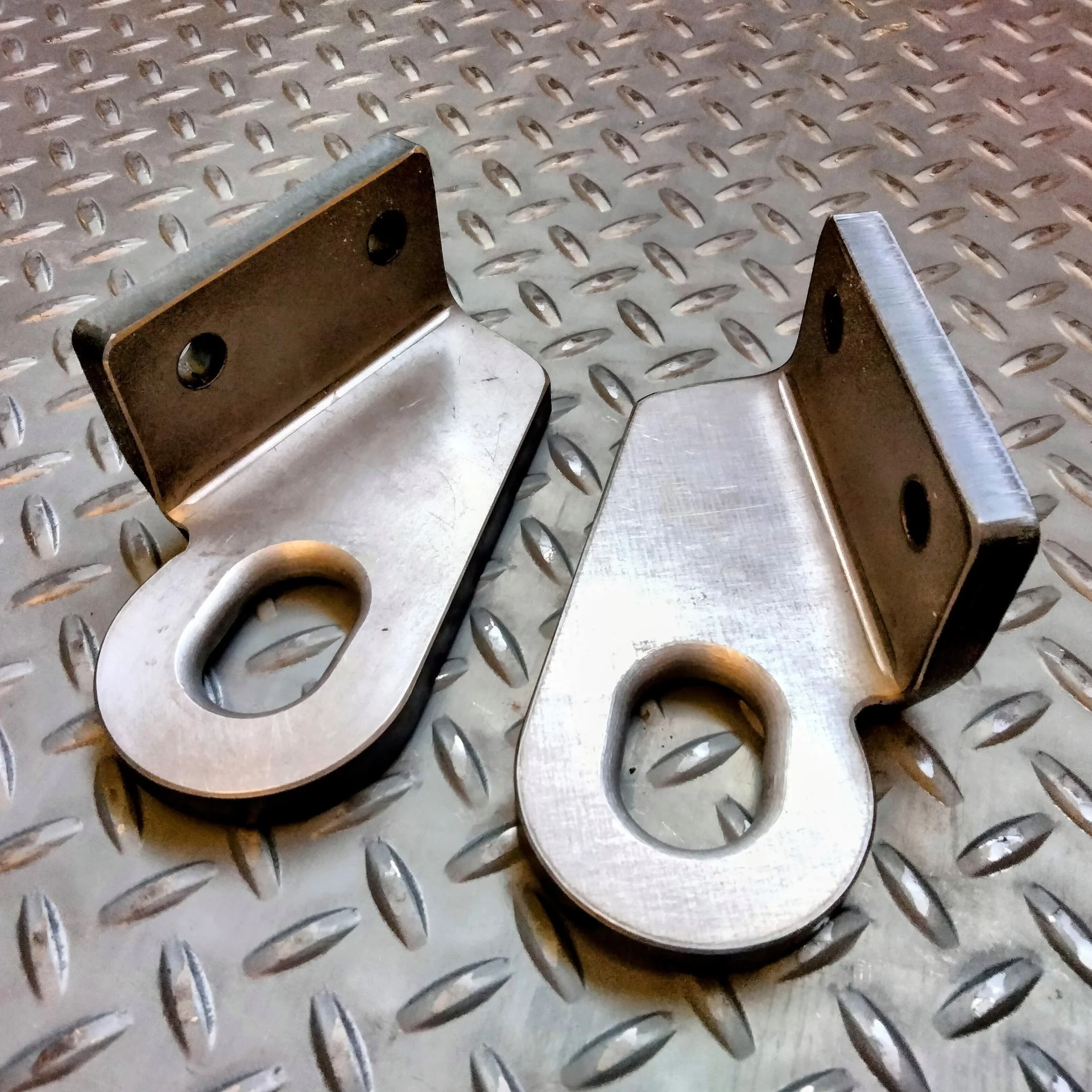

Bare metal orders should ship out mid next week. The shop is really busy so my personal stuff gets shoved unfortunately. Just wanted to let you guys know they're coming!

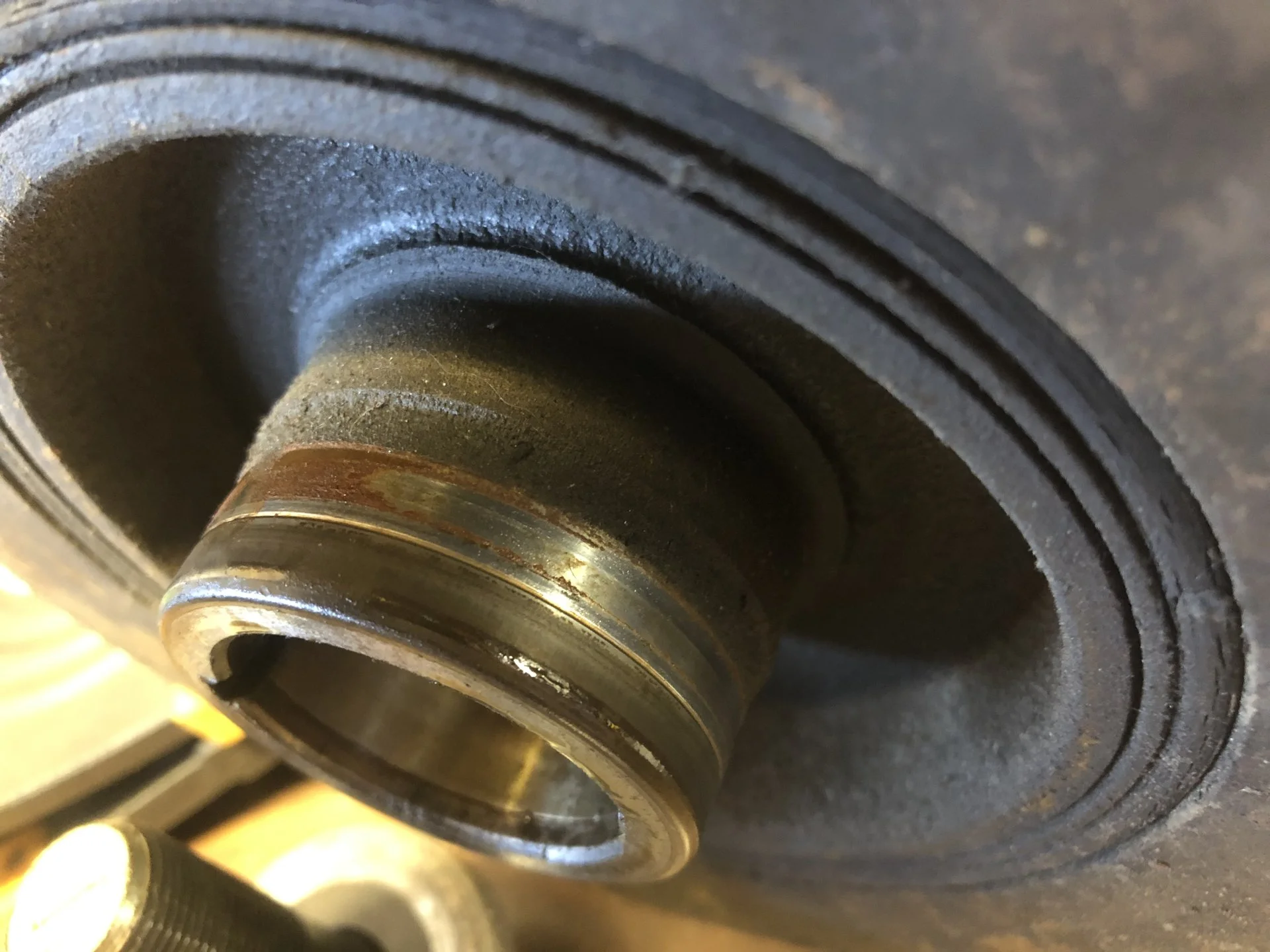

Bit tight on space but I moved stuff around to do that. Thanks man! Unfortunately mines grooved pretty bad too. I’ll be ordering one as well.

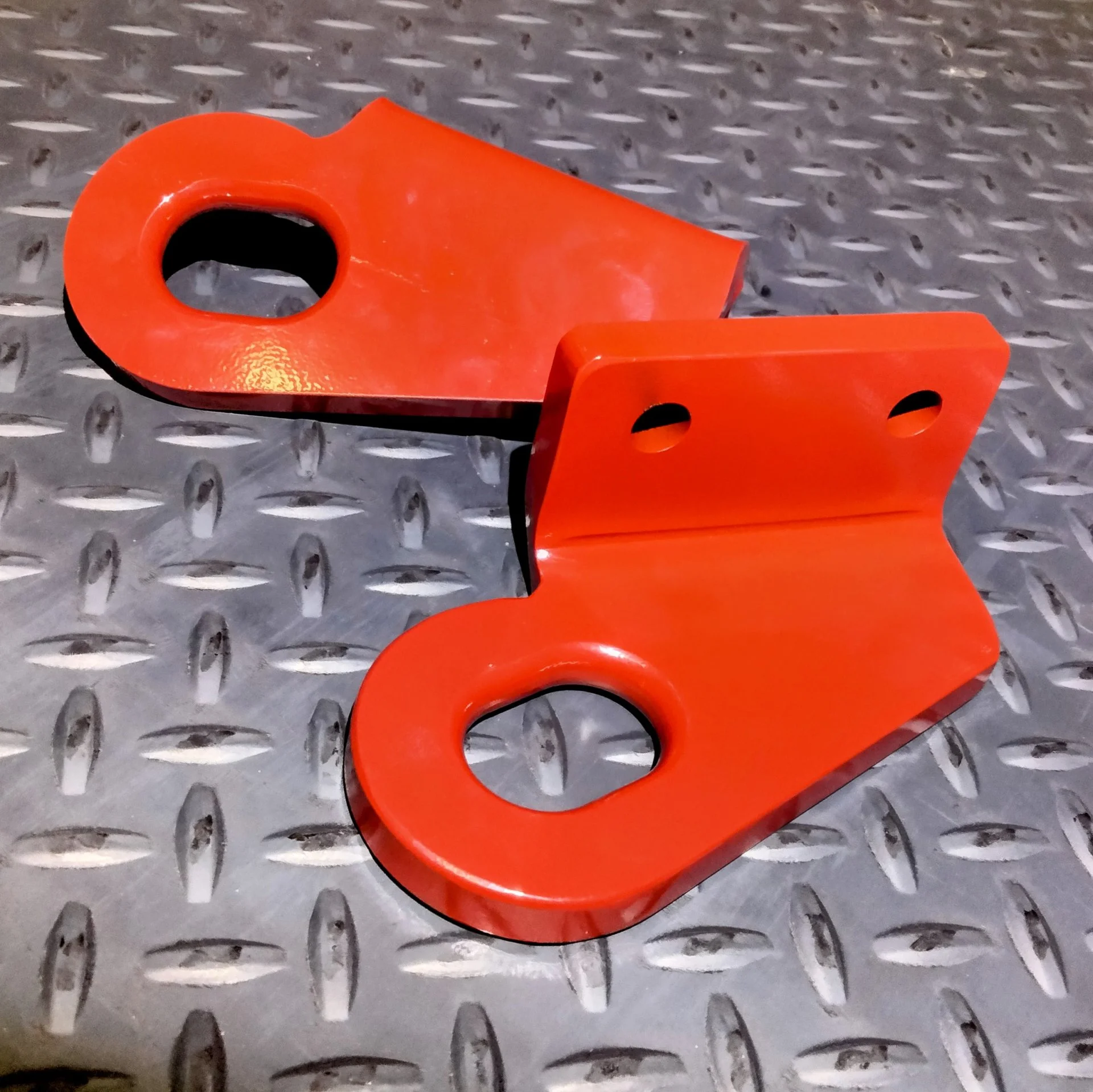

These bad boys are STOUT. Other brands are made from 10mm (a bit over 3/8)... These 1/2 behemoths are recovery points on roids. 💪🏻🤠
