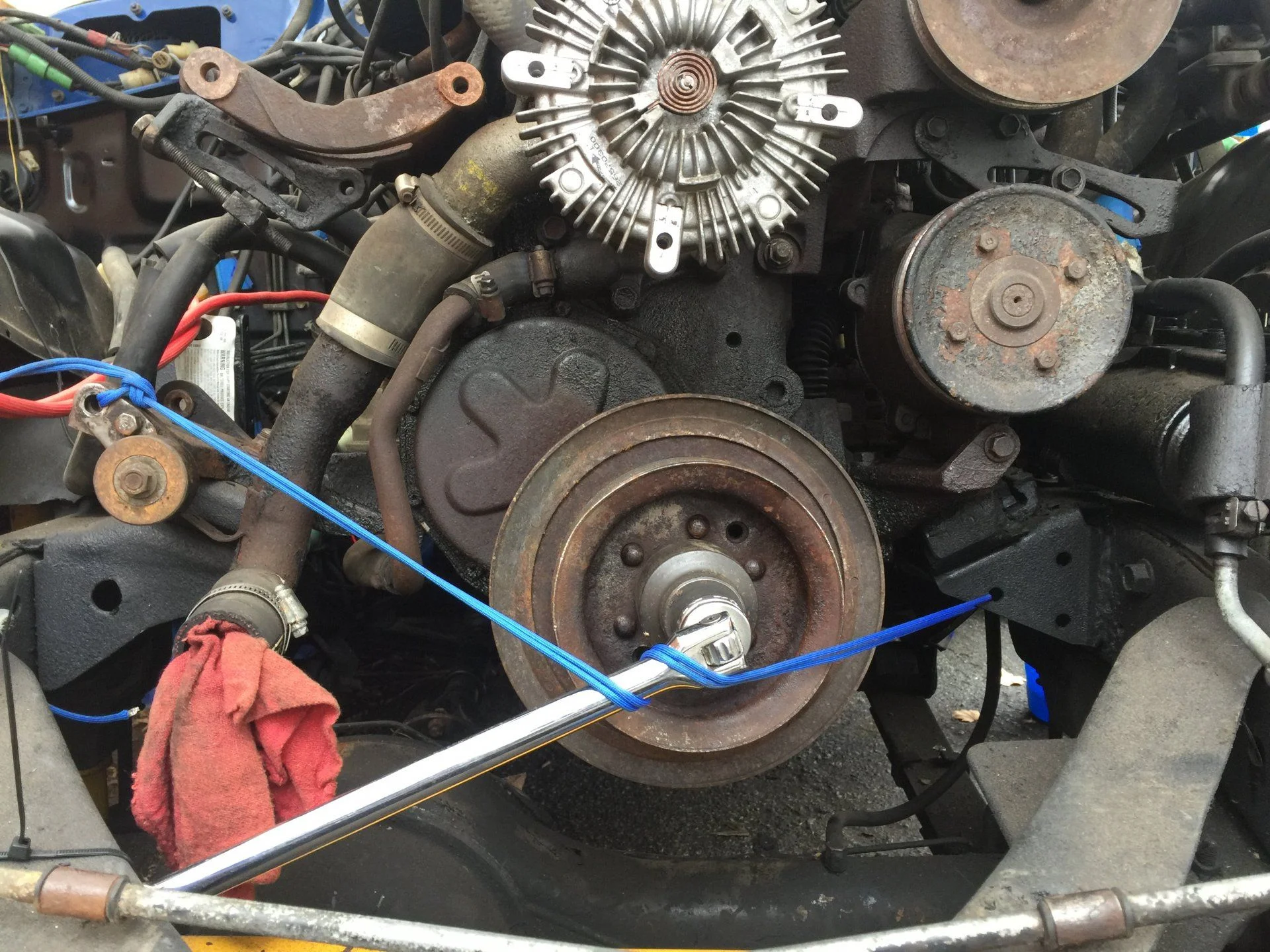

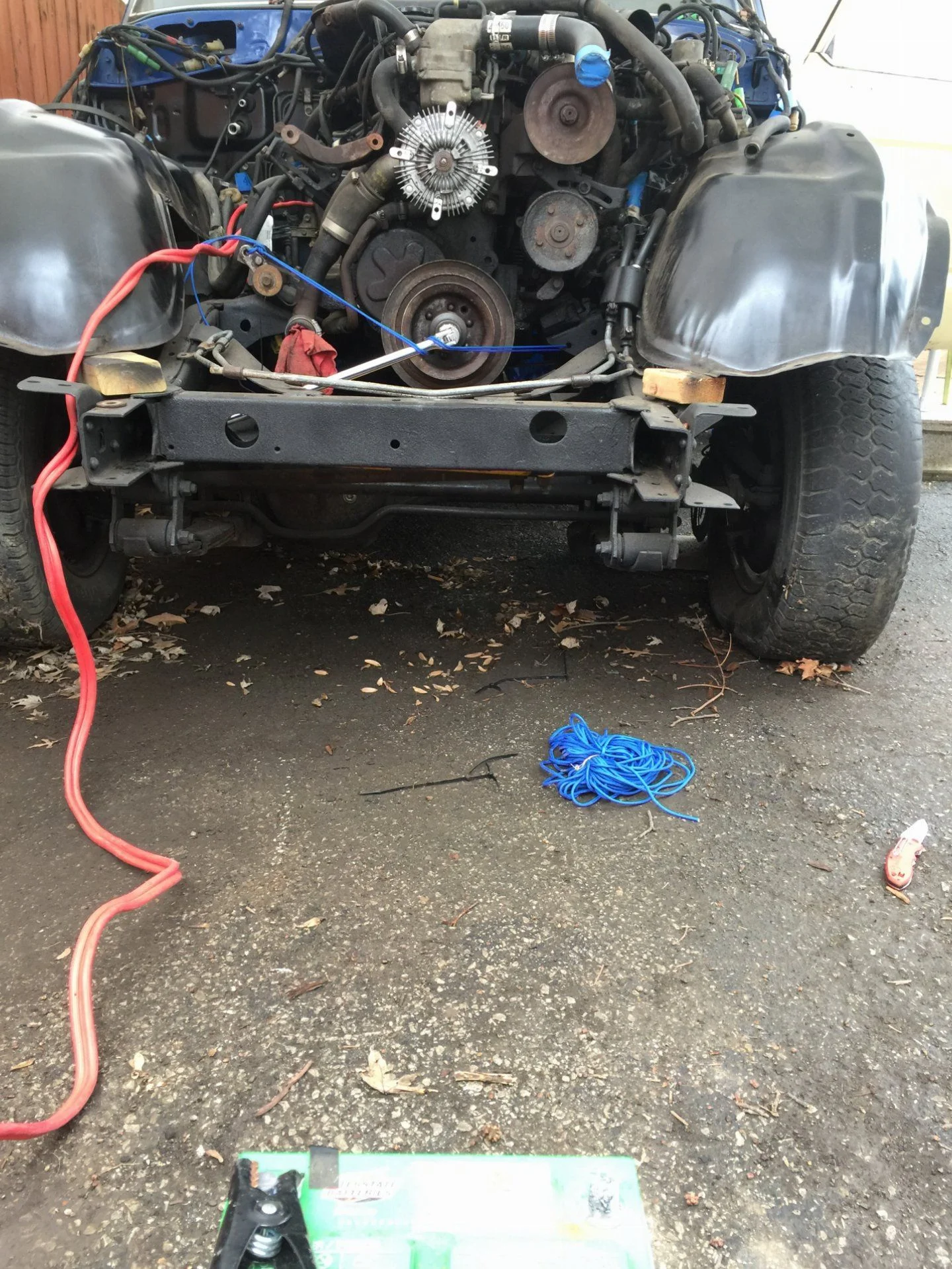

Starter bump didn't work. 4 attempts. Am I doing something wrong?
1. Hook up starter to battery. It is working and engaging flywheel.
2. Socket to nut breaker bar strapped to frame.
3. Bump starter - 4 tries. Everything holds and engine jumps under stress. Nut does not move.
I'll post pic after I figure out how to do it from my phone.
The engine moving parts need to generate a little inertia before being abruptly stopped by the wrench. If there's a way you can brace the socket & wrench to be pressed into the crank nut, to allow the breaker bar handle to swing before hitting the frame, that may do it. That's what worked for me.
has your battery been charged recently?
as well, not sure if it really matters, but I put my handle on top of drivers side...
