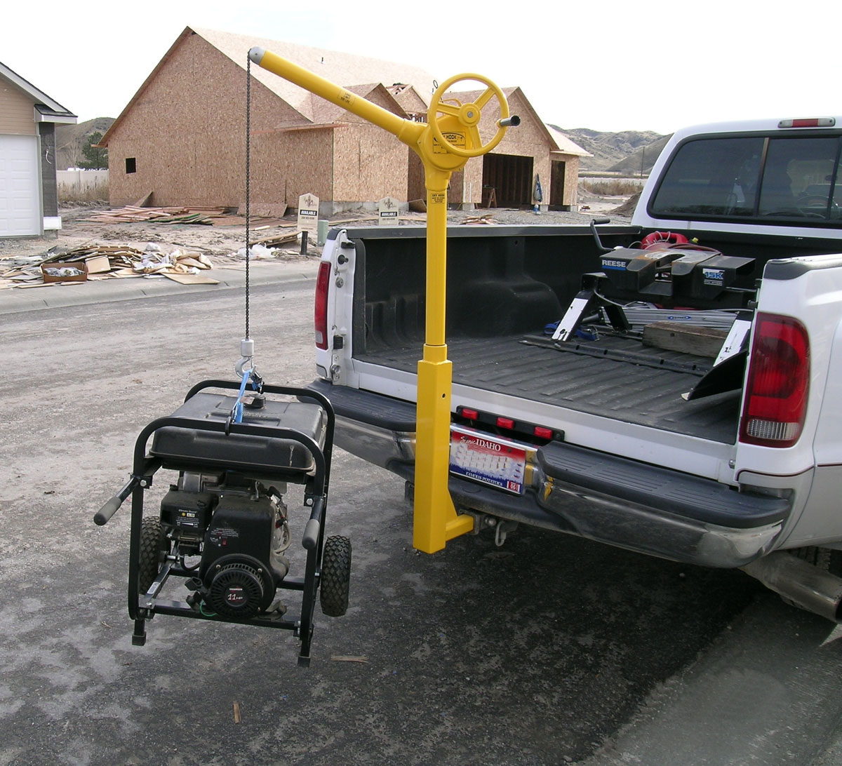

I've been consiudering designing a reciever hitch mounted crane to lift my RTT on and off my 80, could also be used for the M101.
It would be similar to this, but of course would have to be high enough to clear the roof line with room to hoist the tent.

I had the same thought and after doing lots of research came across this skyhook product that would fit my needs.
http://www.skyhook.cc/skyhook_brochure_pdf.pdf
I don't know what the cost would be but it is light and you could weld on a 2" receiver wherever you wanted it to mount.
Chris
I have the red receiver mounted on from above. It is HEAVY and a huge PITA to get it slid into a receiver hitch. Once it is there, it is a dream come true. I'd just back up to an engine, throw a strap on it and crank it up, give it a whirl and lower it down without breaking a sweat... until its time to take it off the truck! Not bad for $189 shipped though.
If you wanted to make it have an alternate base, there is a round base which it rotates in. It has a race in it and the top half has a tapered roller bearing on it. You could just fab up another base with a second race. The only downside is that it gets grease everywhere if you separate the two.
Oh yeah, and the cable comes off the back pulley every now and then and jams up. Two 3/4 wrenches and some disassembly, and you are back in business.

The SkyHook is really nice and I'd really like to have one. A little out of my budget right now, but a good choice to have in this thread as it's actually the most suitable. I really like how it weighs 23 lbs, making it easy to move to a different mount.

Hi, Wondering on the skyhook truck receiver mount , what is the gear ratio ? Thanks, Mike
Mike,
Lit doesn't specify that, but indicates that one rotation of the crank wheel yields 1" of lift.
