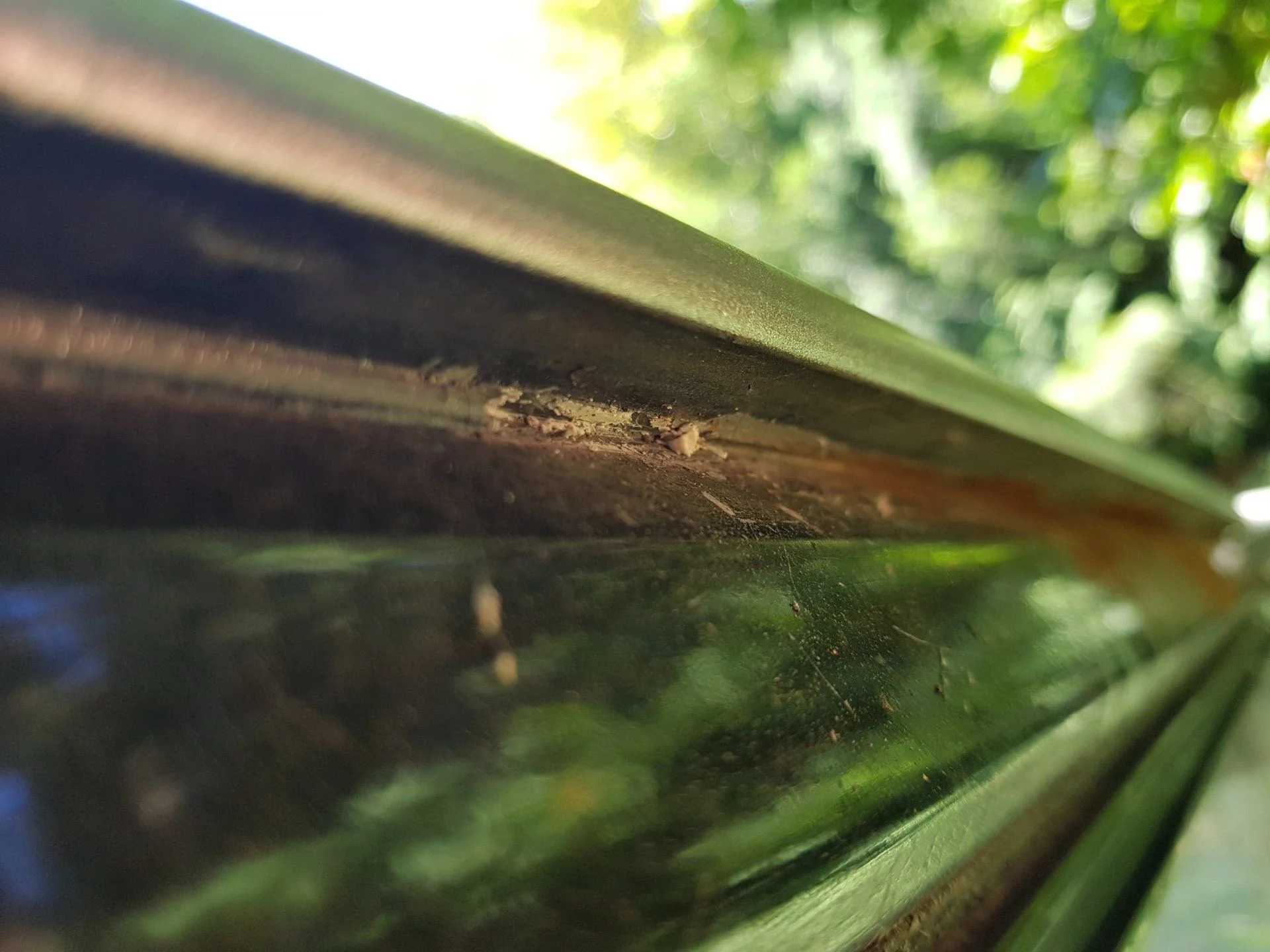

My FJ62 is developing cracks in the seam sealer along the gutters. I have seen some trucks with serious rust damage because the owners neglected fixing the cracks. Mine is rust free and I intend to keep it that way. Ideally, I’m looking for something to hold me off until I have time to completely remove the old stuff and reapply new sealer (a very long time).
Does anybody have a good way of taking care of this without completely removing the old stuff?
I'm not aware of a way to do that. If you did, I think you'd be making the correct fix harder. It took me a day to get all the old stuff out with picks and wire wheels and to get the new stuff in. So, not really a huge project.
Eastwood sells seam sealer strips that you apply by hand. Consistency reminds me of old Silly Putty that we had as kids. They sell it by the pound pretty cheap. You just pull a strip off the paper (similar to tire plug strips) and press it into the areas you need it. I probably wouldnt leave it in long term, but could be a good temporary water tight seal until you have time to do it properly. As @chbrow10 said, I did both my roof gutters in a day the right way. Not a hard job, just tedious getting all the old stuff out and getting the surface prepped for the true seam sealer. I used the 2 part from 3m with the special applicator gun. It is self leveling and lays down nicely and pretty hard to mess up. Just take your time and learn the gun and how slow/fast you need to move along the gutter with it. YouTube has some very helpful videos on laying down seam sealer. Look up some from old hot rod body work guys, they do it right. Here’s the seam sealer strips Eastwood Flexible Strip Caulk Bk 2-lbs - https://www.eastwood.com/ew-flexible-strip-caulk-bk-2-lbs.html

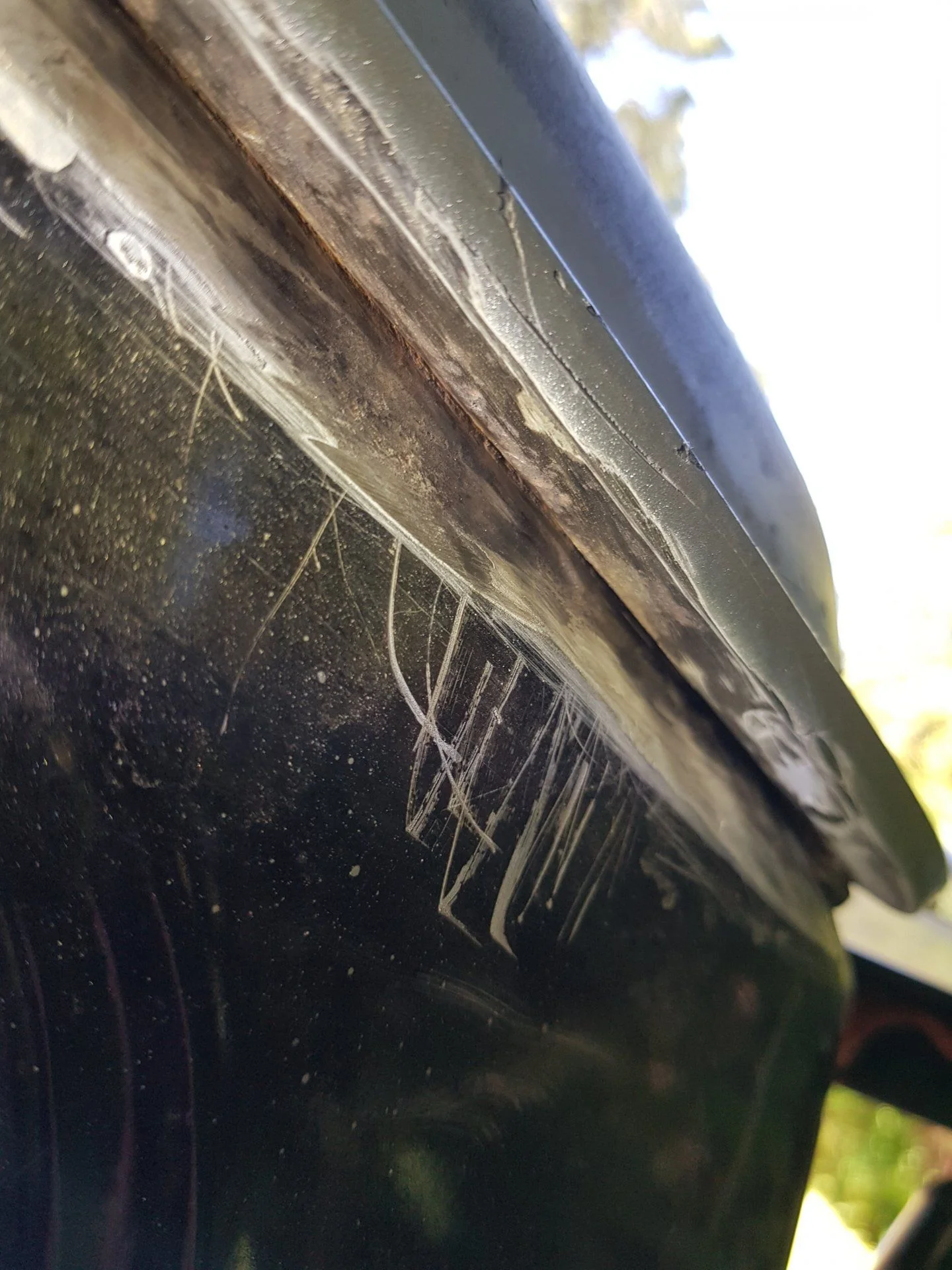

Mine has similar issues on the seam below the gutter to the body. Has anyone figured out how to grind/wheel that part? It’s such a tight area I’m having a tough time getting in there with dremmel
I used a sturdy razor blade and just thrashed the hell out of it. That seam is actually connected to inside. I sprayed Eastwood rust paint inside above the roof rail and it seeped outside a few places under the gutter. But this means you have to remove the headliner to get access, although you have a custom one so may be able to do this easier.
