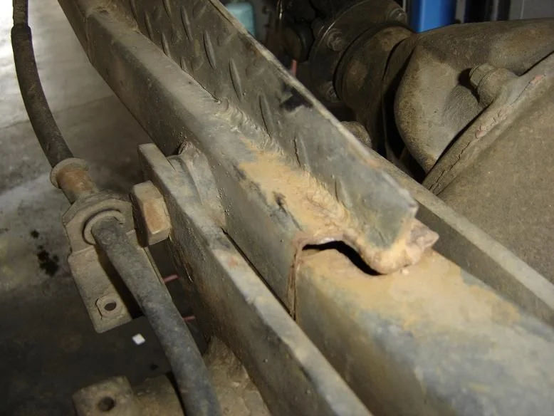

don't know how long this has been broke, but it will be repaired next week. ASAP!
i think the flaw is in the gusset not going past the rear bushing on the axle mount.
oh well :)

It is the failure of that crappy "diamond plate" that was used in this traction bar!

Daymmn--You need to find a good welder:flipoff2:.
Interesting it broke right at the stress riser at the end of the gussett. Post a pic of the fix, so we all can learn something.
Q:DWB.Needs more triangulation
i needed to extend the gusset all the way back past the end mount.
i may add some torsional gussets along the main one.
Q: josie (and the pussy cats):lol: It is the failure of that crappy "diamond plate" that was used in this traction bar!
nope, the lack of extending it. no welds were hurt in the breakage. :D

Q:CD. Daymmn--You need to find a good welder
YOU GOT THAT RIGHT! my welder has been pissing me off lately :doh:

Completely the wrong mindset :flipoff2:
Yep, failed at the stress riser caused by the gusset. You have plenty of room to plate the sides and reweld the tar out of it. You can also see how it failed right next to the weld, the material around the weld was made brittle because of the welding process.

What Material was that made of?
mine is 2x2 1/4" wall with no gusset.. but my bushings are not in line like that.. Thats alot of stress at that one point!
