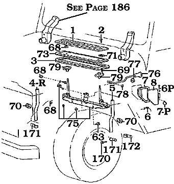

Bumping an old thread. I'm in the final stages of recreating the 55881-60010 cowl vent gasket but need some feed back from you guys, including @Coolerman and @Fast Eddy. There was an earlier comment that if the gasket is too thick it will block airflow. How much does the cowl move up and down? Is it better for the gasket to be on the thinner or thicker side? Does one side of the vent need a thicker gasket vs. the other, or are both sides the same? One of the photos I saw of the later gasket appears to be thicker on one side than the other. However, I'm aiming this gasket for the '72 and earlier cars that actually have a working vent.
Attached are some photos of what it looks like now. The thickness will be adjusted based on feedback. Thanks.

That's #3?
My oldest rig is a '76. It's all welded up inside, by Toyoda-san. What I would be interested in would be a top cover, #1, like SOR used to have that was all one piece, so water couldn't get inside.
Yes, this is #3.
It's kind of a bummer that you have a cowl vent that doesn't vent :(.
