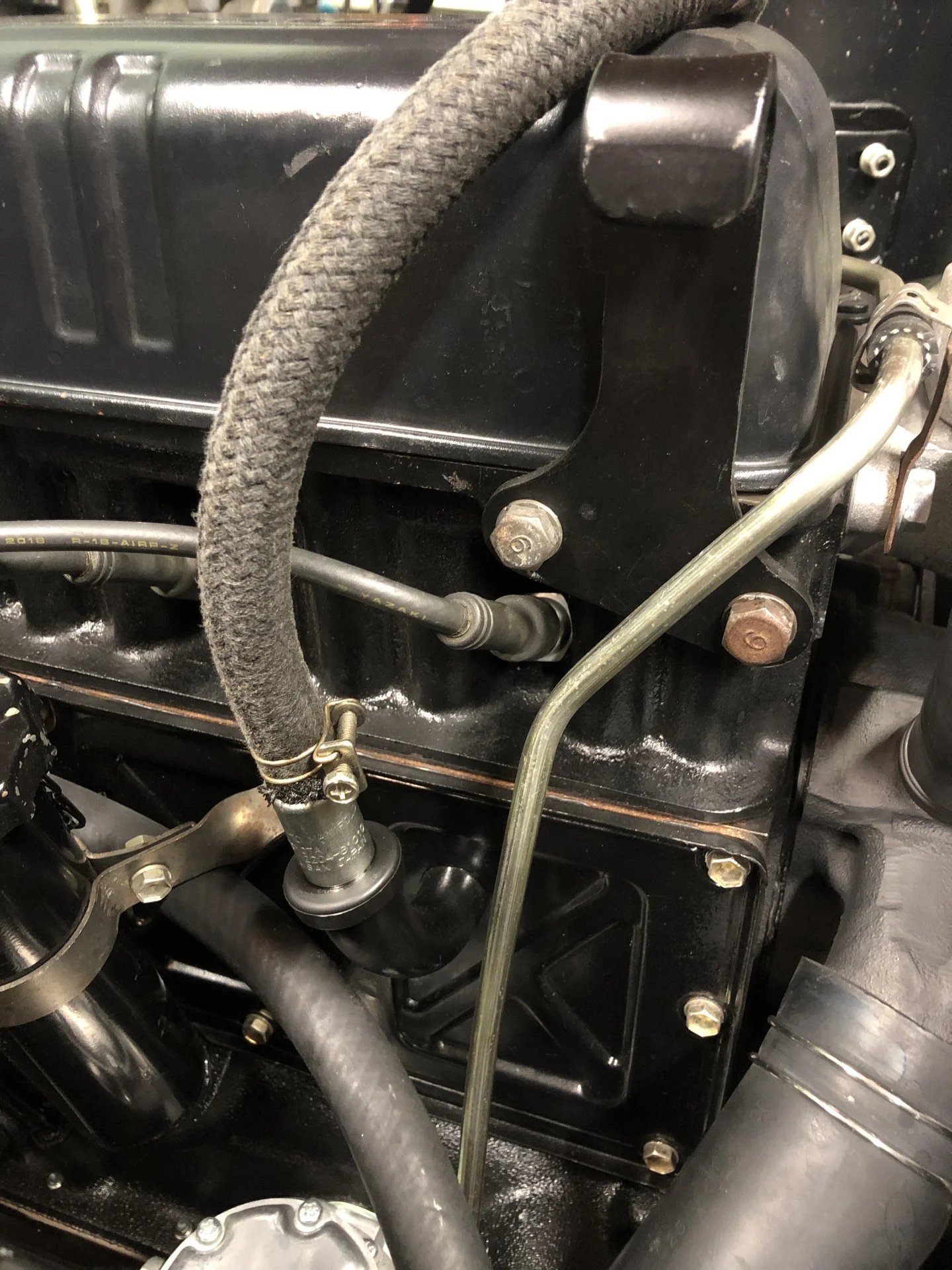

Currently, I'm running heater hose for our PCV valve hose. There are not any problems that I'm aware of but I suspect that this is the wrong material and the hose should be rated for fuel, possibly a light grey color that matches the air filter breather hose. Any recommendations?

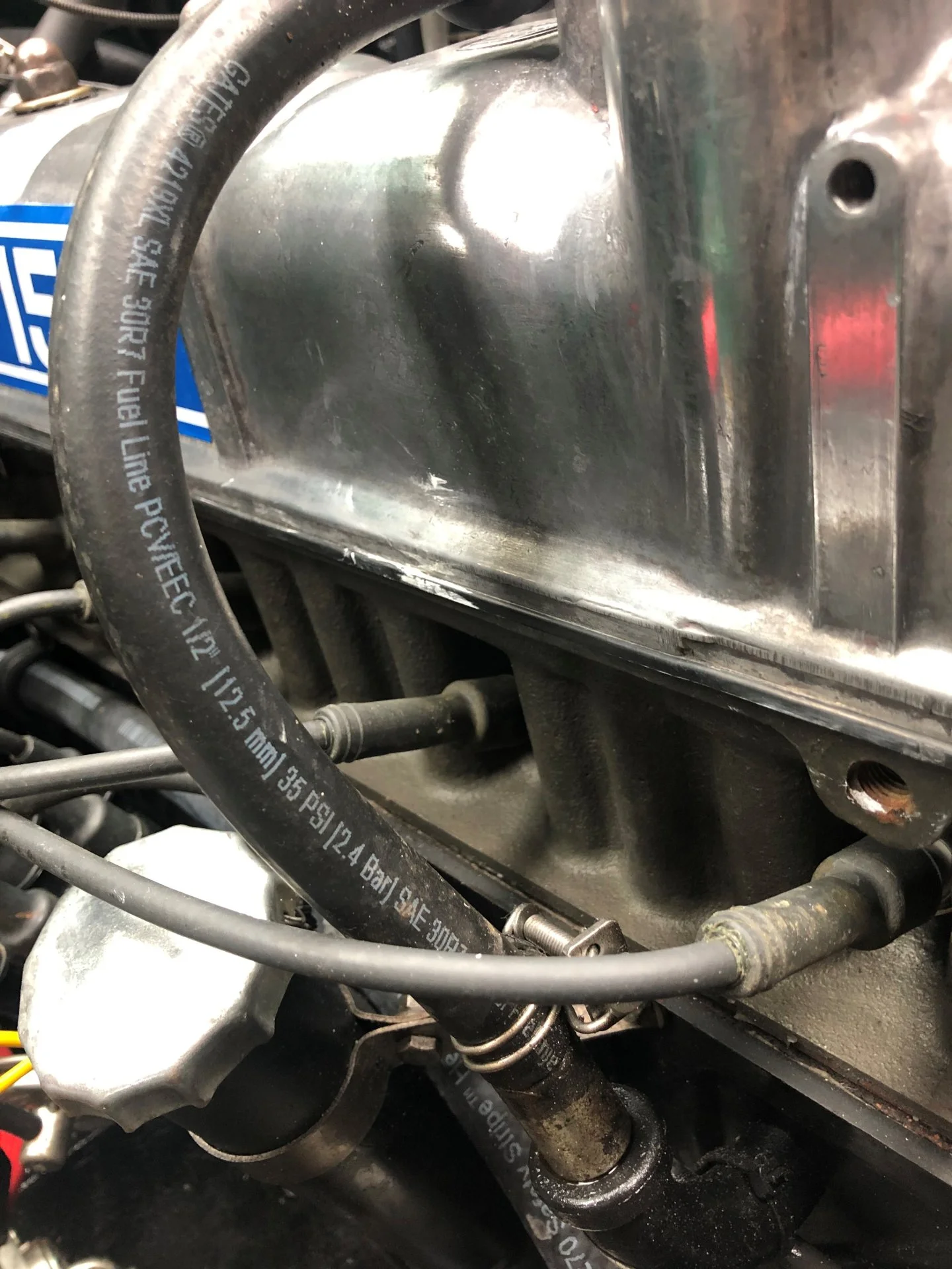

Pcv hose is specific for its application. It's designed to handle the fumes and most importantly won't collapse while under constant vacuum.
Is this correct?
Thanks.
