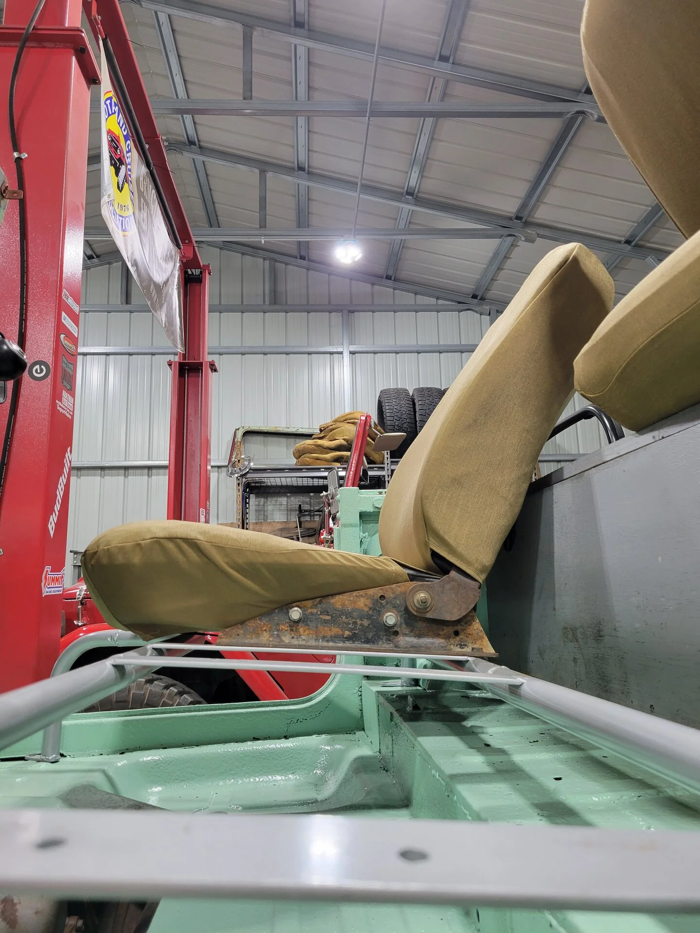

I used @cumminscruiser seat mounts and cut about an 1 1/2" off the back mount to lower it as much as possible. Then I removed the sliders from a set of stock buckets and moved them back as far as I could. They are hitting the inner fender well. I'm 6'1". Gives me pretty good leg room. I can almost stretch my legs all the way out.
Thanks.
I hadn't considered the idea of eliminating seat sliders. Are the cumminscruiser seat mounts lower than stock Toyota ones?
Not much. The gas tank limits how low you can get them. If you did a reserve tank in the rear on the underside and eliminated the passenger tank you could go as low as you like. I cut a little over an inch off the rear tube to give the seats a bit of a rake, which help with leg room.

Without flipping seat brackets, my ‘78 was very uncomfortable in the leg room department. And I’m 5’11”. After doing the usual 1.5” extension mod it’s now comfortable. If I were 5” taller? Yikes. I feel for you. I’m sure with a bit of cutting and welding you could lower the drivers seat to a place where you’ll find enough headroom. The approach to the clutch pedal may get a bit weird though, but you gotta find some compromise.
Anyway, I think you’ll need to fashion new brackets. If you think more recline is the solution, that’ll be quite easy to do on a 78 with spacers and longer bolts.

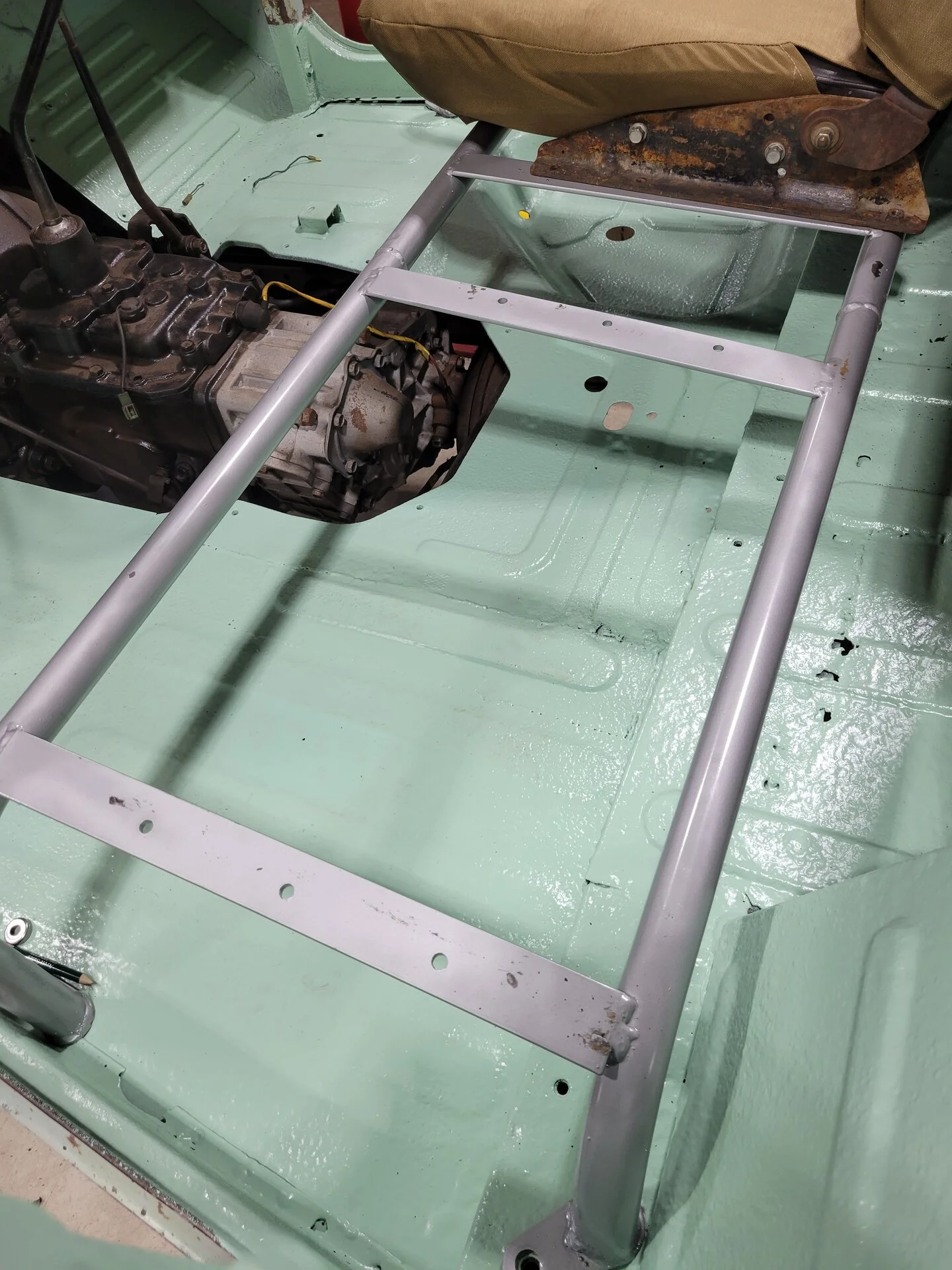

I think I was 6' 4" in the 8th or 9th grade, I'm 6'8" now and wheeling a 40 since the early 80's. I'm built like the OP, shirts are LT and I have big feet. When I ran stk seats I extended the brackets for the drivers side to get the seat back as far as I could, and raised the frt up a bit. I used to run obsatacle courses and mud runs plus a lot of wheeling in the mud and rocks. I eventually purchase some cheap seats with a lot of side bolster and installed them. I was amazed how much I was using the steering wheel to keep my ass in the seat. High bolsters allowed me to be a better driver. On my 75 tub I ran angle iron across the frt and rear seat brackets, then used 1/4 X 1 1/2 flat stk mounted to the bottom of the seats with spacers between the seat and flat stk so the frt of the seat was rotated up, with the angle iron going across the rear pedestals lowered the rear. I then laid the flat stk and seat on to the crossing angle iron. This allowed me to position the seat back or foward sliding on the angle iron. Once I found my happy place I then bolt or weld it down to the angle iron. I used to carry a boat cushion for short people if they wanted to drive. My 76 tub framing is similar to @CondeCruiser except I used the stk rear seat pedestals with the angle iron going across each pair of pedestals and using the stk 40 seat bolts. My tubing in the frt is tied to the cage.

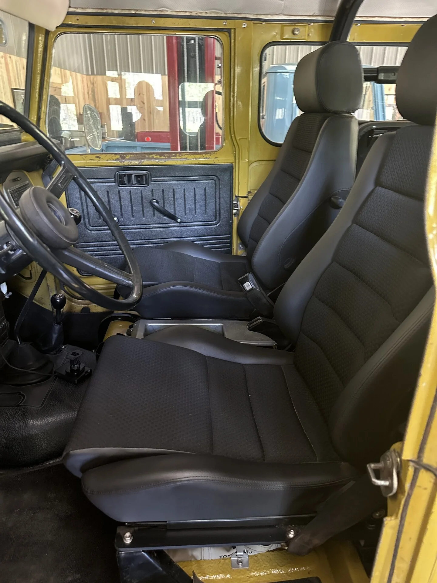

Jomelo, which model of Scheel-Mann seats did you go with and do they sit lower than the stock FJ40 seats? (They look REALLY nice!)
Thank you all for the benefit of your wisdom and experience. I sincerely appreciate you taking the time to respond. pb4ugo, I'm impressed that at 6'8" you can fit well enough in an FJ40 to drive it. That's great!
Vario F and yes they do sit a bit lower than the stock seats. This is generally the model I run in all of my cruisers because they fit perfect.
