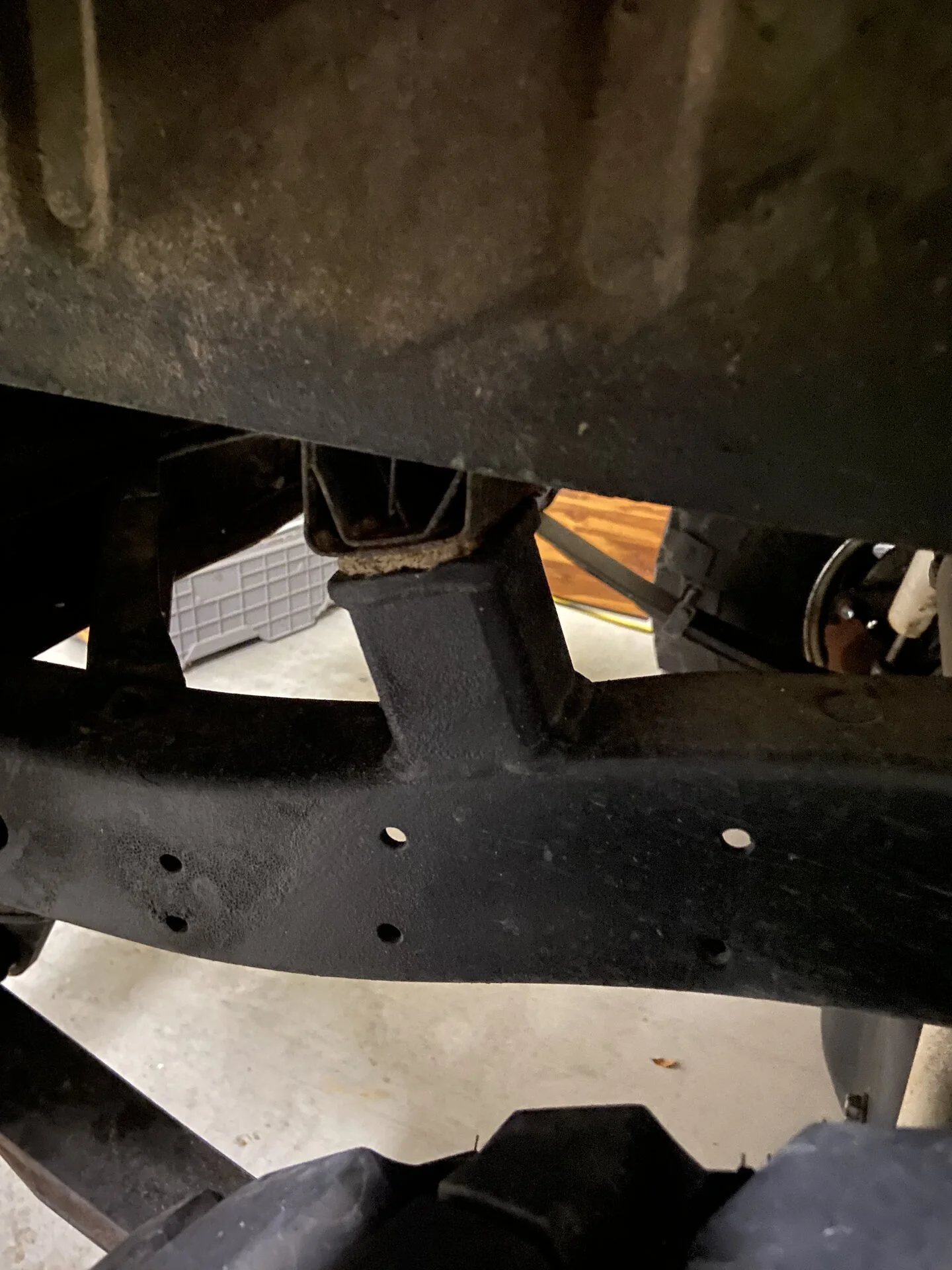

Now, I am starting on the removal of the 3" body lift. The lift was done pretty well which meens that it will be a real pain to remove. All of the blocks are welded into the frame.

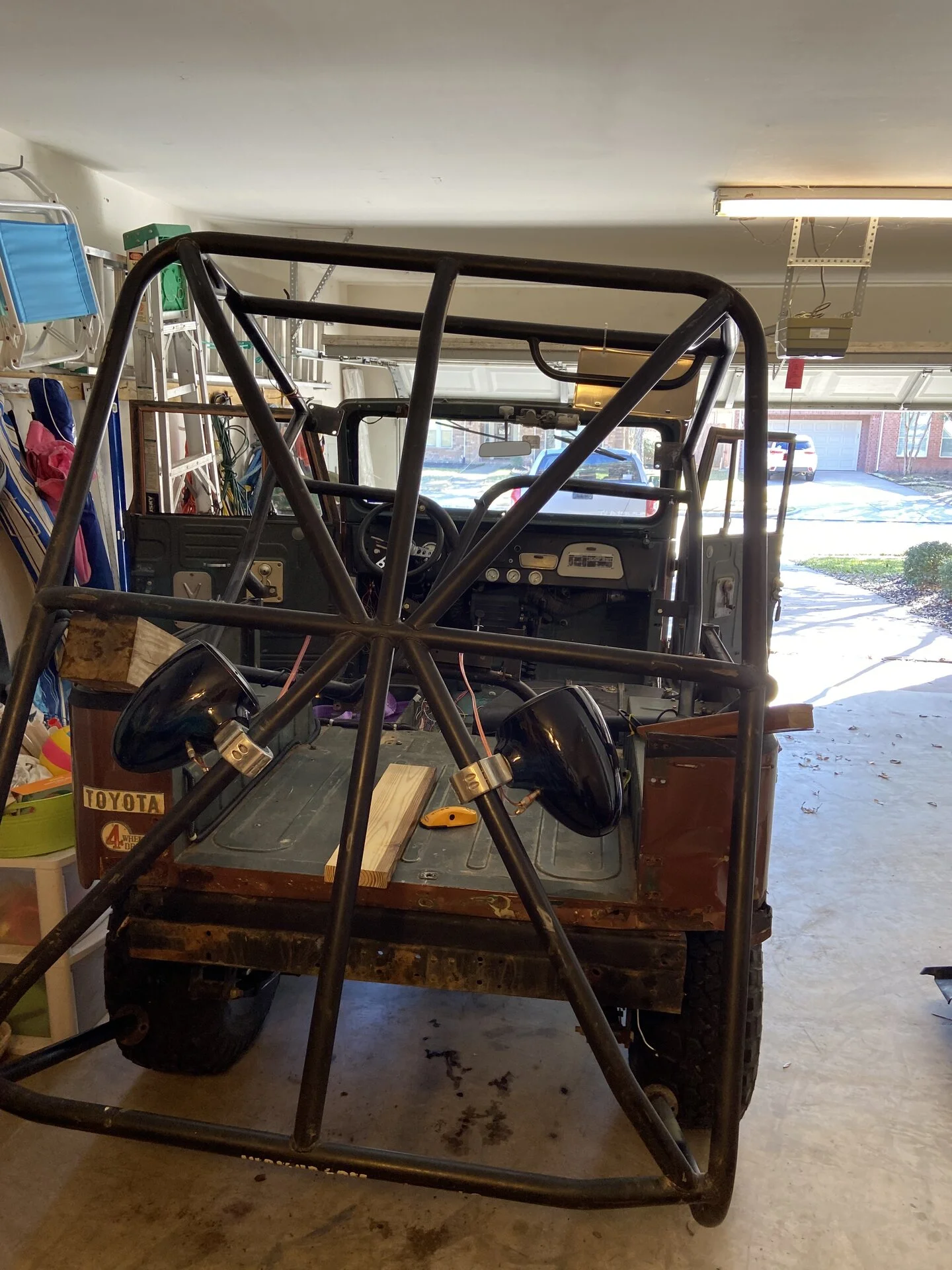

Got the Cage out (that was a lot heavier than I was expecting), the steering column out, and the exhaust off.
I had a pretty narly exhaust leak so I am also taking the oppurtunity to pull the headers and swap gaskets while everything is out of the way. Next will be the trans tunnel because there may be modifications needed when I drop the body 3". I'm running into lot's of hard sealer where I would expect metal. When I go back, I will weld up all of the sheet metal.

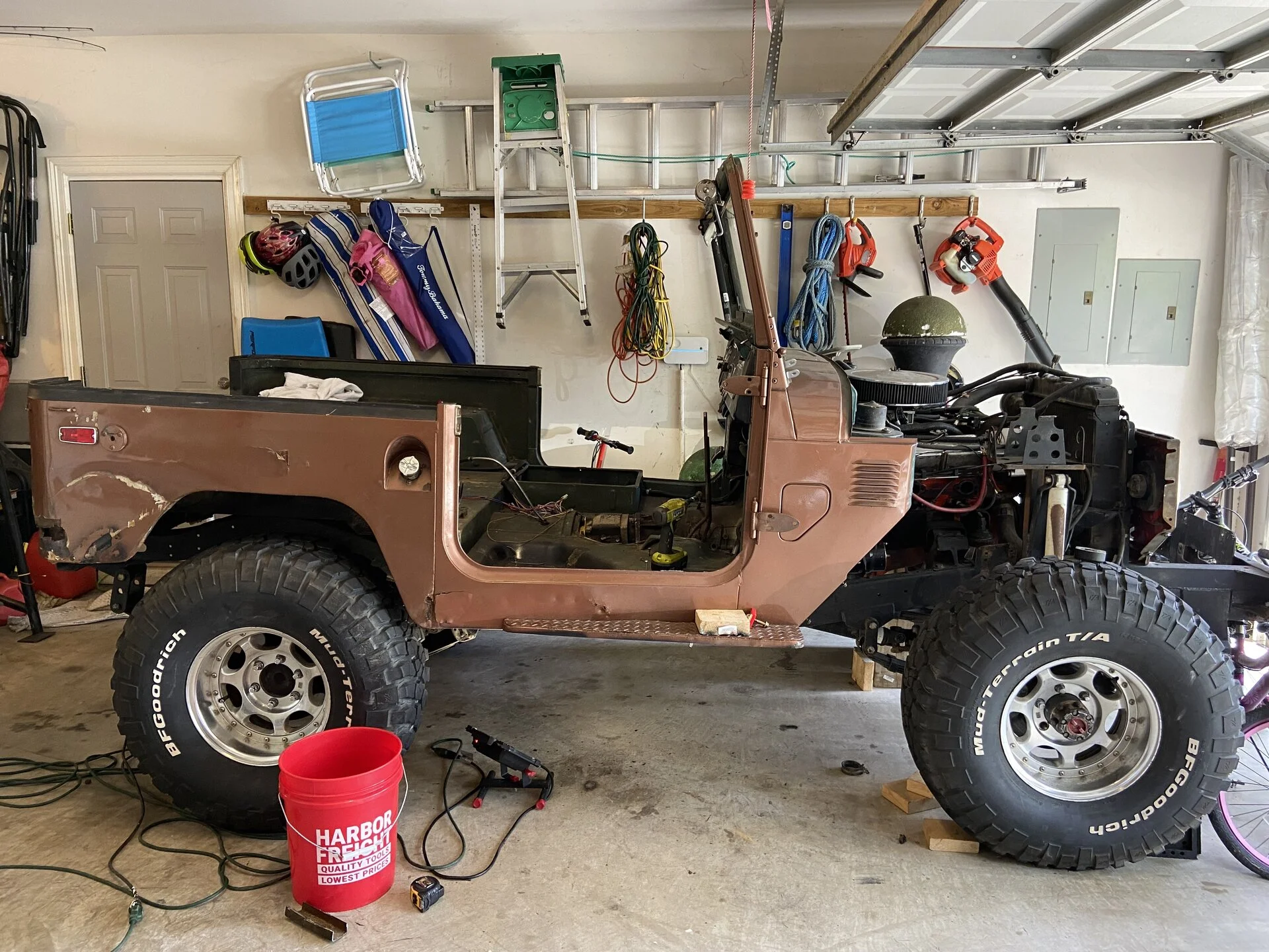

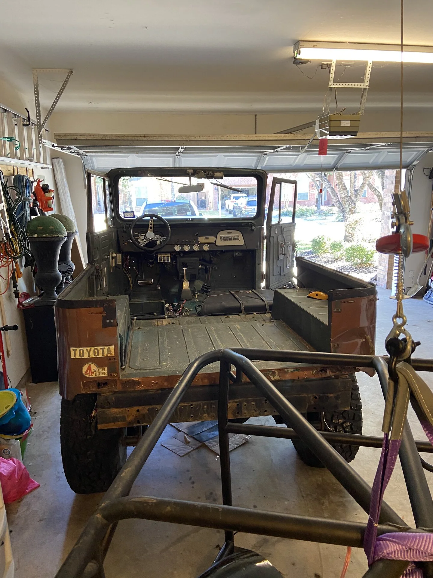

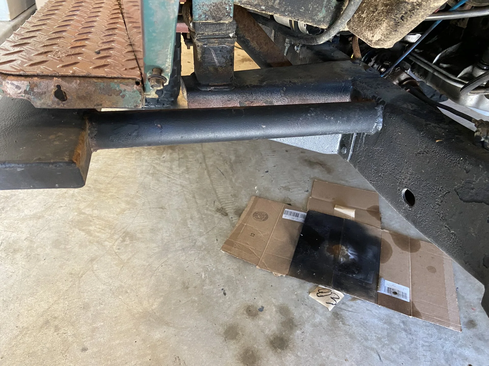

I was able to get the roll cage frame tie-ins, body lift, and rock sliders cut out. I lowered it to the new body height to see if there was any interference. I had to make some adjustments for the transfer case linkage. It doesn't look like I will need any modifications to the trans tunnel (except for patchers some lap patches and ensuring the parking brake functions (the body is much closer to the hand brake lever and it is very tight now).

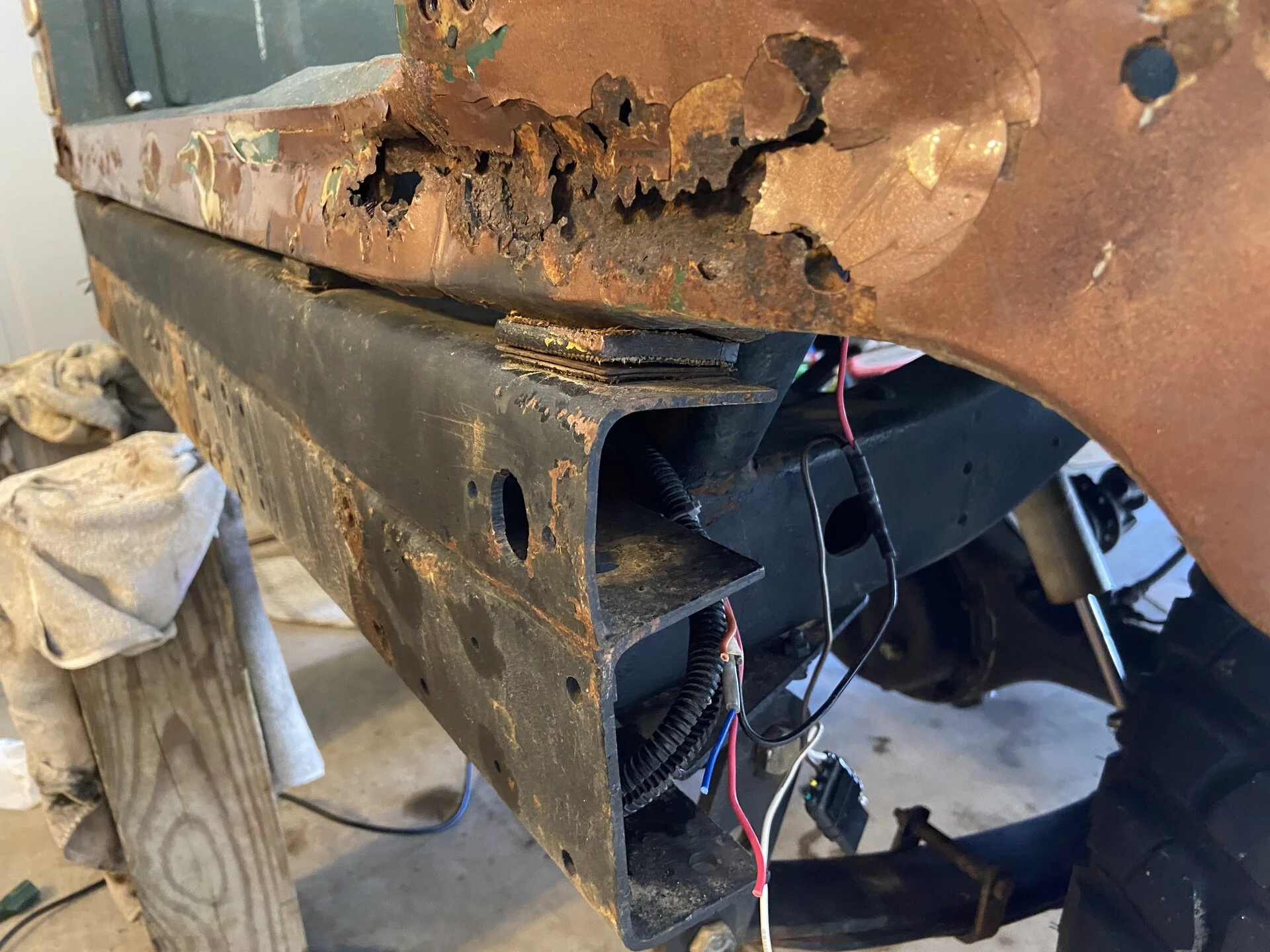

I ordered a new rear sill and both rear quarters from Real Steel Cruiser Parts. while I was under the rig I pulled away alot of mud that was hiding a rotten floor board between the innner and outer rocker on the drivers side. I'll have to get in there to fix. The rest of the flooe is in great shap so I hope I don't need to replace the whole thing.
I have a feeling that the hood will not clear the radiator now. I will test fit that next and I may be trying to lower the radiator.
Here are some pics of the items cut off and of the FJ40 with the new stance sitting on the new bofy mounts (ordered from Marlin Crawler)

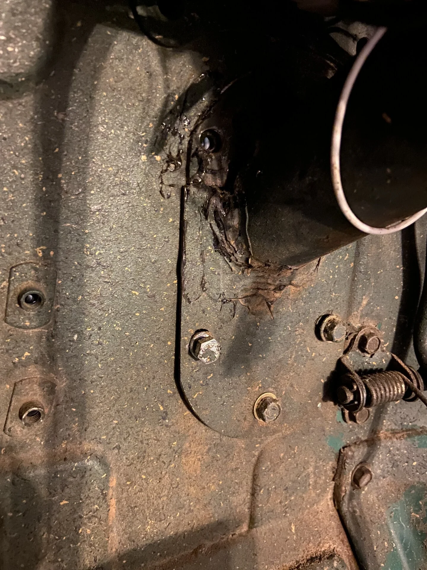

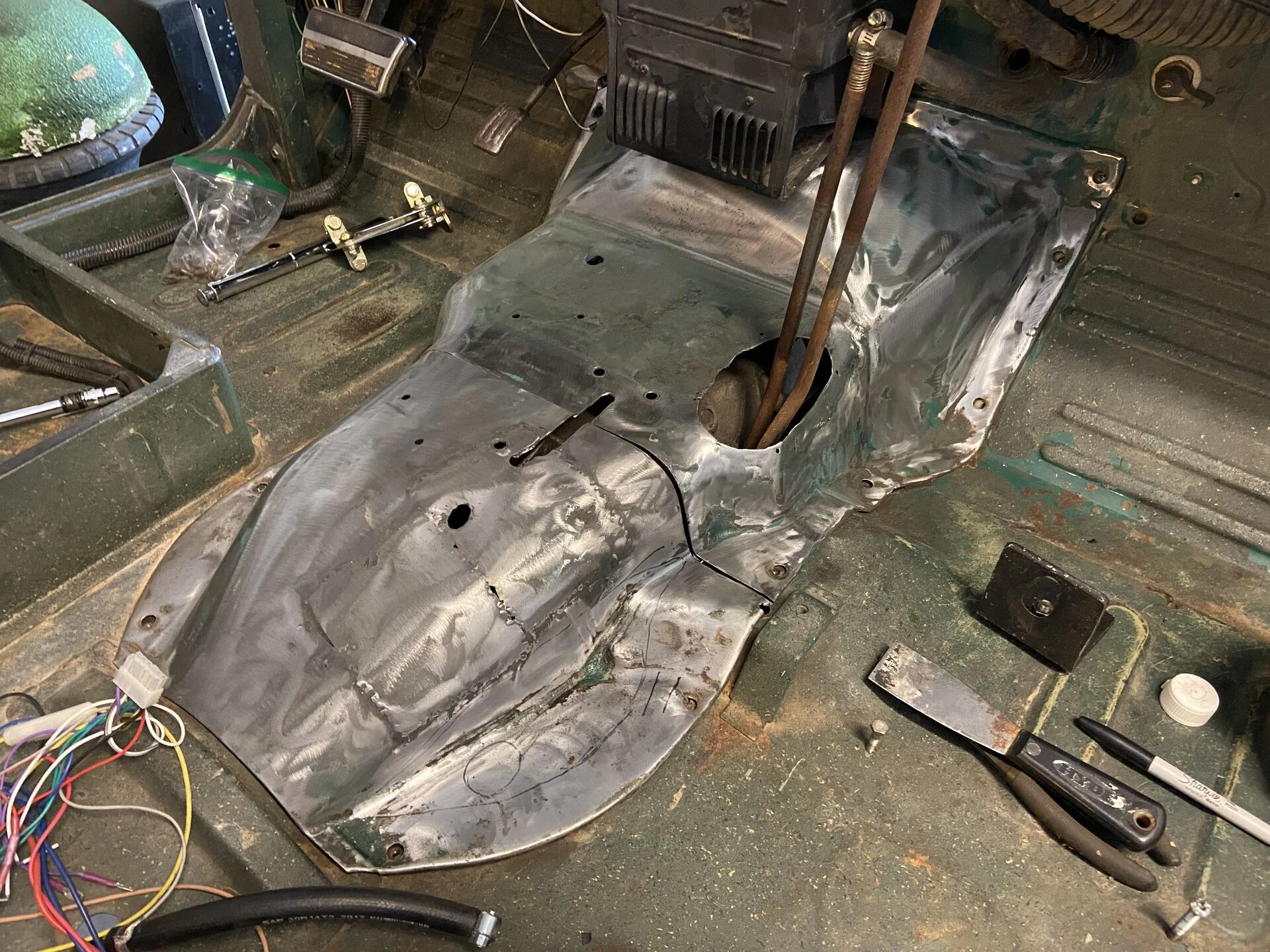

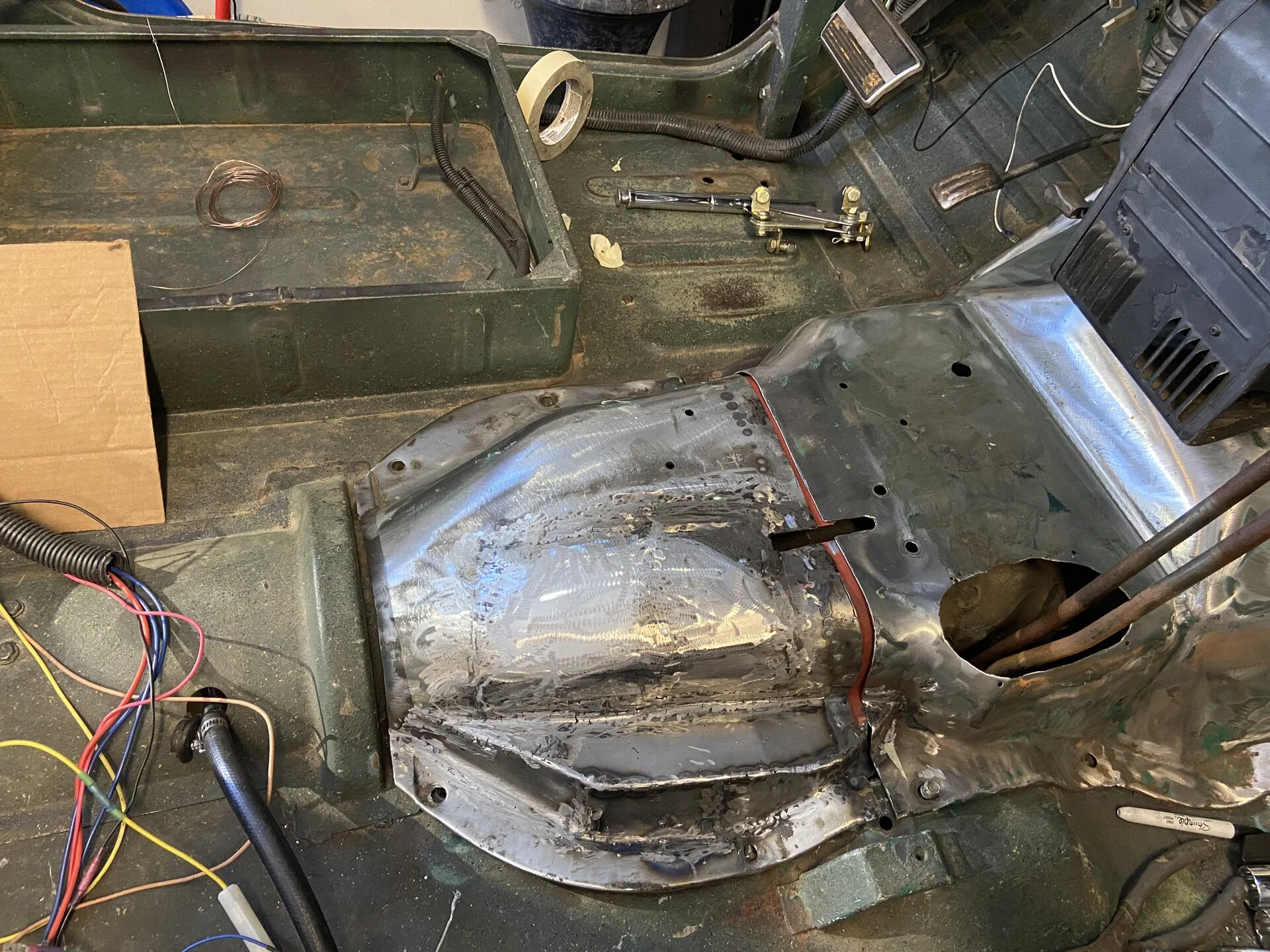

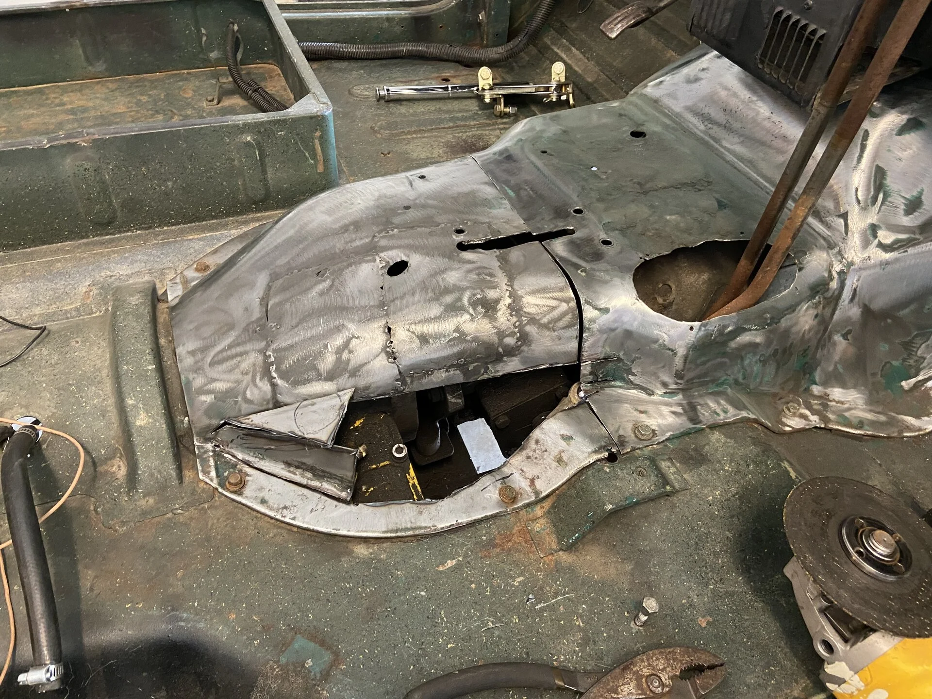

It's has been a while since I updated. It turned out that the trans tunnel needed some modification due to some interference from the Orion TC shift linkage. While I was at it, I removed the lap patches. I decided to keep the "split" design because with the roll cage in (the seats mount to the roll cage), it would be nearly impossible to remove the trans tunnel for access. I added a flange to the lip and will add a little bit of weather stripping to. It should seal up nicely.
Overall, for my first time doing sheet metal work I think it came out pretty good. At this point you can safely call me a grinder and not a welder. :)

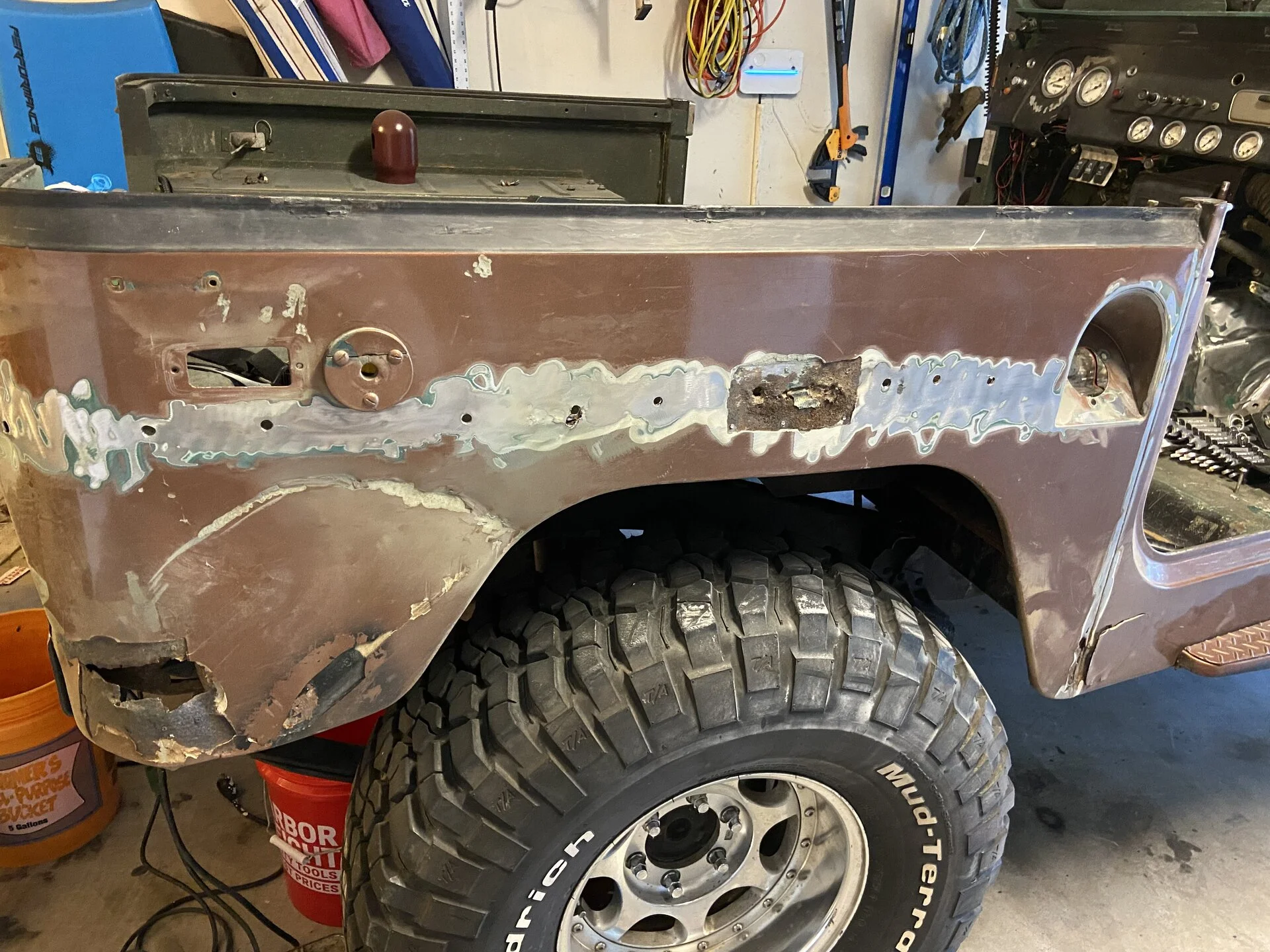

I got my quarter panels and rear sill in from Real Steal Cruiser Parts. I have started to remove the passenger quarter panel. I am going very slowly and consider this my therapy (it makes me feel better about my snales pace when I call it that).
Here are some pics
