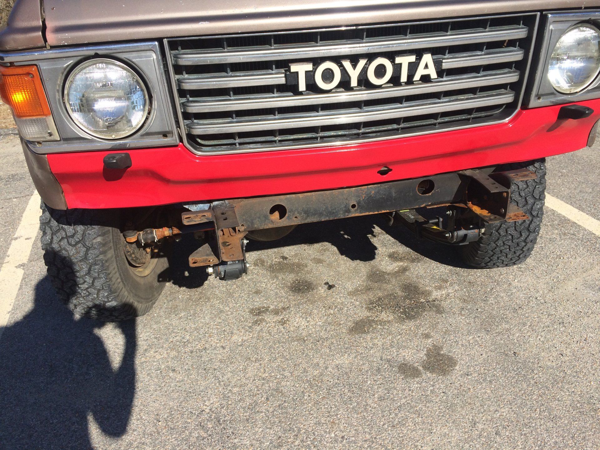

No there isn’t room to pull those two big bolts. My seeps oil too same place. It’s what it is. I’m not fretting over it. And very similarly of coolant too but not along that curve more to the other side of the block. You can get a wrench in to tighten the WP bolts, try that. Also check your hose clamps as well as the tstat housing bolts.
Yesterday I did an oil change and today after work this is the drips that I saw after a 9 hour shift. The darkest spot which is a tad over quarter size. I’m okay with it.
