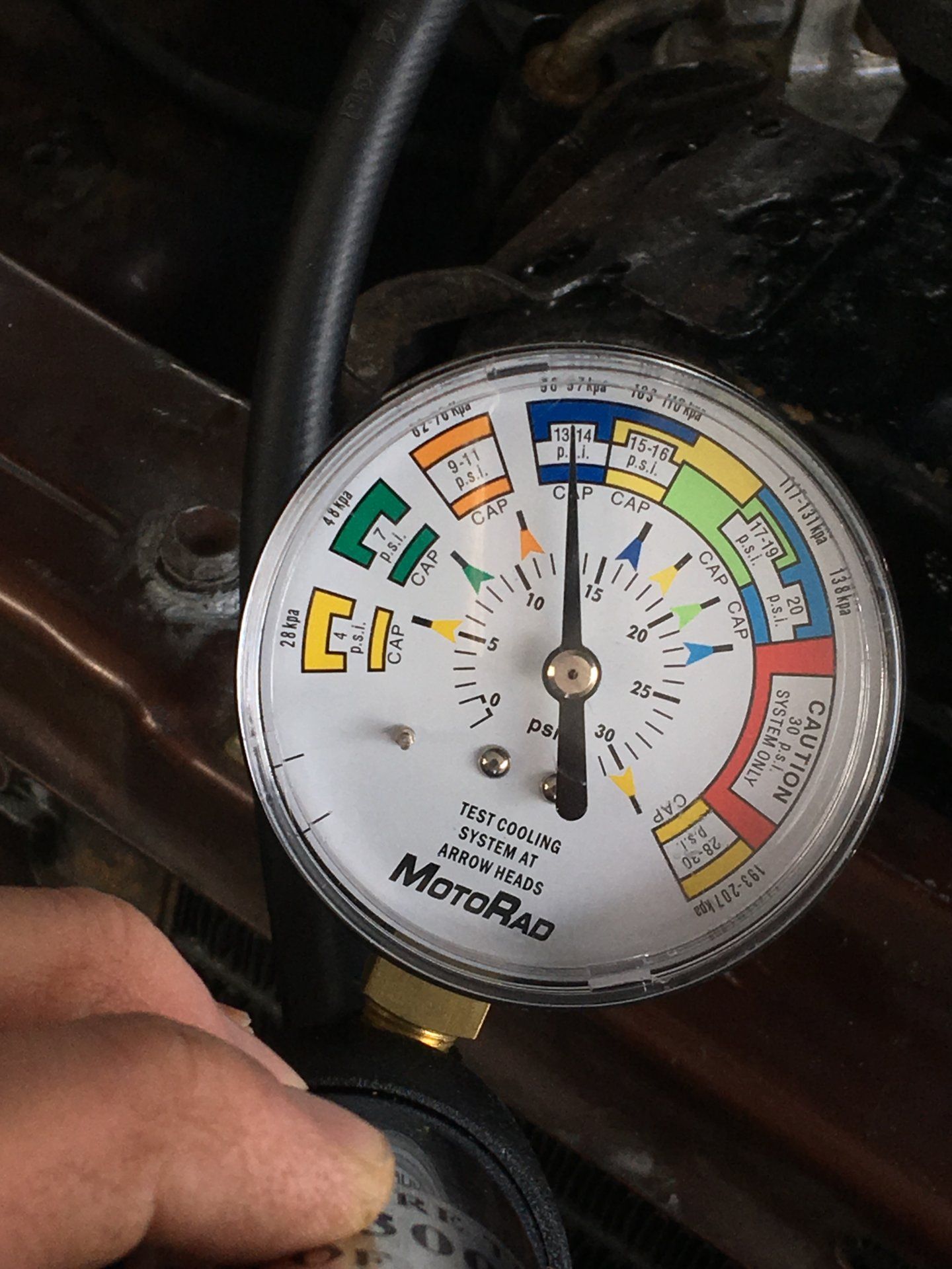

I got the loaner tool coolant system pressure testing kit from advanced auto last night. In 9 degree weather this morning I had to try it, I couldnt wait. This tool is the way to go!
Upon my first couple pumps obvious leaks came right up before I could even get close to the cap pressure of 13psi. I tightened up one hose clamp (on a new hose I replaced) and that stopped the major “bleeding”. Others then popped up and i simply tightened things down. Seems to have worked. Doesnt seem like that tiny oil cooler hose was the problem.
The gauge now seems to indicate holding a very very declining pressure in the 13psi range. There must still be a faint leak somewhere but nothing like what it was.
Starting gauge reading:
ten minutes later:

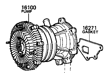

Very weird that the gasket didn’t come w/ it. I might have an extra cuz I ordered one when I bought my Aisin from rockauto but one came w/ it. Lmk. I can toss it in an envelope if you want it.
Thanks for the offer for the gasket. I may take you up on it but I’m going to try the local dealer first (and buy more than one if they have them cheap).
