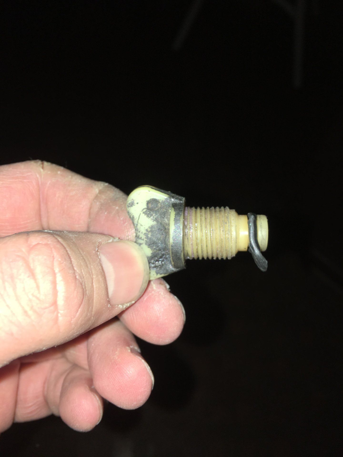

In filling up the rad with new coolant mix, a leak from the radiator petcock started. Now I am really screwed. Any advice on a fox to the petcock if I cant find a new Toyota one nearby ?
It's just the oring. You can probably find another oring that should fit well enough at the hardware store.
