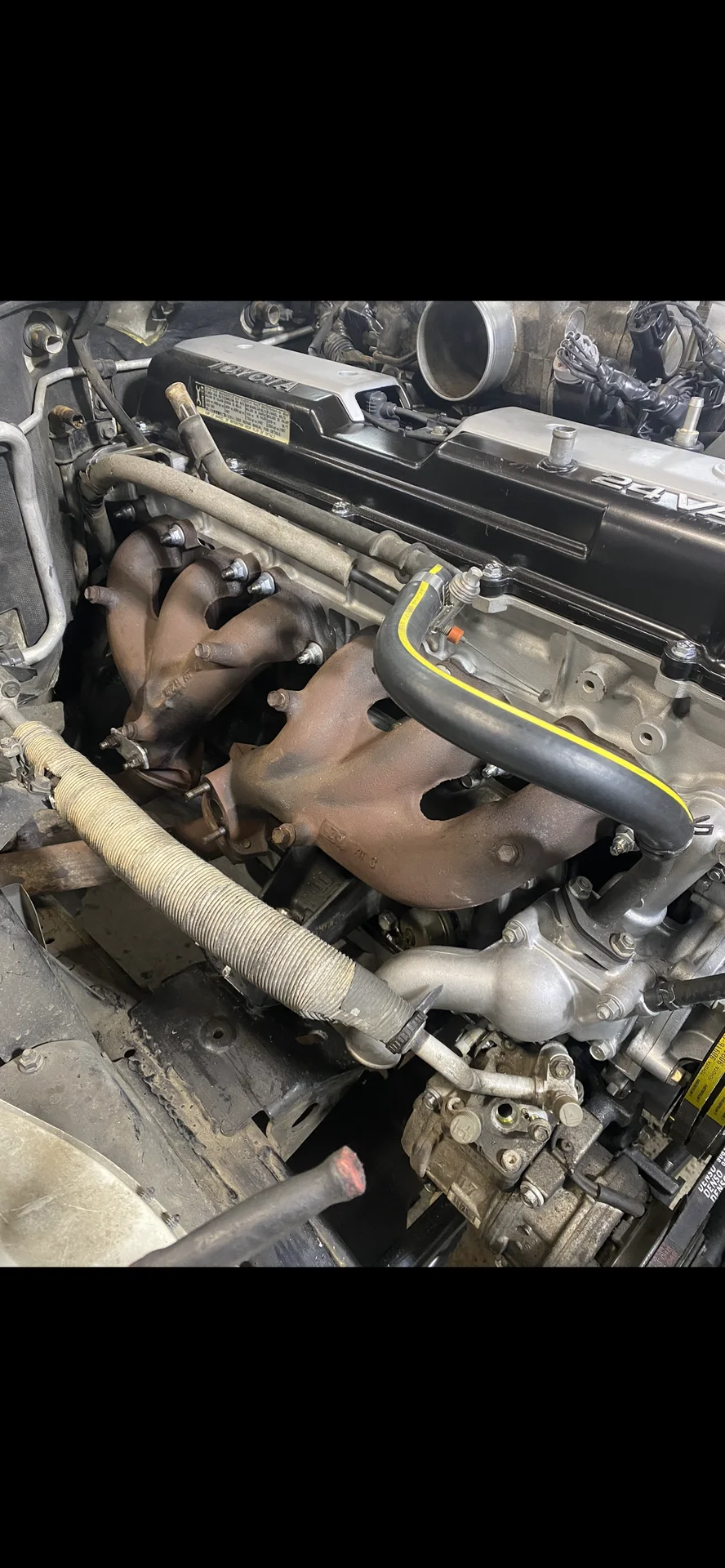

Hey guys, got some coolant leaks on the pipe from the thermostat all the way back to the firewall. PAIR system has been removed on my '94, so I'm looking to move to the 1 piece solid pipe from the 95+ which I know is now NLA. I know there are a couple other items that are probably NLA so it will take me some searching online to find them. But meantime, need to put together a complete list of part numbers. Here's what I have so far:
78185-60040 throttle cable holder
87245-60480 firewall hose?
87208-60161 hard water pipe
15785-66010 hard pipe gasket
Much appreciated for any part numbers I'm missing in this mix. Thanks!
I have a couple of those 95+ coolant pipes if you’re looking to buy one also have the throttle cable bracket. As far as the other hoses I used gates 5/8 green strip Or Napa sells yellow strip by the foot.
