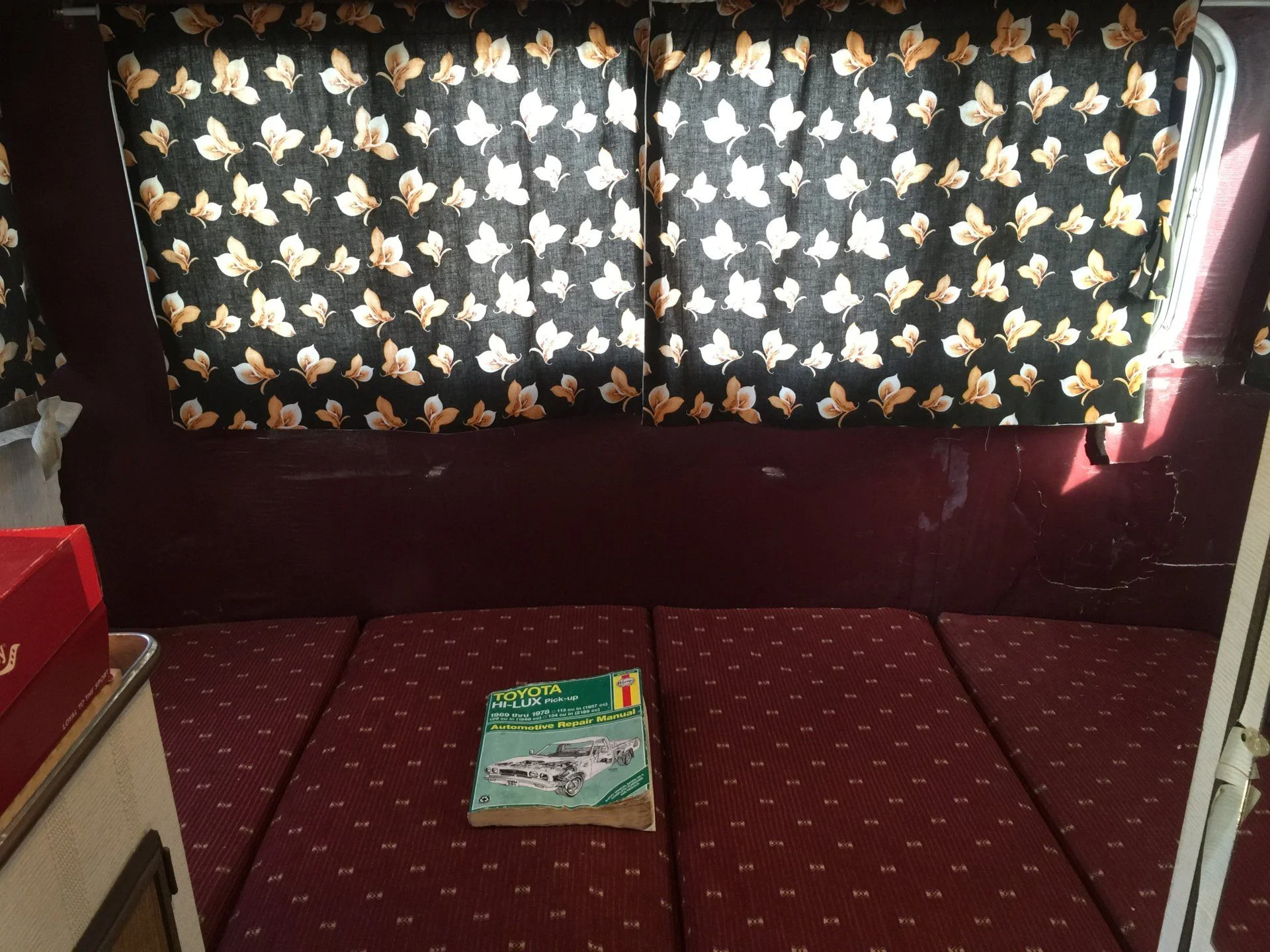

First step in any project is cleaning out the vehicle and assessing what works and what doesn't. It was obvious that the PO cared for this vehicle as not only did he have a repair manual for the rig but also had brand new wheel bearings and a complete clutch kit in one of the drawers. SCORE!

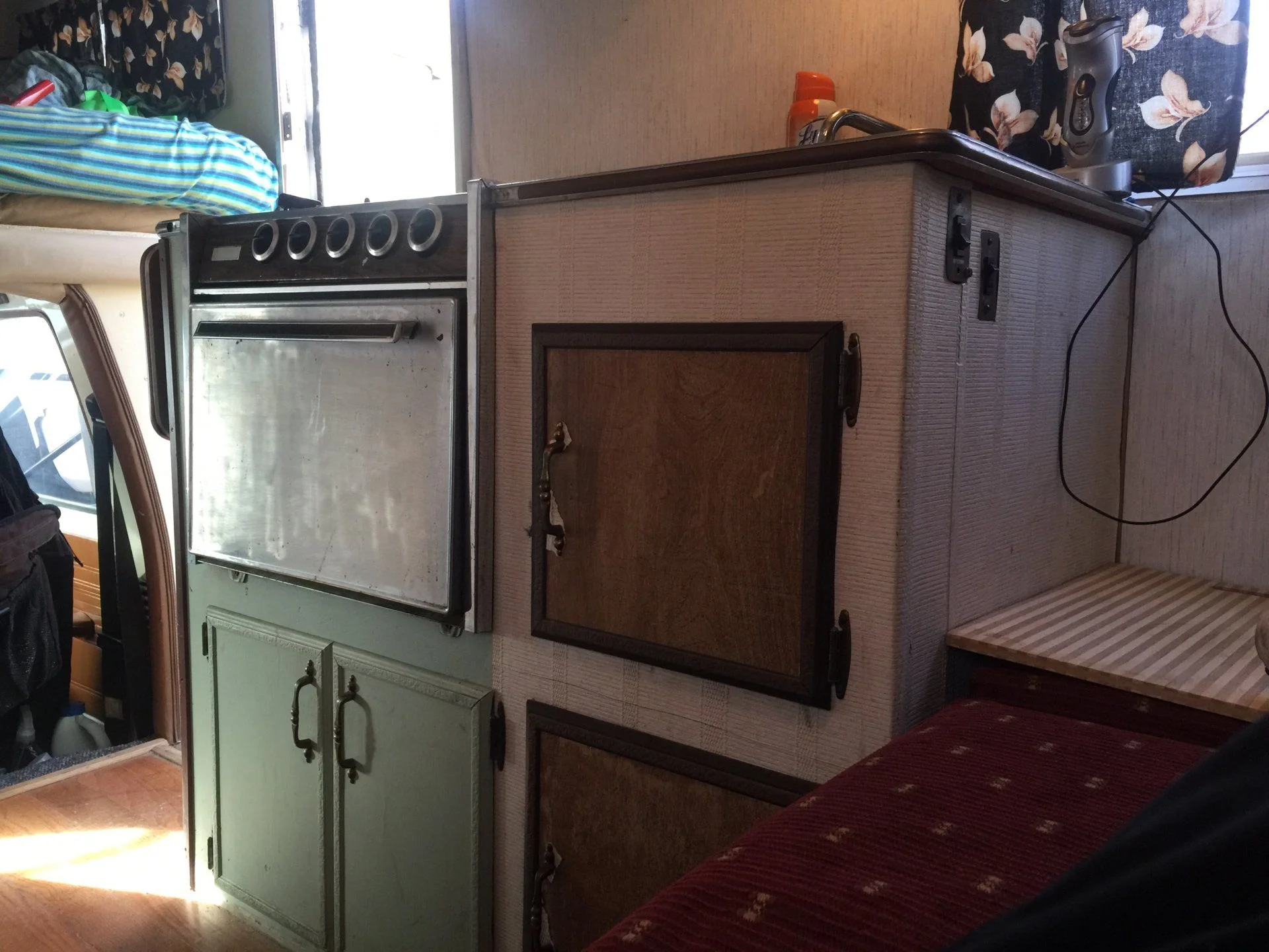

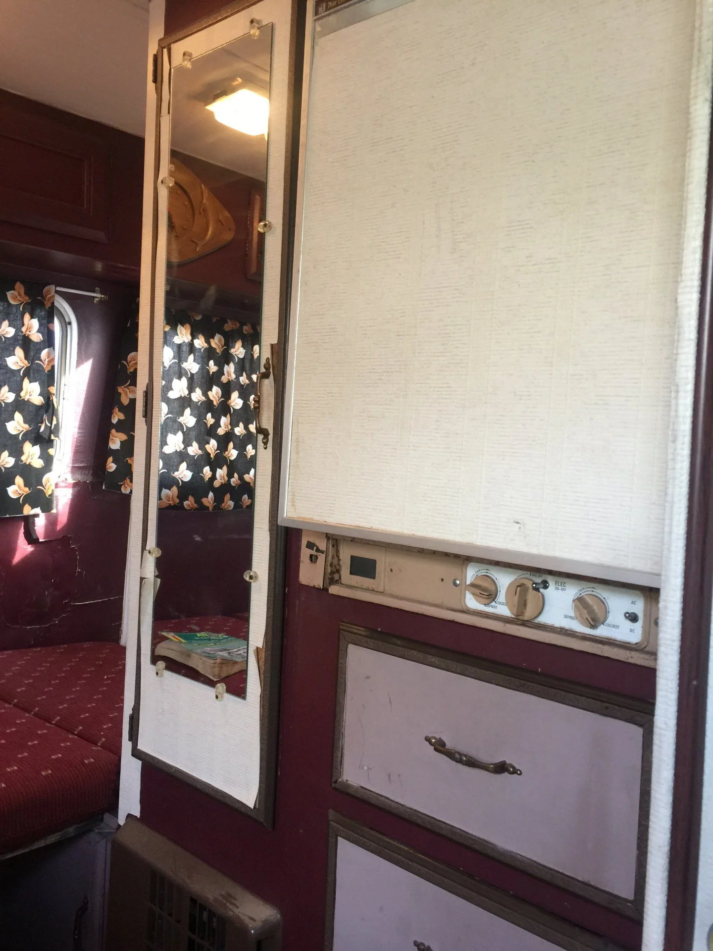

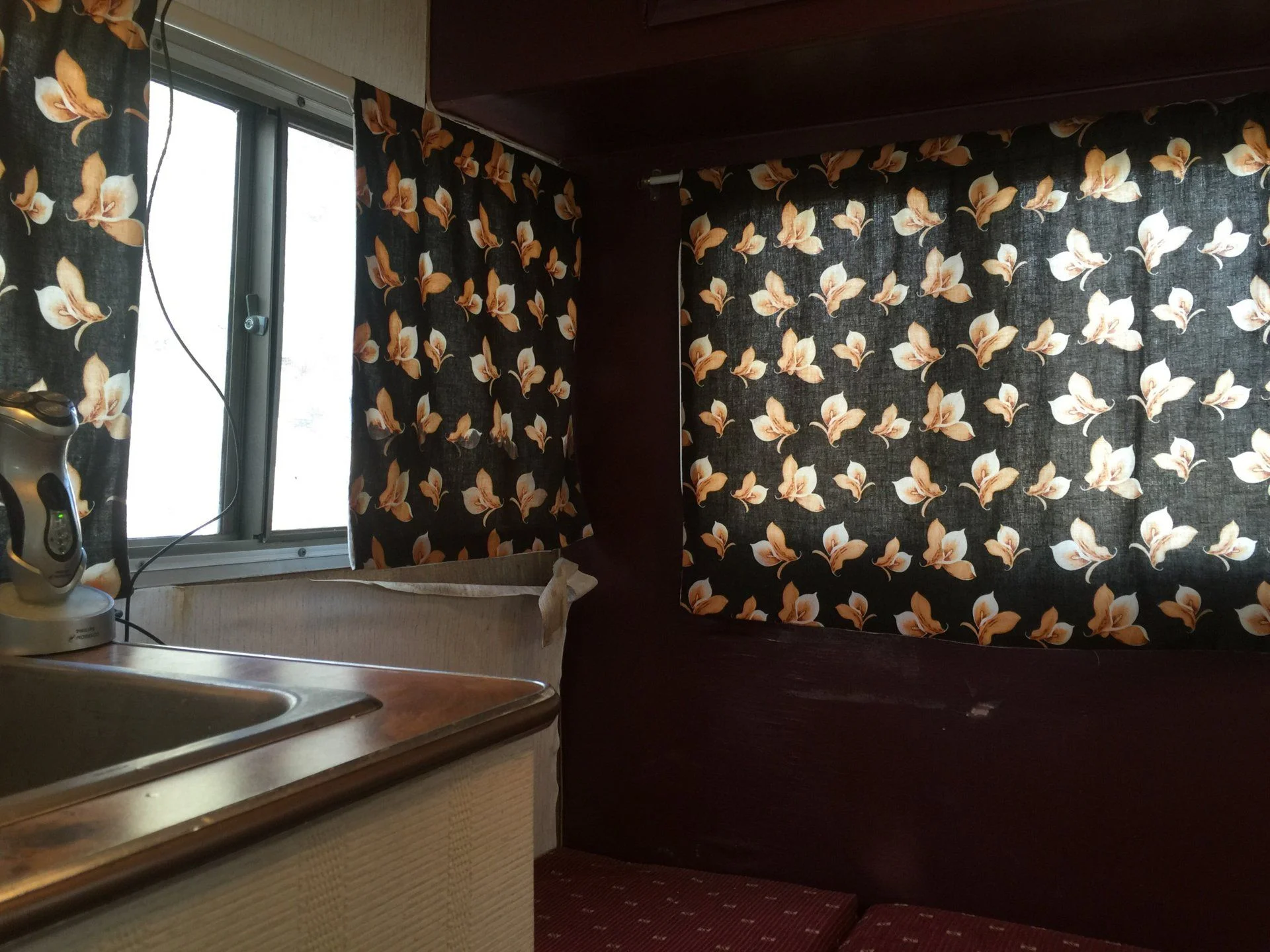

I hooked up the propane and ran the appliances through their paces. The 4 burner stoves and oven all work. The Refrigerator works on both propane as well as 110v. The furnace unfortunately is being stubborn so I'll have to tear into it and figure out why it is firing. The freshwater tank appears to hold water but the freshwater drain is broken due to age. So that'll have to be fixed. Sink drains properly and the water pump works as well.
I am pleased to note that the wastewater tank also has no leaks and that the toilet functions perfectly. I went in it a few times to mark my territory. LOL.
I am impressed at how well maintained this thing is. Other than some funky wiring in the engine compartment the PO seems to have done an excellent job caring for it. It's a shame (NOT!!!) to hack it up and modify it.
