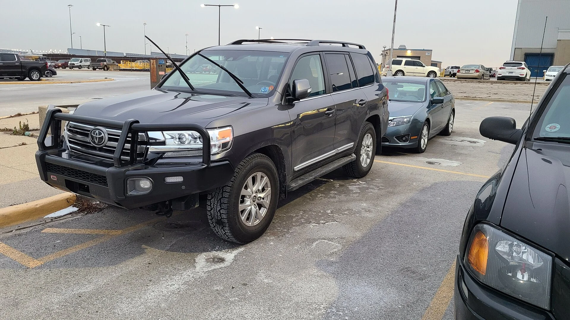

Hmm, didn't think about not folding the mirrors, has that been a problem? I keep them in auto for stopping at gas stations, I want it to be obvious I've locked the truck while pumping gas. Took a pic as I left my car at O'Hare yesterday, yep the mirrors are folded. It doesn't look like there is any way for ice to bind them up, but if others have had a problem...?
5r_9bjPlShqGFRr3IIgNLuSz608PYaYQQHVjmk4zw5AppumfWmy6WxGqlZzzzefmhghG6iOsDqblvarwRwvQNPj5ulQudkFpgvxO_Yq9XeqFqXVPyZHjhSJsaIVj-a6fK5raAvhsCgyHwYnU2mIiwPGn1AFGWUo-UHUS7bsFMdkzEVcoQpRUYsGK42p4cDpwSK5xOE3mu77EZ_9VUXCTECWFc7osB5ZhLNMRvaD1D1KzA-NmOXPbvz7Bqhxw7WJZDvbJrnAe1R8g83K-d7aQdY2FoKZF33pmR-60d79jdlLyKr-2nfT5KfC6nCyXQRY5n7n06SUgURU2qezrhyVsFd2yKzccqkdTc6CnP3IHamWTy3YCseeZepl7FeCH1JIYlkbJrlM1Xjm5Vj0GtvmXCqDTZ74NgV8-seiHDDYGm_l7LLRpgl5ap5uP6eqDWczSpA1FsYxPvm7aDxskH5HcxHnlQxqm_VKZ-P7KRR5gWGqumapN5arHlwVMnMHaV8bwcaVpJE7G1vHaPEXuwEu-XYwMd9LqrIofKBya4z83Jvy-OvlQh8N_W4zdNEyGToq48S8bTU9c6hdecFhlKPuQOokgIgb01noqmWhq2l_Pe-LpZEpsBK5ZhD33sdnISxX5kOQ5__5KARzP-8QTzQJoYrNVsrH5oJuW29lSmrz4A6W1nxYzVr4Z6DQ13ihAx4N3qk-YJ0qR1ddqCoQKwkgnMs0n0D6ogsU97c34WgkofMCMJ1e7HhCIQ-xQB8EcY2xF__rZ7memWjiVF8st475CVwjXgI8v0FYJae5moON2sSf0X7LrUp8v_WJjk2IAipKspgROxPYbgEjzg54X1DHnz2MrwfPZDD7RLVfh8mUsFdAlinDq7-IeQ2eFY5FyByLid1DVtyNalhEym2La53PBqgsb5ej3xFjp-F1qZa78Fs_sNzj5I0J1EdSZuMW0SONkYjy3TwPOOqgTCP2uYVs=w2706-h1522-no
They did unfold just fine in snowstorms last year.
