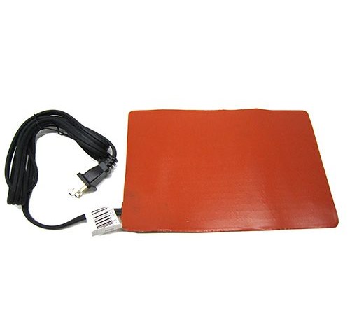

What are your thoughts on using a battery heater like this:
in conjunction with an oil pan heater like this:
Amazon product ASIN B08B817WF9
Since I will only be visiting Fairbanks for a short while (a week or two in Feb), I like these two since I could remove them easily when done (or each day when driving.)
But I worry they are not sufficient to adequately protect my engine and battery.
Fairbanks in Feb a battery warmer is a must. For the pan heater they are a little debated. I have a block heater on my 200 and on my kids cars Subaru has a block and MB e320 has a pan.
Seems reasonable to me considering what you are doing.
To be clear…. I meant to use that pan heater and battery heater instead of a block heater.
I’m a little leery of getting a block heater installed into the engine since none are sanctioned by Toyota. So I like the temporariness of these other solutions.
And I guess one leaves that battery heater running all night, huh? (Whereas the other heaters are only turned on a bit before starting the engine.)

Having lived in Fairbanks for a while back when people left their diesels running all winter to keep them running, i have been through this. Key thing to remember is that unleaded fuel does not vaporize below -40F and will not burn. You have to heat the engine when temps are below that temp to even start the car, no matter how strong the battery. Remember also, it is all about air temps. Your engine doesn’t care about wind chill so don’t count that.
On my FJ60 i had a battery heater, a magnetic oil pan heater, and a freeze plug block heater. All plugged into an outside power strip in the engine bay. That setup chugged some serious electricity but did the job.
My 100 just has the old style Toyota heater but the heater doesn’t get much use where my truck lives in coastal Alaska.
I had the standard Toyota cartridge heater on my 2014 LX570. When I bought my LC 200 in 2015 toyota had already recalled all of them due to substandard power cables overheating and causing fires. Now my 200 lives in a much warmer Seattle so no heater necessary.
However, KAT makes a very good cartridge heater for the 5.7. I also use Kat’s battery wrap heater in the 200. Remember, the engine needs to be above -40F to start.
Beyond that, the 5.7 will start with zero issues at any temperature that fuel will vaporize. It may make some awful noises until the oil warms but they don’t seem to indicate any real damage. But i would use the heaters anyway.

I think you will be ok unless it gets “really cold” as in much below -30F. I have the oil pan heater on my 2004 e320 4matic that I’ve had since new and it has been in AK for 14 years with no issues. I don’t think it has seen -40F but has seen temps in the -30’sF.
In February it will likely be lows in the -teens F and highs in the single digits F. But in reality anything could happen.
So I just looked it up…. In the last 4 years, there have been 14 days/nights where the temp dropped to -35 or below in Fairbanks in February.
So it’s unusual, but not totally unexpected either. But it’s rare enough that I could gamble and just plan on not going out on those nights when it drops that low.
So I thank you guys for the input! I feel better about going this route now.

KAT is the industry standard. My guess is that Toyota doesn't like the piece price KAT would give them.
The heater is a cartridge style and just sits in a machined fitting beside the engine. Zero chance of damaging anything, unlike the old style immersion heaters that required a freeze plug to the removed from the engine block and replaced with the heater.
A 400 watt cartridge heater is much more efficient and is more effective than the old 800-1000 w immersion block heaters. Works just fine.
I wouldn't leave it running all night. I'd use an outdoor timer that is good for 400w of draw. I would set it for 1 hour before I need to start the car. Maybe 2 hours if it is really cold.
