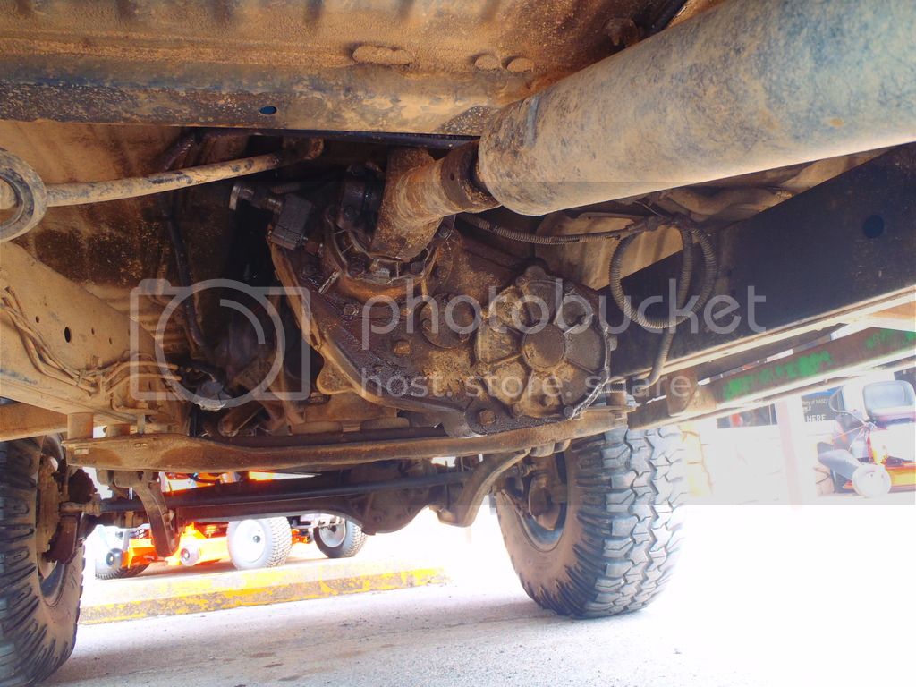

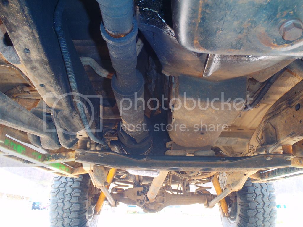

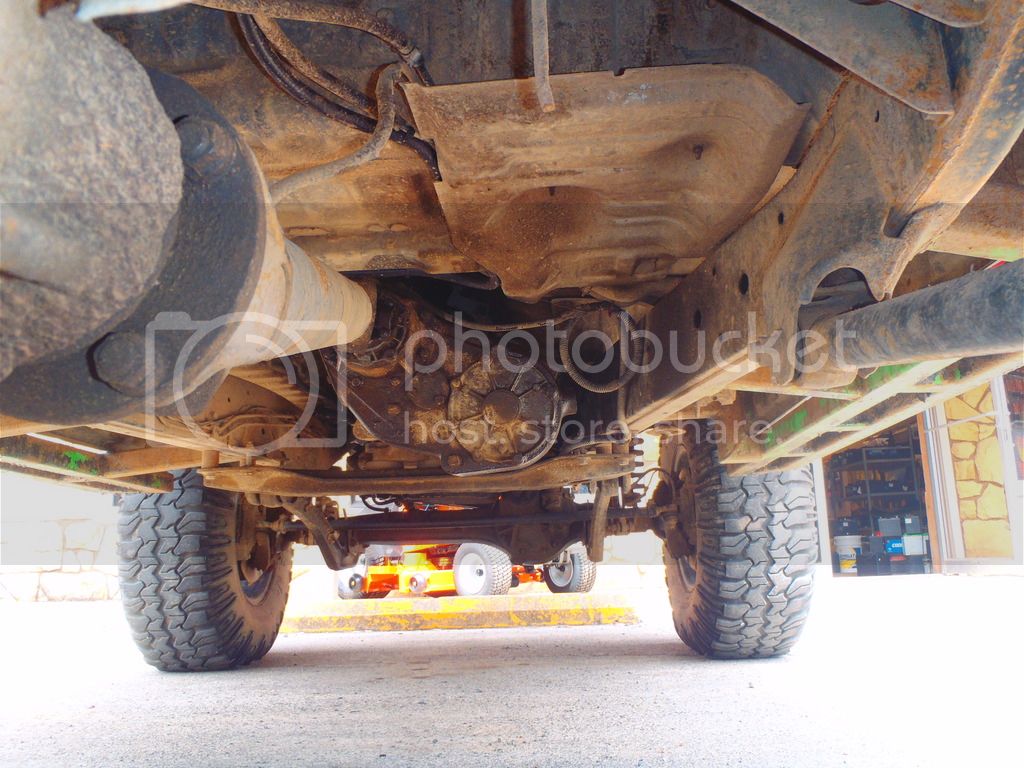

Do you have any pics of the underside that you could post? I'm curious to see how the 205 it's up in the tunnel.

Yea been meaning to post some pics.I'll try and get some up for you.But it fits well and I'm sure a cable shifter would make a cleaner look for the tcase.I used the stock (dodge)shifter and cut a large hole to fit everything.I just plated the firewall to add rigidity.I thought I had a faulty slave/master cylinder.It took me a bit to figure out what was going on so I mentioned it in case someone else tried and had issues
Hope these help ya
They sure do! Thank you! Is that the stock cross member with a spacer in it? Were you able to keep it in the stock location? Using mechanical fan or electric up front?
Thanks again...these are super helpful. I'm either going to do what you have here or see if I can go with a NV4500/NP241 combo for the 2.72 tcase low range. I want to keep it simple though...and this set up looks pretty straightforward.
No worries glad to help.It is the stock cross member,had to add the spacer to keep the tcase out of the floor.Had to drill it to fit the tcase mount as it didn't line up just right.Used electric fan but was only lacking a bit of room to mount the mechanical fan.I have an after market radiator also,so it might be doable with a different radiator.
