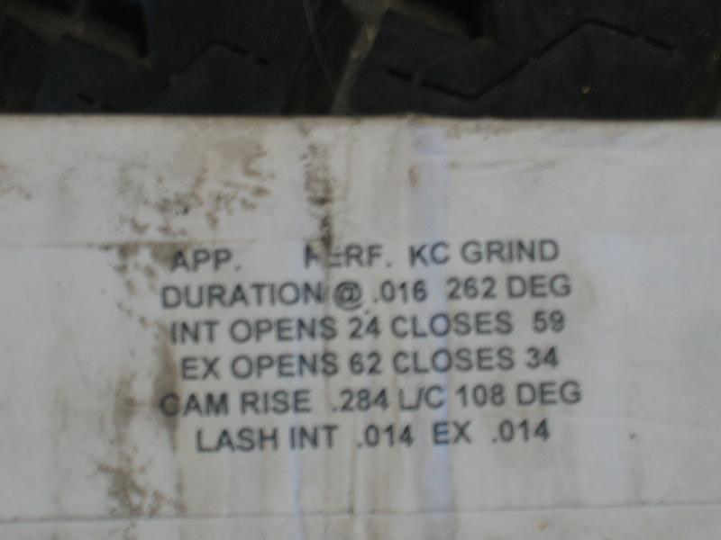

  • Adjust valve lash (lash I'm assuming is just normal valve adjustment?). I know from the PO that the cam was modified

Below is the picture I got from the engine PO with details on the custom cam grind... I believe this means I should set the valve adjustment to be 0.014" on both intake and exhaust valves (versus normal stock 0.008" and 0.014" per my FSM).
