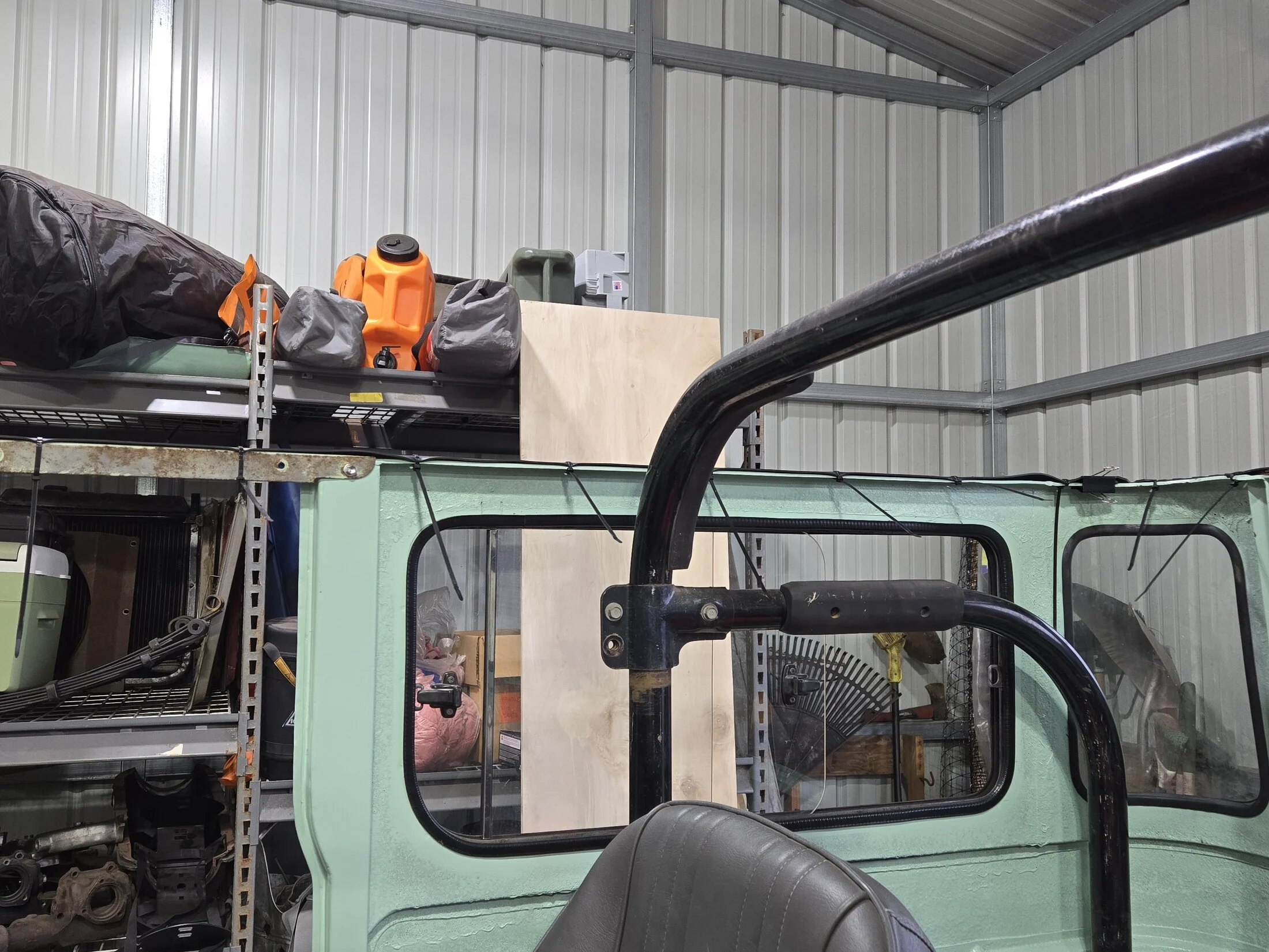

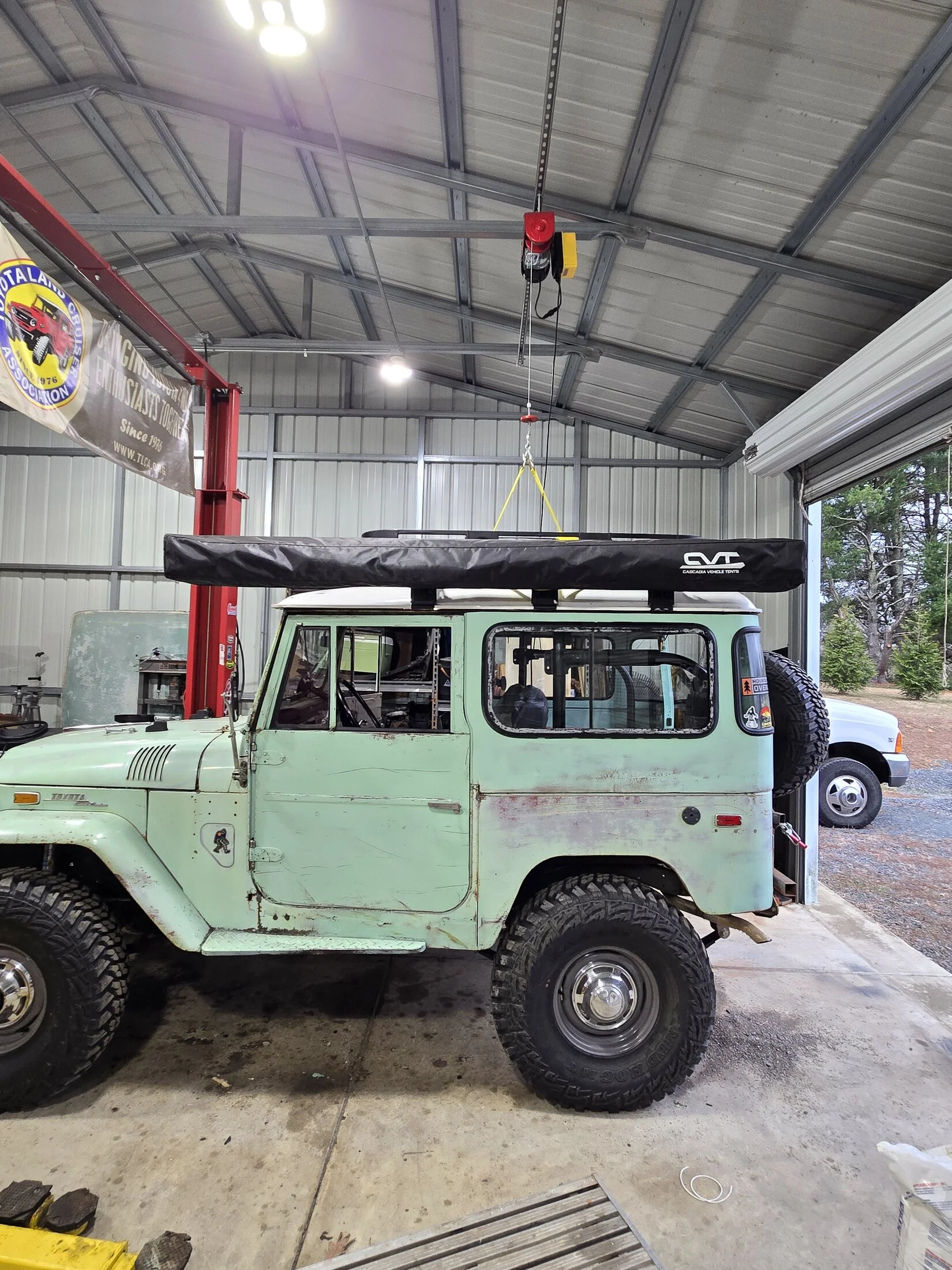

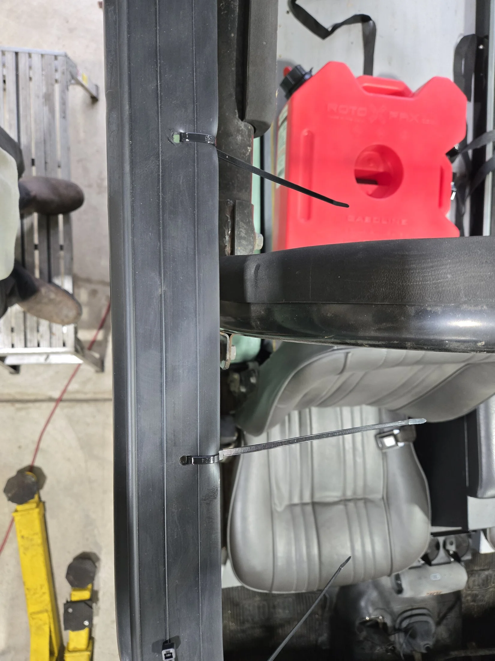

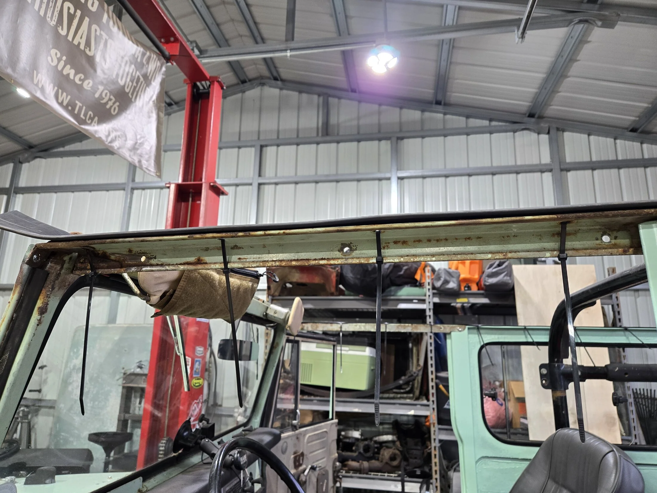

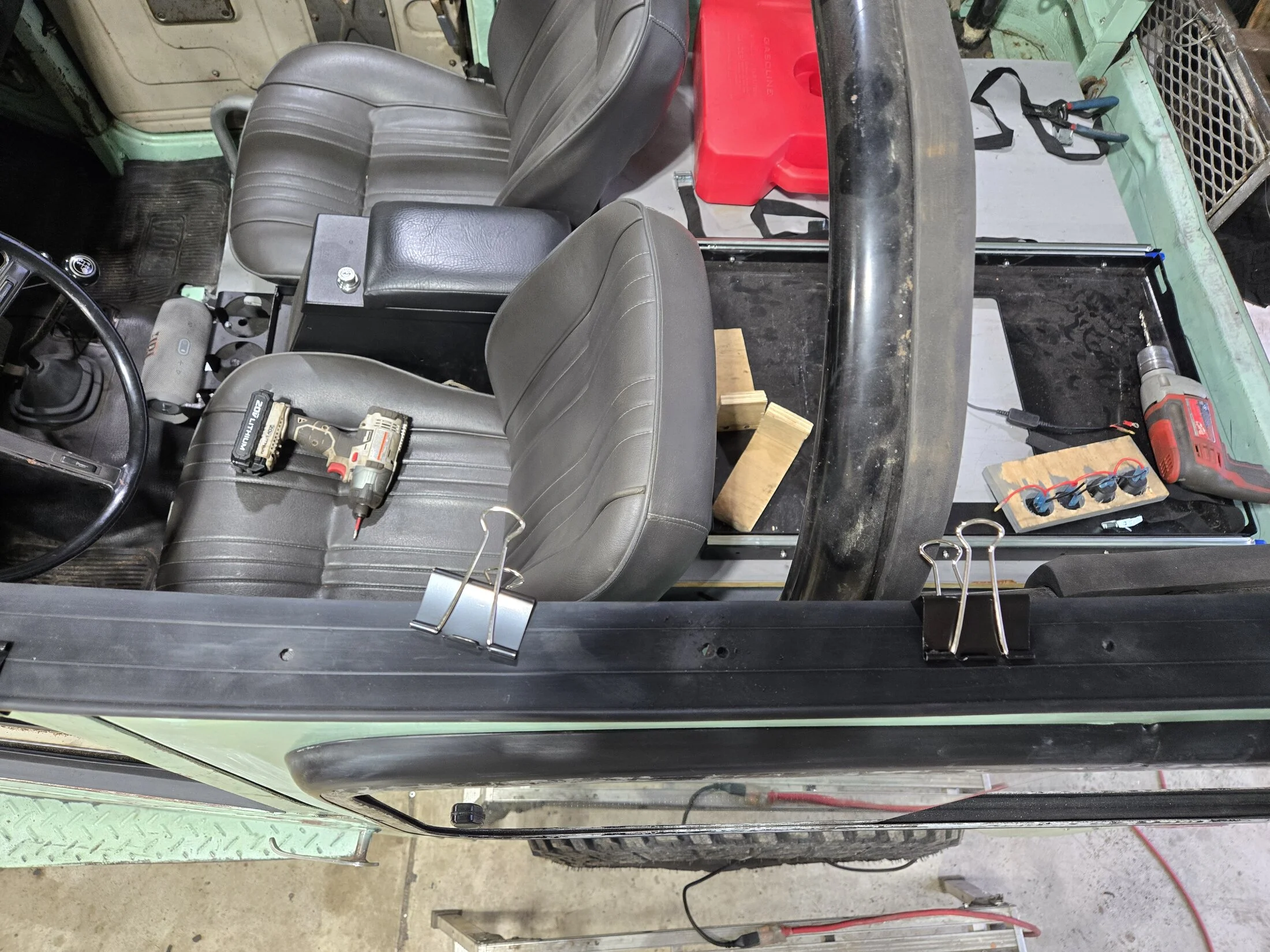

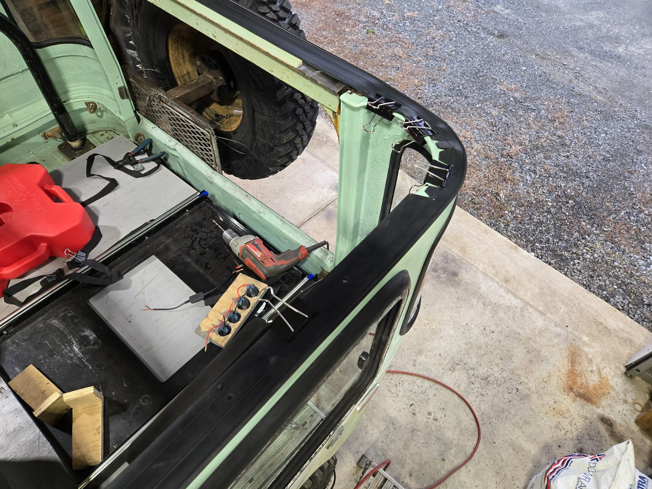

Today I installed a new top gasket and got the fiberglass lid somewhat on. I used binder clips to keep the gasket in place, then drilled the holes in it. Then I used zip ties to hold it in place while I lowered the lid into place. Cut one zip tie at a time and replaced it with a bolt. Then I pulled the whole top off because spring has sprung here. Got a few things to do to the top before it goes back on in a month or so.

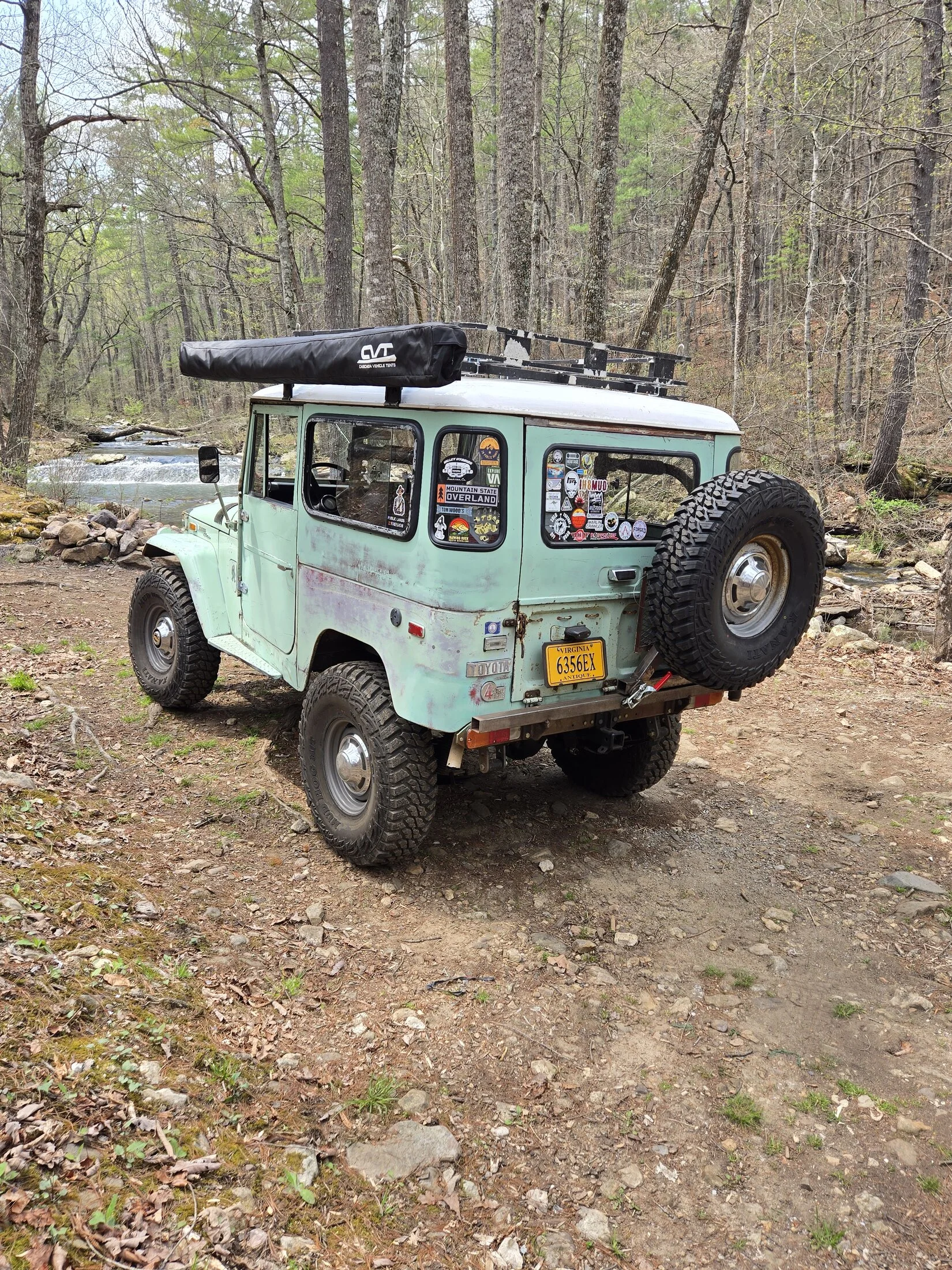

Added a yellow top Optima last week. Took it up into the mountains of WV today in search of some trout.
