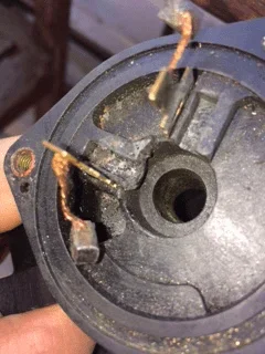

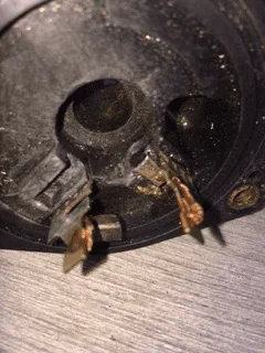

With little else to do I have continued the re-work on the CDL motor.
So have clean the brushes and the melted plastic, cleaned all metal and spring assemblies, made good o-ring seal and made a new breather pipe using an old metal ball pen ink tube.
Here are some pics.
plastic around brushes made them difficult to remove but with careful scraping and gentle pressure they popped out
Regards Chalky
Drilled the breather hole bigger to accept the new 3mm pen insert
