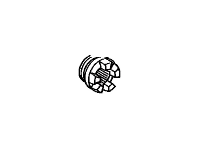

I was reading up and checking that I had aligned the diff lock motor gears using the very useful info on here. I could not remember when taking off the diff lock motor having to remove a nut from the "locking" spindle that goes into the diff. Anyway made sure motor was good and decided to fix back.
Got under the truck and sure what is not there?? no fork for fixing to the motor spindle and therefore no diff lock facility at all.
here is a pic of my motor ready to go in and a pic of the vacant space where there should have been a diff lock fork.
Well cant move the car and don't want to strip the diff myself so have put back motor and sensor.

studying the manuals and paperwork it looks like I am not just missing the fork from the locking mechanism i am missing the locking engagement ring thingamy jig/whadayacallit piece. Now this is going to be a real pain for me to get here. The fork is simple it is in stock with Toyota but the ring locking piece is not.:bang:

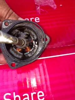

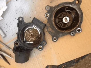

Ok plucked up courage to go for the Central Diff Lock motor.
Dropped the central diff with aid of jack. It did not come down as far as I thought so still a bit of a wiggle to get the CDL motor out.
So after getting into the unit and only breaking one screw bolt head off (so more corrective action needed) here are pics of what greeted me.
Ugly EH?!
So the good news is that the contact makers and breakers were ok.
The motor winding is burnt out and a consequence of that is that the plastic that partly mounts the brush holders has melted. This means the brushes are fixed in.
So I will be off to have motor rewound and brush holders repaired.

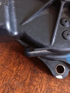

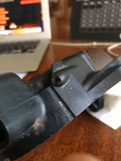

Now the real issue is that the breather connection pipe which is plastic is broken off so the breather pipe cannot connect. I'll have to figure out a fix for that. Here is a pic or two for you.
You can see the hole on top pic and the little area that looks like it is sticking out but it is not as it is moulded on the other side - otherwise it would be easy to re attach the breather pipe. No such luck.
Looks like I can drill the hole wider and insert/glue a tube so that it sticks out and I can re-attach the breather tube. was thinking that some old cleaned out ball pen ink tubing might work metal/plastic and will glue easily with super glue. Not sure yet.
