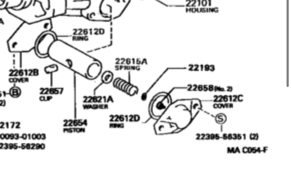

so im assuming you loaded up the 'outer' shims on the diagram

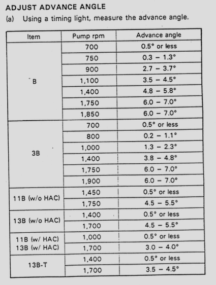

Have a look at this table, every degree of pump timing is two degree of crank rotation.
I'm quite certain that the indirect injection non turbo engines run the most timing advance. Mechanical cummins engines run no advance mechanism.
Yep, exactly what I have found. When you look into the way indirect injection actually works inside the cylinder it makes complete sense for them to run more timing than direct injection engines.
Advance angle is the change in timing. It's absolute timing you want to compare.

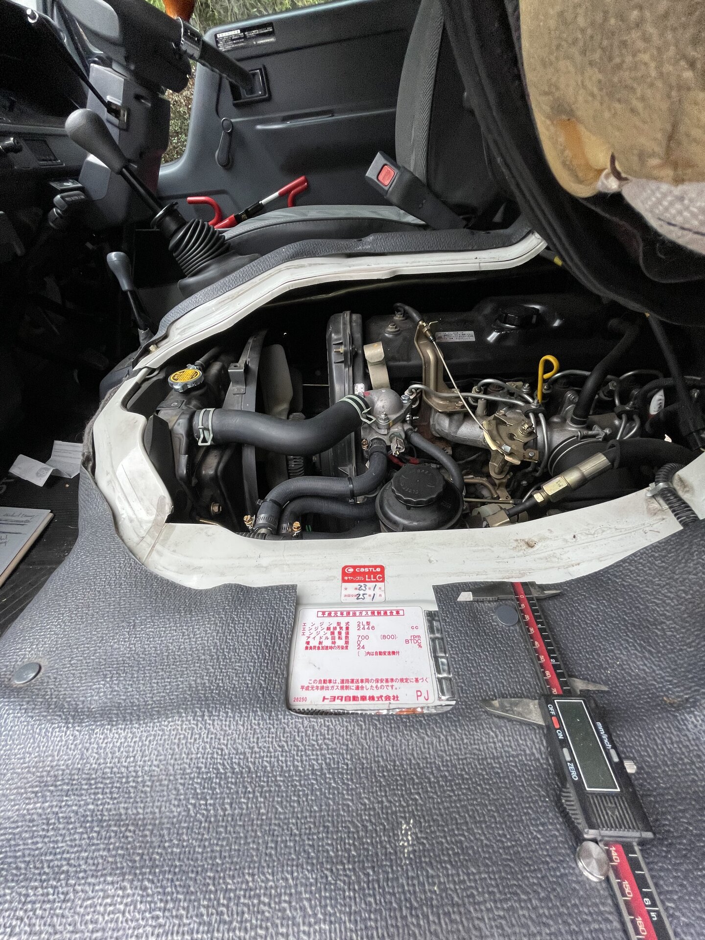

@Busted Crank I am just getting back to this project after some time off. Solid axle swapping this van is a challenge in it's own right. Do you happen to have part numbers for the timing advance gear shims? I verified today that I do have that gear on my van. Thanks!
I had a look and can’t find part numbers for them, but I can have a look when I get home and see if I can get dimensions from the ones I have
@Busted Crank that would be awesome. thanks!

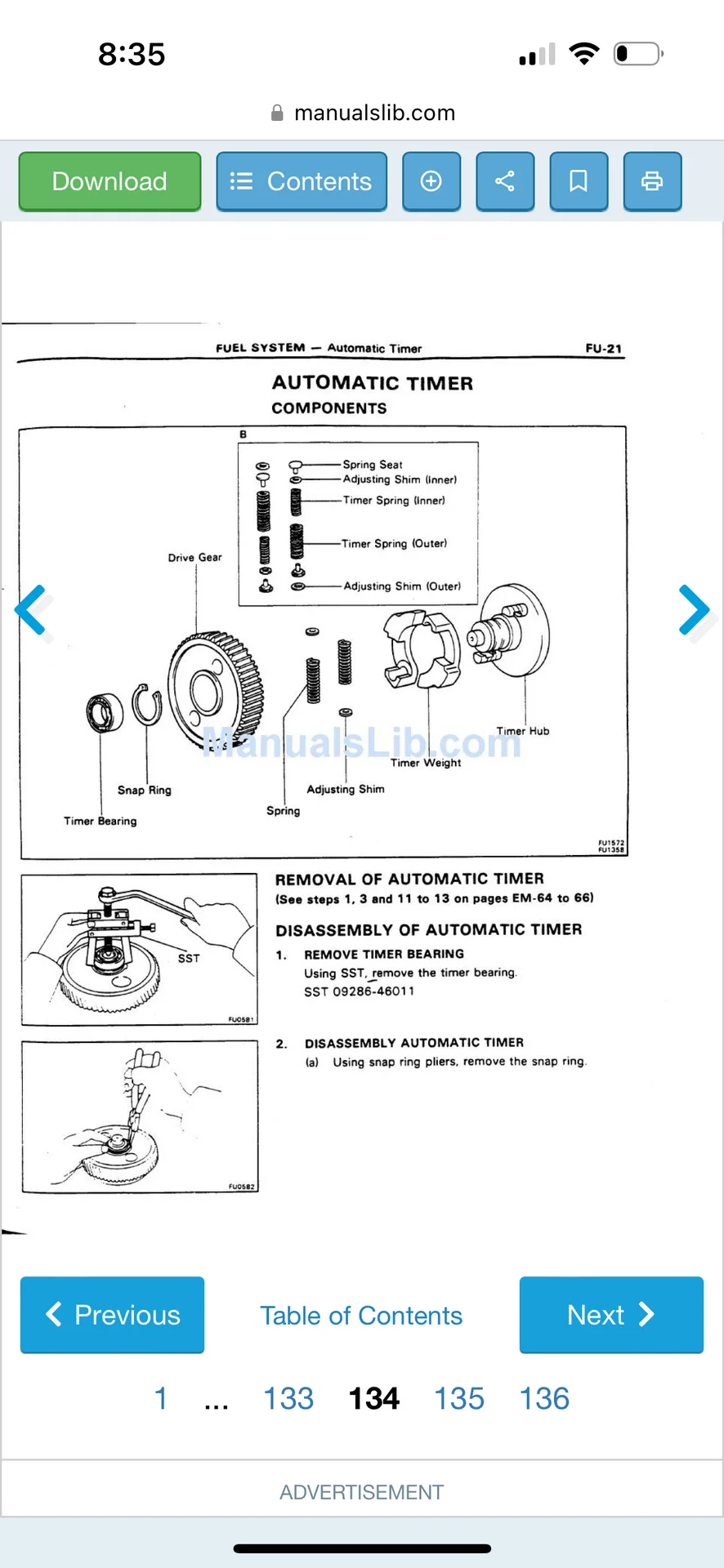

so I pulled apart the spare automatic timer I have and looks like I’ve taken all the washers out of it for my Motor. however, the dimensions that they need to be are 14 mm OD 8 mm ID and then varying thicknesses as per the manual of 0.1 mm 0.2 mm and 0.5 mm
Here’s some photos of just taking one apart. They’re not too hard. It’s all done by hand. Just need some pliers to remove the circlip and two pry bars to remove the bearing
Also included are the pages from the manual discussing the automatic timer
