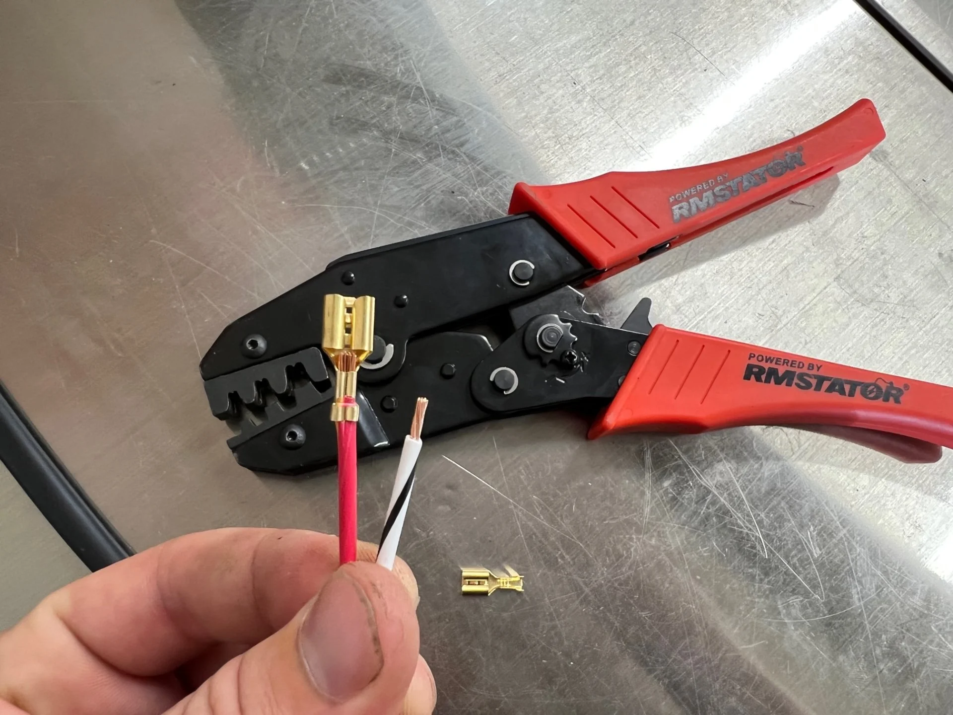

i run a heat and air company so leisure time is pretty absent during the summer for me. i did have some time to install a bikini topper and some fog lamps on my truck last week. for the fogs, i grabbed an oem switch for the dash. i got an awesome wiring harness from @Coolerman . it was a little long for my truck so i cut a little out of the middle. i also cut the bullet connectors off and swapped them for the waterproof connectors that came with a new set of KC daylighters. maybe someone can tell me if there is a better way, but i simply attached the wire harness spade connector to the back of the fuse box. i wasnt sure if that meant that is was fused or not, i dont think it is. so i added an inline fuse between the switch and the box.

Depending on what circuit added to the fuse block easy to tell if it infused or not. Pull all the fuses. Turn the key in the ignition to on. If you have power it's before the fuse. No power it is being fused at the fuse block.
Spades are not on a fuse but one is hot and one is switched 12
I knew one was hot, thanks for verification on fused or not. Good thing I threw in a fuse I suppose.
i assume the harness i got from mark is the same as the factory setup, which spade do the factory fogs run off?
Most people run aux lights off switched 12 so you don’t forget to turn them off
Gotcha. I ran my radio off the switched. I figured I would see a set of lights left on more than I would remember a radio if the volume was low. I may end up running a secondary fuse block.
