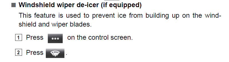

Happy to have this thread remind me we have windshield wiper de-icers. First time to use it, but it was snowing and -22F, very nice to have.
Speaking of, how can one tell if a windshield is equipped with this function? I had the windshield replaced a couple months ago but don't know if it included this feature. Can you see the wiring in the windshield? Does the hood need to be open to see it?
This is on a 2009 LX.
My 2013 is equipped with the deicer but as far as I can tell it doesn’t work. Light stays on but the glass is cold to the touch.
My controller was replaced 3x while it was under warranty. Each time it lasted 3-4 months. Mine hasn’t worked in years. I would guess your likely dosn’t heat.
