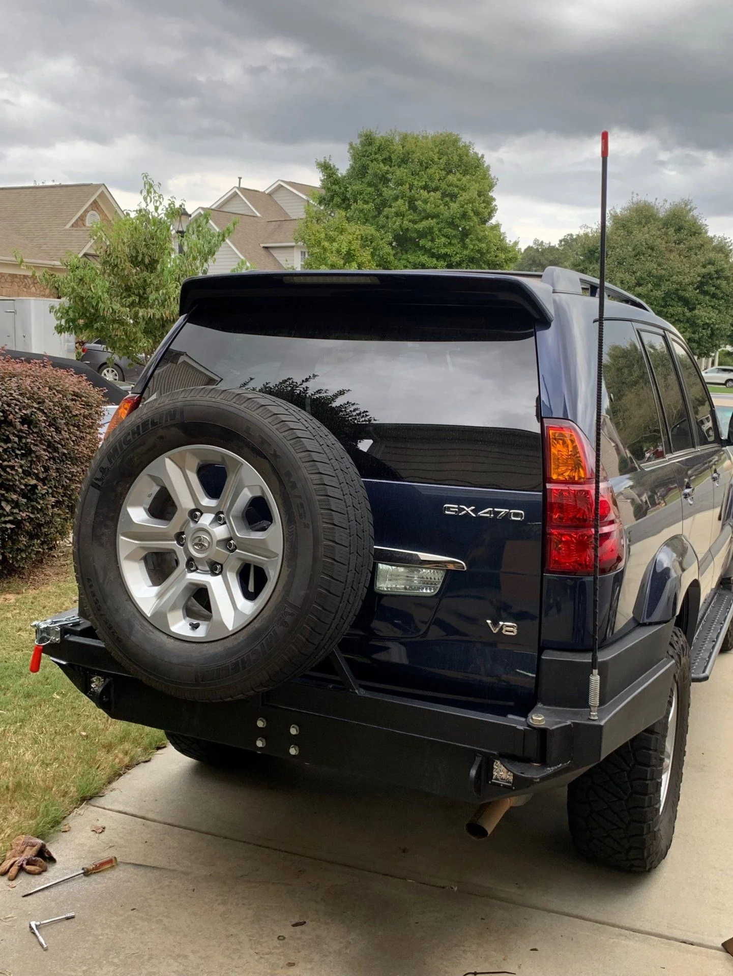

This is what I did using some 14ga steel I had laying around. Steel Bumper Cap
I have only towed around 1200# with mine so not much of a test.

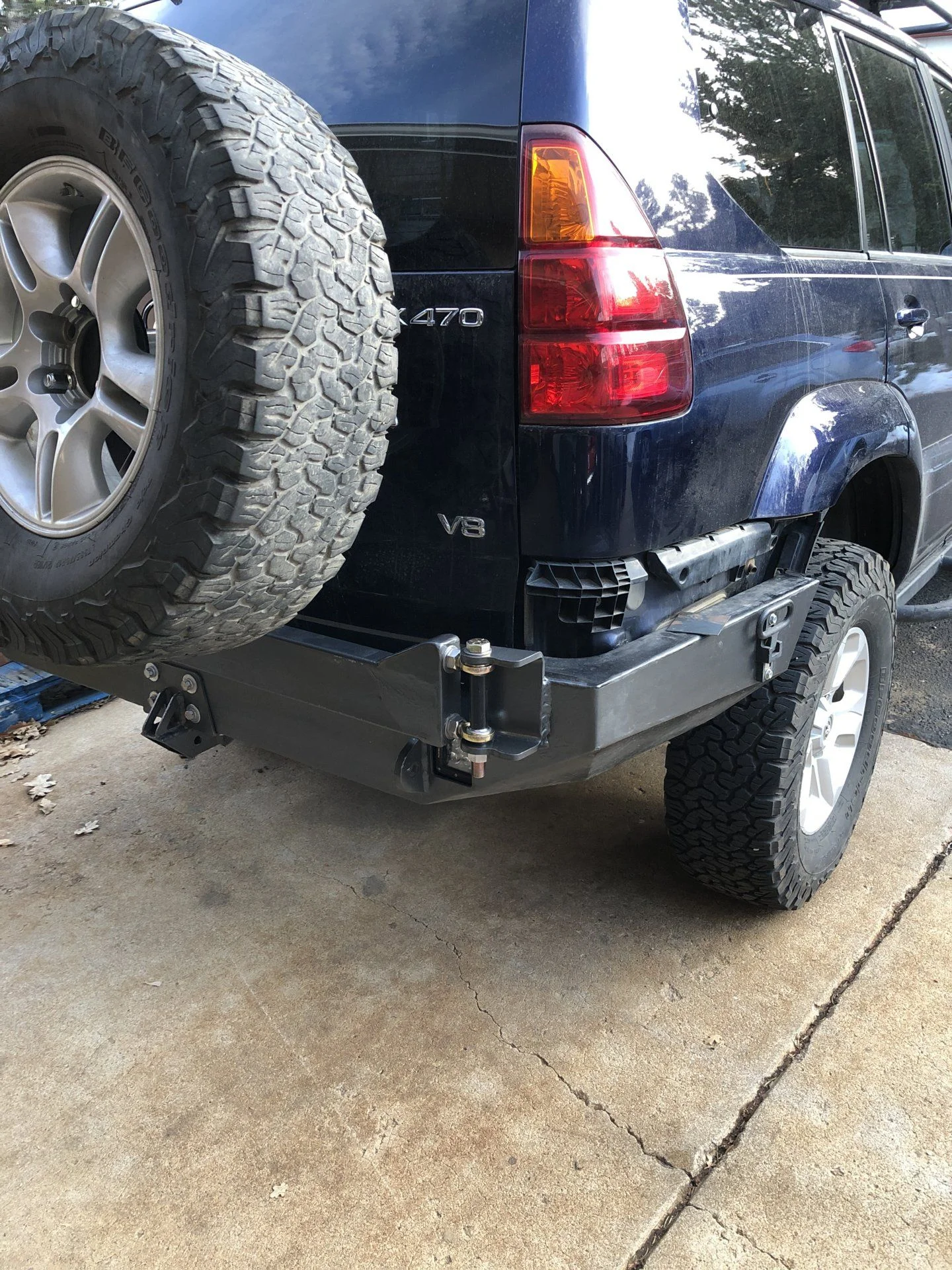

I have more detail in my build thread but thought I would put here what the new CO hinge looks like. Much beffier than there original design including 3/8” steel.
Sorry, I hope you don't think the tire carrier is CO's, it is my creation.
To clarify, I was only posting in comparison to what CO had for their original design. I had a problem with long arm having loaded a tire plus two full Jerry cans.
My comments were not intended to compare against what others did for their custom swimgarms.

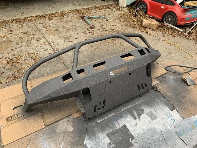

bumping this up. Final stages of getting my bumper done. Quite the process. I’m trying to figure out what winches fit in this thing. I bought a Badlands apex 12k. Didn‘t realize how huge that thing is (that’s what she said). I think I need to return it and get something smaller. Anybody out there have any recommendations. I’m thinking another Badlands but open to others.
I have a Smittybilt 10k on mine. it was tight due to the control box but that can be mounted elsewhere if you want. I had to notch the top of the bumper to clear the control box but it isnt visible with the hood down.
We had a Coastal Front Bumper. Yes, it is a very tight fit. I think we had to shim up or, shave off a little on the front.
