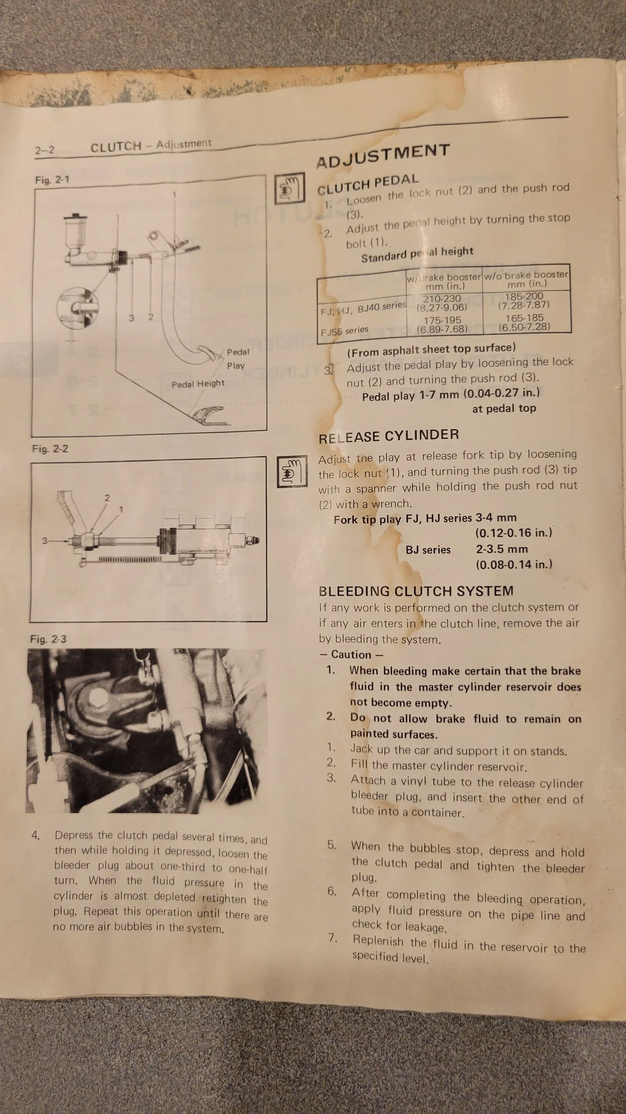

Below is the clutch adjustment from the FSM. When it talks about pedal freeplay is when the slave initially starts to move.
