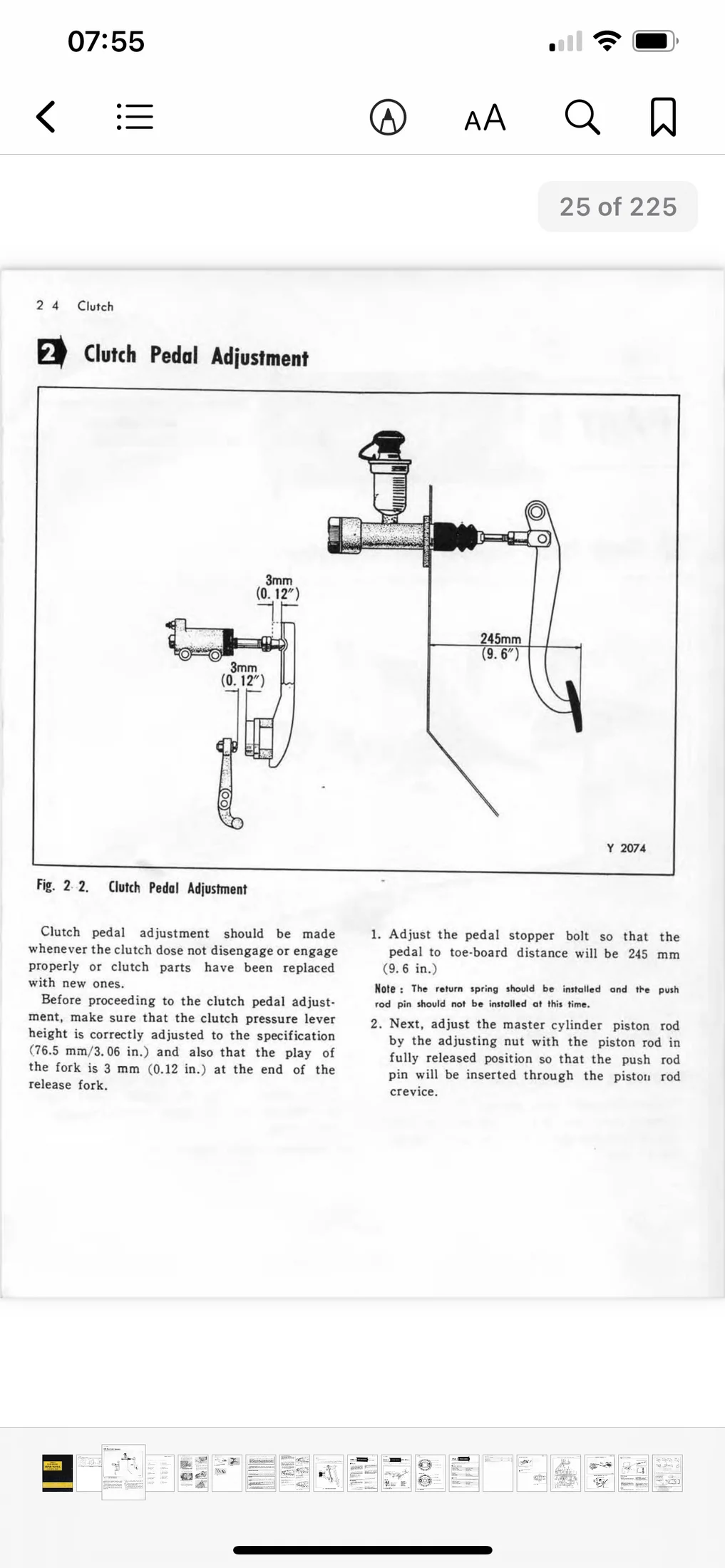

Looks like there's a wear ring on the shaft right by the hole that needs dressing off.
Can you back-off the slave (or just remove it) and then push / tap the arm gently towards the fully engaged position, then inspect again.
The bearing should pull away slightly
Yes, I will try that. Thank you!
Closing this thread.
I'm going to, in deep humility, close this thread. Turns out, this ordeal was completely a ROOKIE MISTAKE. Yes, I admit it, I did not do a thorough item by item diagnosis, which resulted in a trip down the rabbit hole that had no rabbit. Had I just continued to adjust the slave push rod inward to begin with, I'd not be in this humbling position.
