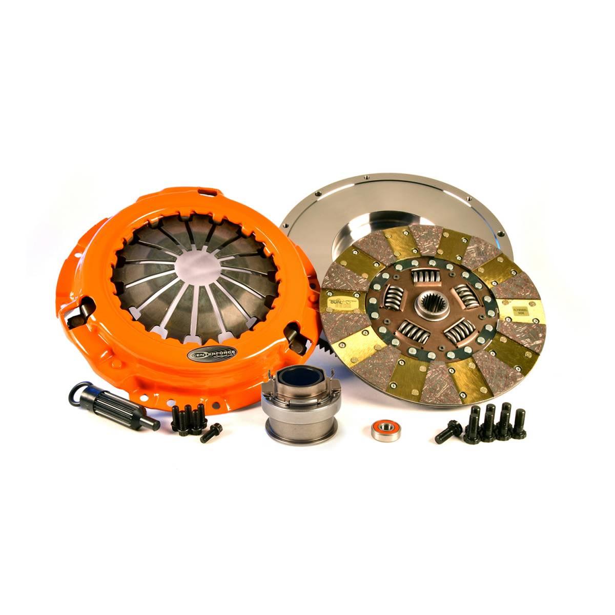

Looking at possible just ordering a replacement kit and having it installed what kits would you guys recommend? I keep seeing this one as highly rated but I have no experience with it.
Centerforce Dual Friction Clutch Kits KDF409540​
