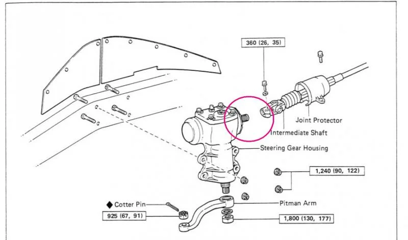

Is this where you add grease

Is this where you add grease for the shaft (red circle)?

In regard to the diagram posted previously, the area circled in red is not where you put the grease. The steering shaft (perhaps called a stab by some) has a sliding splined joint. It is a male/female sort of thing that allows the length of the shaft to change. Probably helpful in a collision by keeping the steering wheel out of your face. That splined joint is what could stand some grease.
What is the steering stab?
The stabilizer.
